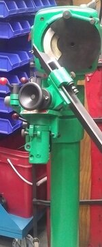

I tried a friend's DD. I did not like the results, so I bought a used STERLING and restored it. Parts are available and customer support is really good. My sterling was made in 1968. My Sterling works perfectly on 1/8″ to 2-1/2″ Diameter Drills. The weight is 345 lbs
The Sterling has changed very little since 1939, the year of the first design change. The origins date back about 100 years.
If a person goes for a new Sterling, be prepared to lay out $4500usd. I have spent less than $600cdn on the original purchase and restoration which included a few new parts.
http://www.sterlingdrillgrinder.com/index.html
