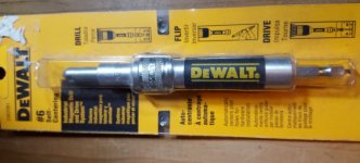

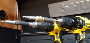

If I'm doing hinges or anything where I need to center the pilot hole to put a screw in a bracket or whatnot I use one of these self centering flip drill and drive's. The spring-loaded guide centers the drill bit in the hinge hole and then I flip it around and screw it in. Once I get one screw so the hinge or strike plate etc is held in place in I flip it and drill all the other pilot holes, flip it again and set all the screws.
Makes quick work of hanging a door or installing a door knob and strike plate, etc where getting the screws centered is kinda critical. I have several of them in various sizes for different size hinge/bracket holes & screws from several different brands incl Dewalt, Montana, Makita, etc.
If I'm drilling 3/4" holes with a paddle bit or driving lag screws or building a deck, then yeah, an impact is the tool I grab, but for sinking typical wood screws in projects or most small home repairs I much prefer a drill. A wee bit of common sense to set the clutch correctly and use the correct bit for what you're doing and never strip a screw or sink one too deep.

that's a cool gadget. variation on the old vix bit, looks like.
