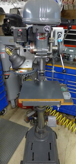

I'm looking for a drill press light. Would like to have 360' lighting of the work space without having to have long goose necks dangling in the way. Maybe something along the lines of this... possibly adjustable brightness. Open to ideas or other suggestions.

You can buy led ring lights in almost any diameter on ebay for cheap. Dimensions called out in millimeters, typically. I bought an appropriate power supply and
put it inside the head of the drill press and wired it in with the existing lamp. I glued small rare earth magnets (Dollar store) on the back of the light to hold it around the bottom of the quill.
This was cheaper than a made-for-the -purpose light.

My Craftsman 100 had lots of open space in the middle of the main drill press casting in front of the column and behind the quill. As such, I used this internal space to mount a LED bulb on a flexible arm. The light is hard-wired with a switch and controlled independently of the drill motor. The light is completely out of the way and can be adjusted if needed. It provides plenty of light directly onto the drill table.
Here are some pics:
Here it is lit up:

I have one of these on my mill. I made small brackets and mounted it directly to the body of the mill head instead of the quill like shown in the pic. It does a good job of giving light to the area but does leave a shadow directly under the quill.

That's similar to my Craftsman floor model but the light was built in with a plastic lens covering it. Replaced the bulb with a 5000k LED and it is awesome.

I made an LED ring light from a cheap headlight ring off ebay. I used an old computer power cord that stepped down the voltage. Very simple and cheap to make. It is the best upgrade you can make. It is VERY bright and there are no shadows.

I have a floor standing version of this press, soon to be rebuilt. I’ve been wondering how to get shadow-free light onto the workpiece. This looks brilliant, and I’m going to steal it. Thanks!
