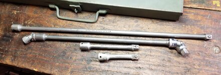

I have been in situations where a universal joint on an extension with a socket ended up being too tall and nothing else would work other than an extension with a single built-in universal joint. Not an everyday occurrence of course.
With that said, I do have a small collection of extensions with a single universal joint on one end. When I ran into the need, I decided to get a few. Less height, less slop relative to the extension + universal joint.
Now the dual universal joint extension is an oddity, I don't have one nor do I intend to buy one. But they did catch my curiosity.
And to your original question, "...the same exact tool can be assembled with two knuckle joints and an extension of any length you want..."...it's important to note that the extension and universal joints do not yield the same exact tool. Similar, yes, but not exact. Even an extension with a single universal does not get the same exact tool as an extension with a built-in extension.
