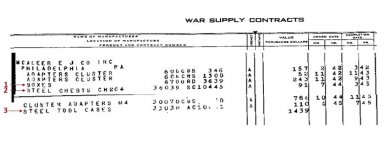

LS,
Nice box.
E.J. McAleer is one of three verified suppliers of that type of box (FSN 41-B-1840) during WWII. The other two are Hamilton Metal Products and Union.
Hamilton and McAleer are prized because they are branded. Union's are very easy to spot, too, because of the way they attached the handles to the lids.
McAleer had contracts with the US Army Ordnance Dept (see item 1), the US Army Signal Corps (see item 2), and the US Army Air Corps (see item 3). The chest they were supplying to the Signal Corps was the same box. I have seen other examples, and they usually have a Signal Corps data plate. I am not positive, but I suspect the Air Corps box was buying the same box. Let me put it this way, I have never seen the E.J. McAleer name on any other kind of toolbox.
