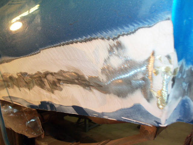

All these years I've made do with a small parts washer and a baby-wash bin (you can see it in the background) for washing parts....finally cracked the safe and bought a biggie...
It'll come in handy with these lined up:
But let get back to the project at hand first (finally!):
The old bondo was thick enough to use an air chisel!
...along with some clean-up with the grinder:
Found underneath, holes from a slide hammer repair:
Had to do some fancy hammer and dolly (and widget and vice grip) work to get the wrinkles out of the inner fender and get the floor to look stock again:
Scraped out a ton of undercoat they used to to and hide the wrinkles left after the "repair"....
There was a lot of surface rust under all that undercoating, so O ground most of off, then treated it with MetalReady:

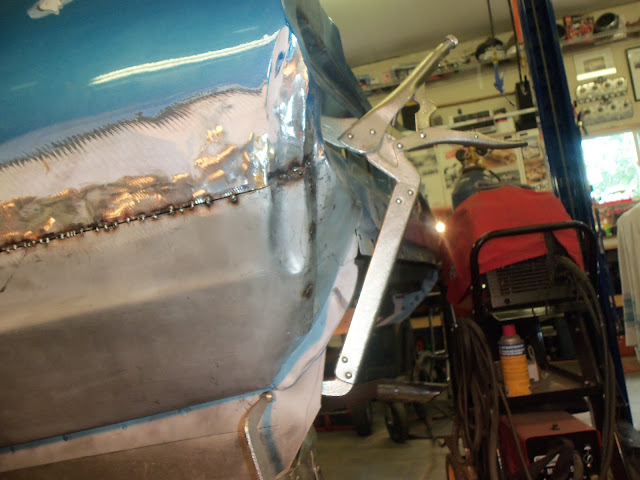

Time for some catch-up...
Started by fitting up the trunk drop-off:
Then the outer (the screws go in the portion that will be cut out prior to welding):
Here you can see that the lines along the wheel opening arch don't match up. Once confirming the patch is in the right place (in addition to using the metal around the patch and the rear filler panel, I measured from body lines vs the other side, measured up from the floor, then confirmed it all by eye from behind) I could see where the line should be. I rolled it in along that line with the hammer and dolly to match the width further up.
Once it's all set up, I ran my cut off wheel down the top of the patch panel - which will give me the right gap for a **** weld:
The holes from the screws got cut out here:
In checking the wheel arch with the ruler I saw it needed some tweeking before welding in the patch. In many shops this would just be filled.
Getting there...
Now instead of the screws, I used panel clamps, these ones from Eastwood.
Also had to fab up a few pieces that didn't come with the patches...
The one at top right is done, with spot-weld holes drilled, The other is for the wheel well, just starting:
I always re-install any panels that attach to the part I'm making/repairing. Body lines, holes and welds must all line up before welding it solid:
First pass ground. The drop off was trimmed once, needs to be trimmed even with the outer panel once welded in:
From the inside. Once I final weld and grind it'll take very little filler to make the repair disappear:
A good start - you can see the crease from the previous damage more than the weld line. A bunch of hammer and dolly work will get it all smoothed out and minimize any filling.

You're absolutely right Robert - you obviously have an experienced eye. Part of it was that the area where the wheel arch meets the patch panel was still pushed in and just filled. As you would know - but for those reading - the patch panel came off several times to repair the areas that didn't fit and in this instance, the original area was rolled out and the patch was rolled in to give that gentle contour through the area.
Of course, some shaping is sometimes best done AFTER the patch is welded in - working the entire area with hammer, dolly, slap file, etc both during and after the welding process.

First off - the only stoopid questions are the ones that don't get asked!
Reason you DO want a gap is that the metal always moves and expands a bit with welding. If you actually had them **** right up against each other you'll find they can buckle and warp above and/or below the weld. Another thing I like to do to alleviate this issue is to put several tack welds at that seam before doing any plug welding at the other ends (wheel well and bottom), so that any movement can occur without constriction.
Of course you need to find the really thin cut off wheels because you are partly correct - you don't want to have to fill in huge gaps with weld either - but for no other reason than it's difficult and can end up messy! The panel clamps I'm using give about a 1/32" gap.

The Cougar has been in a major rear-ender at some point in it life, where the end panel was replaces and the quarters where buckled. From the outside, the repairs were well-hidden and it looked OK with all the parts on. Once it was taken apart for restoration however, there are a lot of signs of a poor initial repair - or shaky foundations if you will. This leads to rust issues (slide hammer holes, welds holes left open), fitment issues (panel overlap, changing gaps, thick filler) and more.
Below, you can see how the end panel had been replaced and didn't quite line up. As well, the welds had been drilled or broken loose and then not re-welded. The entire panel was tacked on with fewer than 6 welds.
Here are some of the many slide-hammer holes that were filled over with filler. This can allow moisture to enter from the backside and allows rust to start behind the filler.
The trunk floor was still pushed up against the wheel well, which would mean that somewhere between here and the end panel was shorter than it should be.....somewhere.
The filler was thick enough in places I could use the air chisel to remove it. Like doing sculpture work. Behind this chunk were 5 or 6 slide hammer holes, again only filled by filler.....

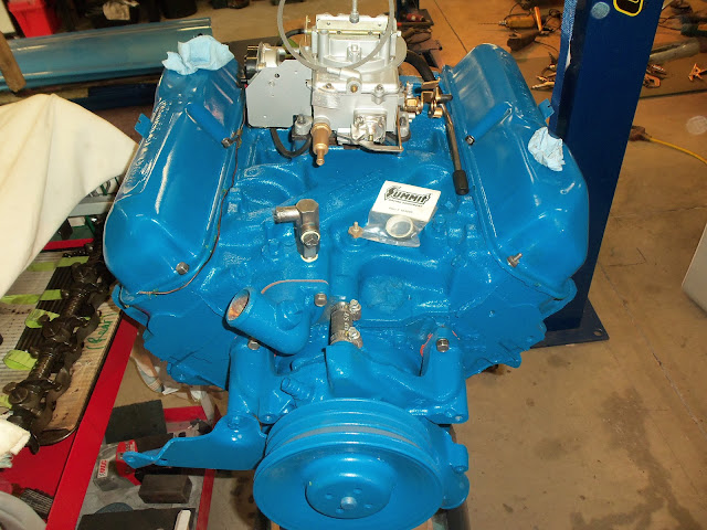

First, the 331 I'm rebuilding - before:
Looking much better now.

Finished up the lower inner piece:
After setting and fitting the inner drop-off, I tacked on the outer patch panel:
Sometimes you need the looong grips!
Plug welding the edges:
First round of grinding, followed by some planishing. Due to the previous damage it looks like I'll need to put a few torch-shrinks in to tighten up some of the high spots:
You can sorta see the high and low spots from the inside:
I'll remove some more of the old filler from the quarter so I can see where the old damage is holding the metal up, but I don't really want to remove it to the top of the quarter, as it's in decent shape....and that'd just make a lot more work where it's not really required. In cases like this you have to strike a balance between finishing the new repairs so as not to require a half inch of filler, but still having to blend the new repair into the old filler....
***Here's where I'd like to hear what you do Robert! ****

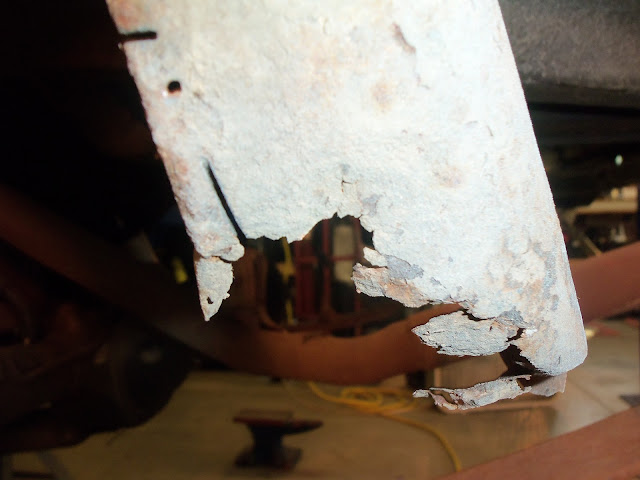

After a few hours of that, I took a quick break to apply more pentrating fluids to the head studs on the early FH block. You can see I have a torque wrench on the stud puller so that I don't exceed the breaking point (apparently 65-75 ft-lbs) of the studs when twisting them out.
