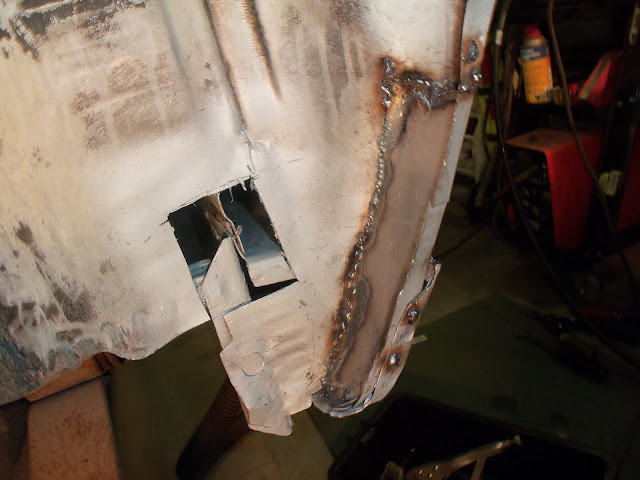

Continuing on, I made these pieces and applied Zinc.
As well as the edges to be welded to:
This is the inside of the above area:
Which needed cleaning and undercoat removed. Best tool I've found yet to remove undercoating is this oscillating multi-tool. Works like a charm!
Welding in the pieces:
This is one of those hidden pieces. It's the end cap on the rocker....
Then this piece is from the inner half of the wheel well, which goes over top:
This is how picky I try to be: I could see by looking at the left side that the next piece should look like it's overlapping the inner piece with no weld at the edge. It was was spot welded at the factory, so I'll do the same:

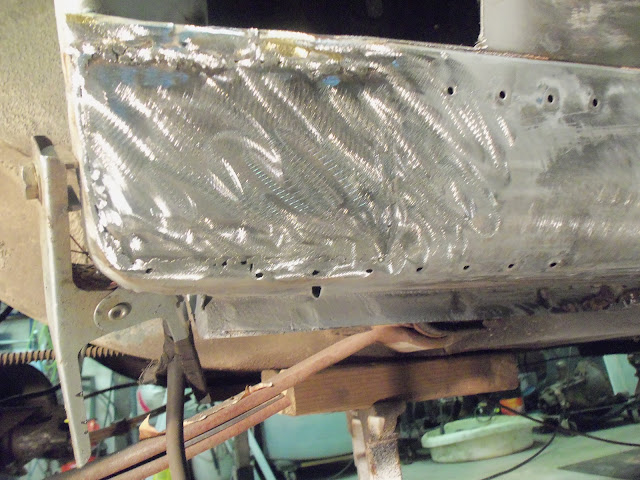

Outer rocker patch welded and dressed:
Now the more difficult part - the wheel arch and quarter patch I cut out:
Trim and shape...
I decided to make the lip separately, then weld them together, so that I wouldn't need to pie-cut it to form the arch:
Looks like it might work - with a lot of work!
Lastly for today, I welded up all the old slide-hammer holes.
Tomorrow I'll begin planishing them, as well as the quarter, with the air hammer and this bit that I made. I want to smooth it all out so as not to require as much filler as was there previously.

New Left side - new flanges take up space that was previously missing/filled, removes major damage that was filled, strengthens corner that was still broken, cracked and brazed
And here's how it looks after some initial metalwork. I'll continue to work it until it needs very little filler (just enough to block it out)
