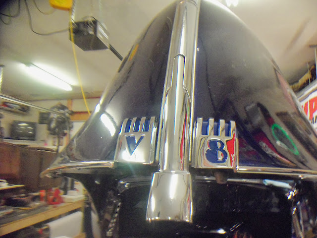

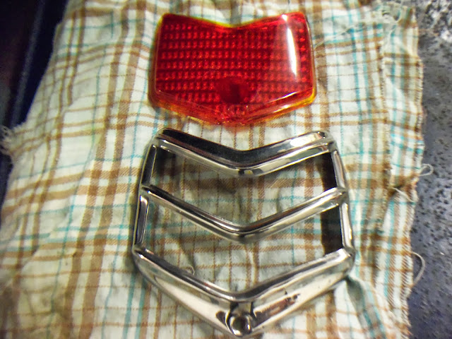

Remember the taillights that needed to be retrofitted for turn and brake signals? Turns out it was rather simple:
I was able to punch the old insert out, make the hole a touch tighter and then squeeze the new one in -
This chrome surround was not in great shape but was easily repaired with some light hammer work and the polisher -
Next up will be the re-assembly of the front end...

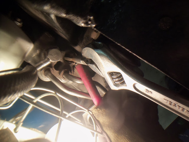

After repairing the power steering hose steel line, which just involved opening up the kinked tube by pressing it out in the vice - a fairly easy operation - I was greeted with one of those frustrating scenarios when I went to re-install it... finding that the threads to accept the PS hose' threaded end were burred in the rack! Argh!!
So, after struggling to seat the threads for what seemed like forever, out came my NEW MasterCraft Titanium-coated tap and die set....purchased a few months back to replace my original set that was so well-used it was missing too many pieces and the ones that were still in it were definitely worse for wear...
To keep the shavings out of the rack, I kept a magnet attached to the tap at all times:
Before tackling any major work, I often do some online research (Thanks InterWeb!) to see if there are any tips or tricks that may help. Turns out guys have been sharing several older articles from StreetRodder Magazine, including the 2 below, that address several of the issues on the '40 Ford front end.

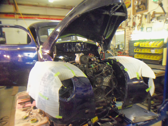

With all that taken care of, it was finally time to begin the front end re-assembly, but - as always - adding one more level of difficulty: doing it solo :thumbup:
First, the cowl to hood seal went on with the supplied screws, making sure to find the center point first -
Then I built a foundation to place the hood on that would get it close to it's attachment points, using blocks, layers of hard-insulation and sheets to protect everything underneath.
Then I attached the sheet to specific points, as well as the rubber backers for the hood hinge plates, with masking tape -
And now - for the Piece de Resistance!!
Installing hood - utilizing the entire staff of E-tek Restorations
After securing the hinges to the cowl and getting it lined up real good, I was about to continue on with the fenders, but this is what greeted me when I opened the bags of carriage bolts that are supposed to match the inner fenders:
So while those where being painted I got everything ready to tackle the fenders tomorrow.

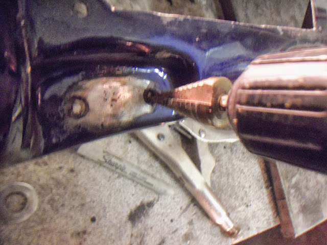

Fender washers - both steel and rubber are required and my stock of rubber washers was about done. Took me going to three stores before I found suitable rubber washers (at Bolt Warehouse) -
Making up more welting -
Apparently these panels came with captured nuts from some suppliers....but these ones didn't. And since it's already painted, I did the next best thing, which was taping nuts over the holes so I could insert bolts from the other side without too much trouble.

Hood and Fenders....
These are the brackets I made waaay back... Rubber washers on everything.
Inner fenders -
A ton of work just to get the hood half-way aligned...
Starting to look like something now ~ Check out that shine!
The welting is killing me....lol!
Check out my new JUMBO step drill bit!
Arrrrrr!

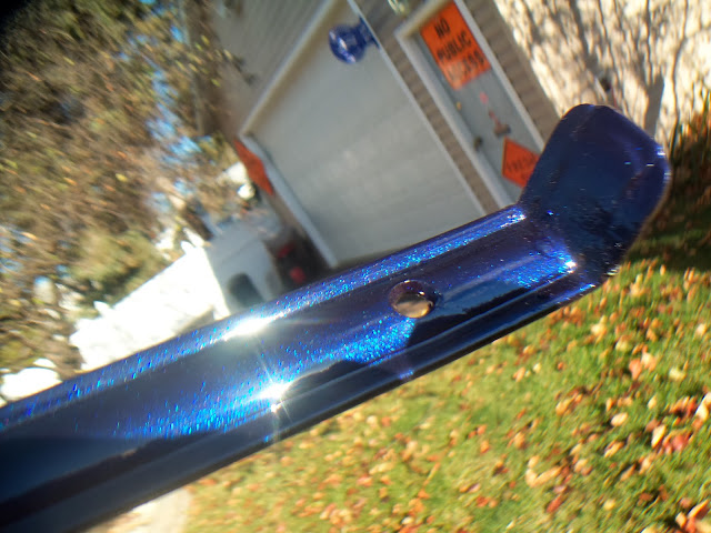

How NOT to bump fresh paint....
Putting together the BLING! :pimpflash

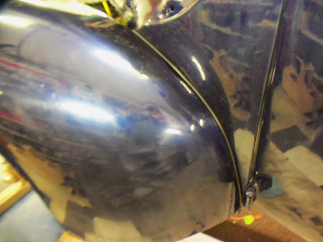

In 30+ years doing of performing body work, I've learned that most front end structures have their hidden idiosyncrasies - but the 40 Ford is one of those cars infamous for being out of whack, right from the factory. It certainly doesn't help having a support structure that bucks your efforts at every turn, a front frame and suspension that are swapped out for an IFS system, fenders that were bent and then re-shaped, originals, a grille well-known for fitment issues and a hood that rides on giant rubber stoppers....So follow along as I continue with the rebuild of the iconic 40 Ford.

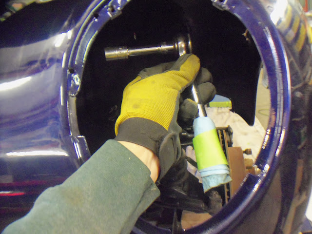

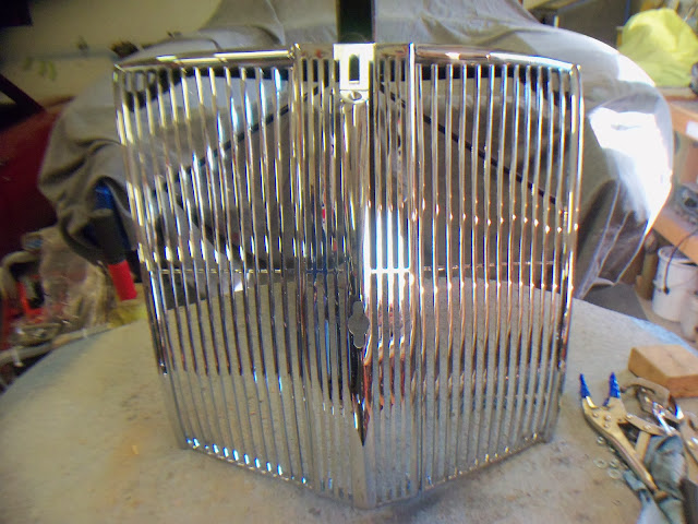

In the reading I did, one of the tips was to completely asssemble the grille in order to get the front opening into the correct shape.
This didn't look like that when I assembled it the first time!
Taped the welting to the body so it'd be in place and to protect the paint -
Check the paint on that mo-fo fender!!
My Dad taught me to always use protection!!

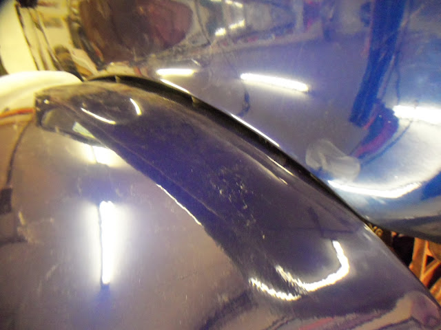

Here is one of several major WTF's due entirely to the supplied hood seals and bumpers...why would the hood to fender bumpers be of different sizes? I know this is the case from several posts and an email from other builders that said how they shaved the bumpers to even them out....
Here's another WTF - the hood to cowl gap was PERFECT in the pre-build! With the seal, the left side is WAY out. I've read others have used vaseline to get it to slide easily into position whenever it is closed...
Which of course Fucks up the entire gap...on this side...
The other side is still perfect.....luckily?

The grille and front end is coming together - despite some struggles to get things lined up! It's to be expected of course, as a ton of change has occurred to this ride, including new cowl sides welded in a dozen years ago and an IFS front frame clip and suspension. As well, a lot of body work was done on the fenders after I had mocked up the front end - just due to the way things happened. Regardless, it's gotta be done and it's gotta be done right!
As good as it looks here, it was quite a task! There's still some more work to do, but at least I got it in the ball park....
