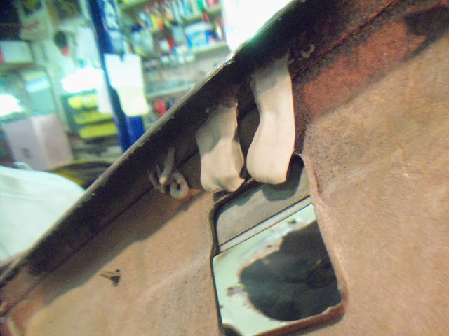

Oddly, someone decided to silicone (?!) the door seal runners to the body - when screws have done the job in every other Camaro ever built. Did they run out of screws?Are the screw holes too big (stripped)? Where they just stupid? ;)
Once I finsihed taking out enough to remove and replace the quarter, I got busy changing out the door and hinges:

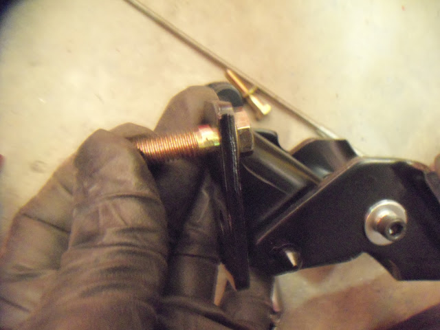

Here's something interesting. The hinges where all installed with Grade8 bolts - which is overkill - but check out the shoulder on them.
The shoulder is so long that once the bolt is tightened all the way through the hinges, it would have likely come in contact with the thread block inside the post, decreasing it's clamping force. The threaded portion is also too long. It's a wonder the doors didn't sag even more than they already were.
I replaced them with correct body bolts:
A trick I learned - the hard way - is to make sure you always keep a bolt in the thread block so it doesn't fall down and out of reach when replacing hinges and such:
Off with the old:
On with the new:

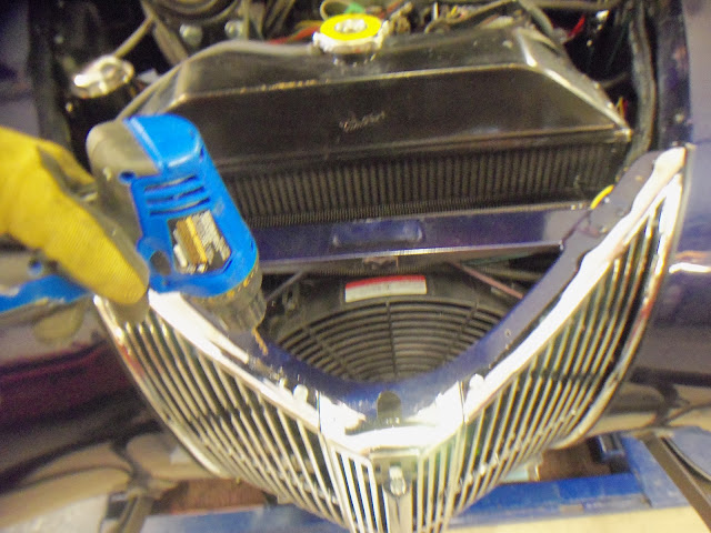

More bling!
The kit included two allen wrenches - both the wrong size!
What do you guys think?
it's hard to see in the photo, but the front end has under "underbite" and is off-centre a hair. After a LOT of measuring and jiggling, I'm thinking it may need a pull...
Forgot to run the hidden antennae when I did the hands-free wiring...
Then finally, put the trunk weather seal on it:
Not sure if I should cut the corners so they'll sit down....would hate to cause a leak...

Took some fanagaling to remove the sheet metal from the striker support welded in behind it:
But off it came!
Once more I find nearly 1/2" of filler where it shouldn't be...
