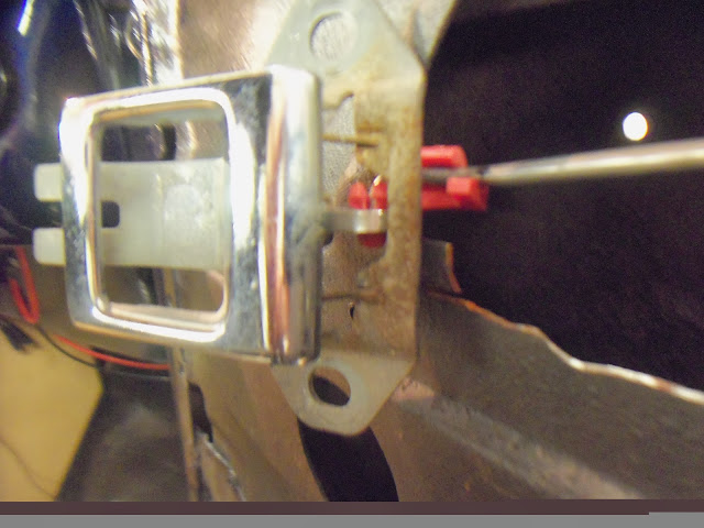

Now, onto the 40Ford, where I buttoned up a few more little items, like mounting the MAF sensor:
Tidying up some more wiring (although - as you can see - I have left much of it uncovered until the car goes through everyone's hands and it's running as it should):
A little ways back in the thread I mentioned that I repaired this bezel. The photo I posted was actually a before shot - and between that and this - it was bent, hammered, filed, then sanded with 120, 240, 320, 600 then 1500, before buffing it out again - to get back to this point:
The repaired area was to the right of the mounting screw:

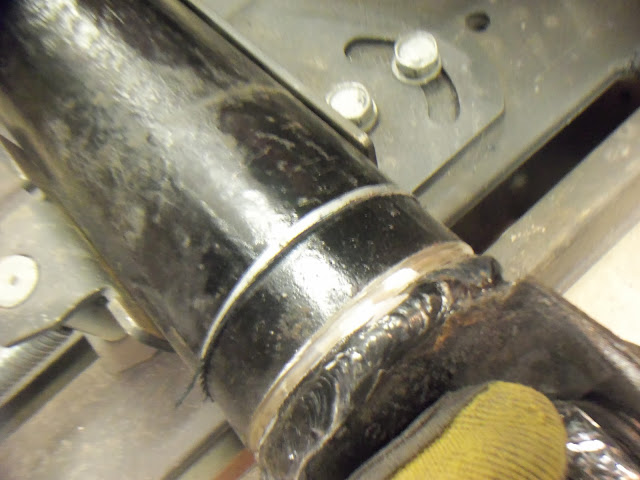

THEN, I tackled the driveshaft, but first, I threw together a couple stands to make the job a little easier - and much more accurate:
Lumpy, but it holds!
The stands make it easy to keep items like drive shafts left and square in various instances:
The key to cutting a drive shaft is to try and keep everything square as you go, so you don't have to do a lot of squaring at the end:
Driveshafts all have an insert on the one end that you want to be sure NOT to damage. What I did was score the weld first by turning the shaft in the chop saw, then cutting it at the actual cut line:
By cutting the remaining tube piece with the hacksaw, I was able to remove it easily:
The tubes end was fine-tuned several times before tacking it on:
A pair of Vice Grips made a good welding ground point:
But I couldn't roate it freely, so I switched to a magnet:
After some final checking (forgot to snaps photo's), it was ready to bolt back in:
Pretty much exactly where I wanted it!

Another item on my list of "do it last", was to open up a hole on one of the bumper brackets that was too small to insert a bumper bolt into. The hardened steel stopped me several months back and now I have to get it done. This time I stepped up the drill bits one at a time to slowly open the hole, then used a shaping rock to finish it out:
Took about 30 minutes to oepn it up just enough to put the bolt through:
To get the bolt head straight, I used a 15/16" wrench on the oblong head, wrapped in shop towel:
Finally!

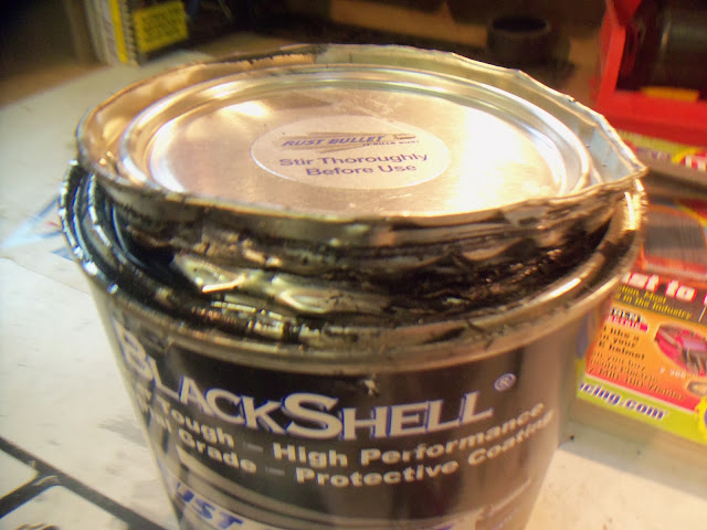

If you've been reading along, you'll recall that the good people at RustBullet sent me some of their product to test and review, which I did, by brushing it on and describing that process, but I yet to have any long-term experience with it - until now.
I'm going to call this the "welding the lid closed" property. The product dries so strong and sticks to bare metal so well, that it virtually welded the lid to the can. To me, this is a good indication that it will stick to whatever it is applied to, so long as it's clean.
I hammered the can back into shape and punctured a hole in the top to allow me to pour out what I needed - a well-known procedure used with these types of products:
After pouring out what I needed, I resealed the can with some duct tape:
Finally, I was able to brush the brakes, rotor hats and some of the suspension parts:

When I did the door latches, I broke one of the plastic rod clips. The clip was purchased a while back and today I crossed it off the to-do list:
