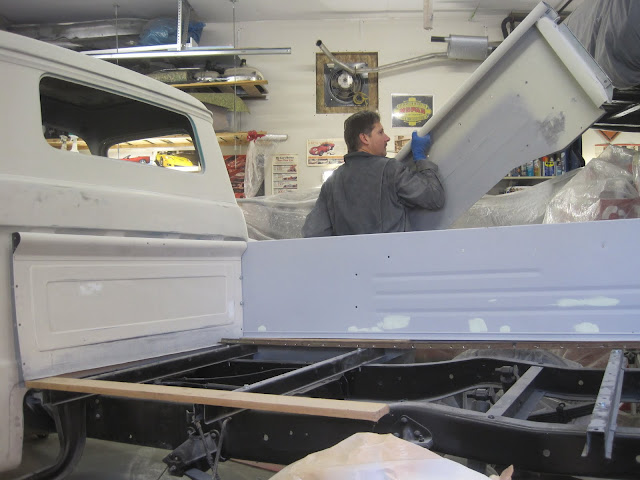

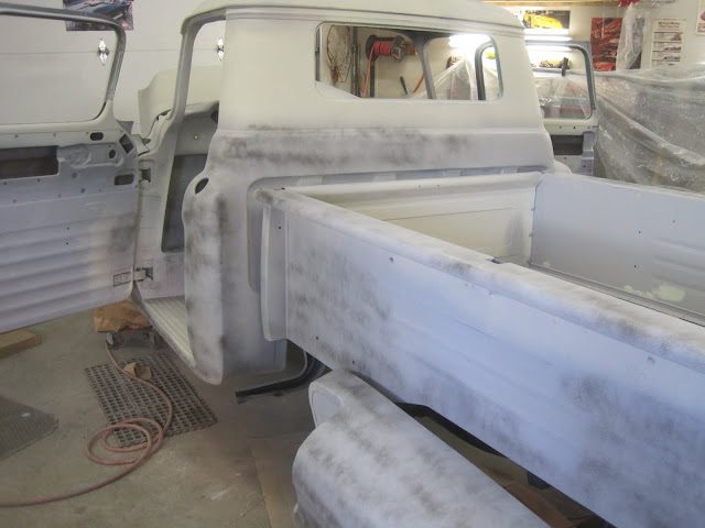

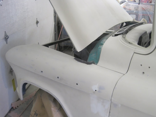

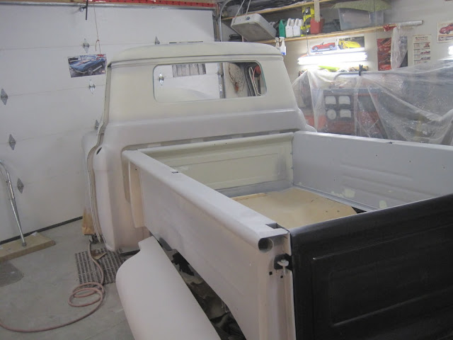

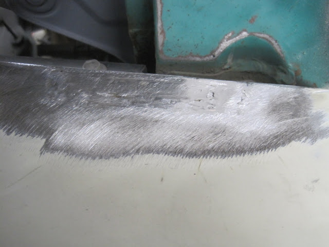

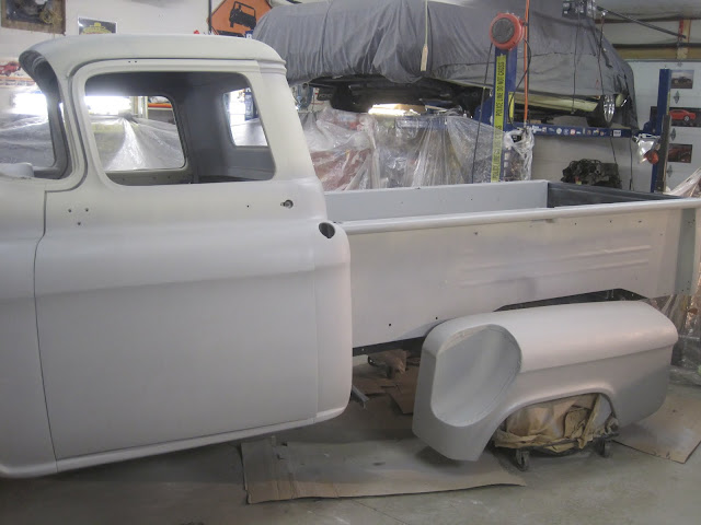

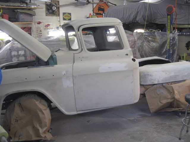

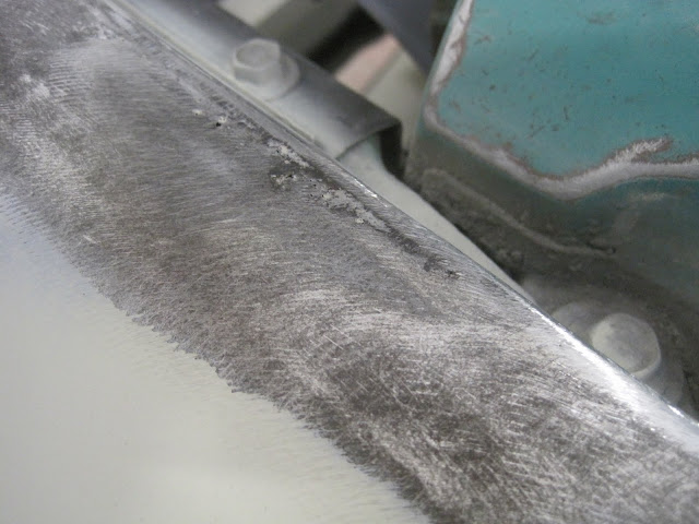

9 HOURS in the shop today....makes about 25 for the week.....
First coat - sanded off...

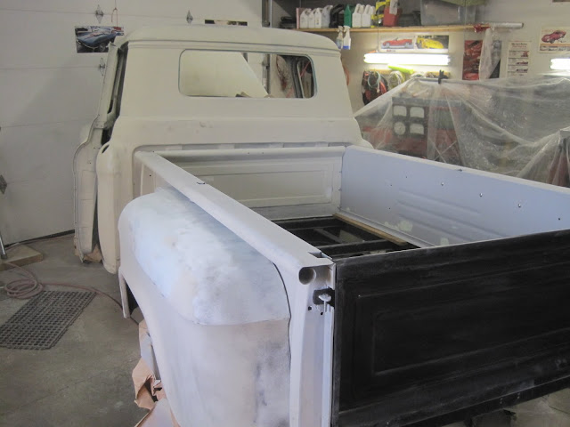

Time to fit up the box....
A little tweaking here and there....check out the box side to end-gate fit. That'll need some work with the BFH! Better now than after paint!
...and voila (spelled correctly!)...it's a truck!

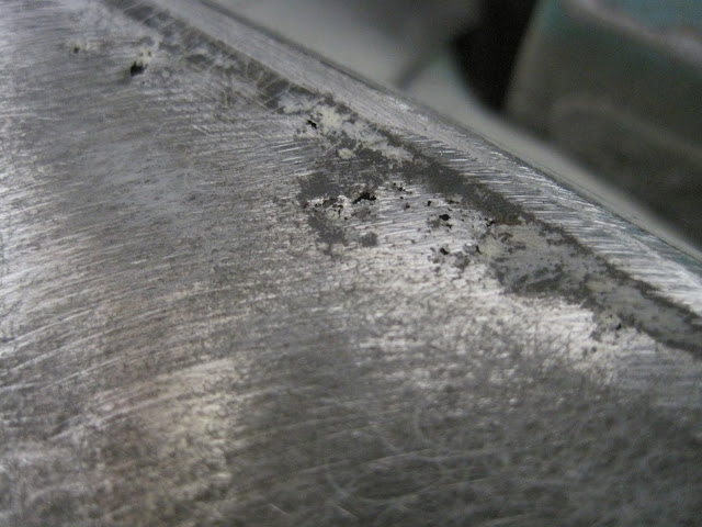

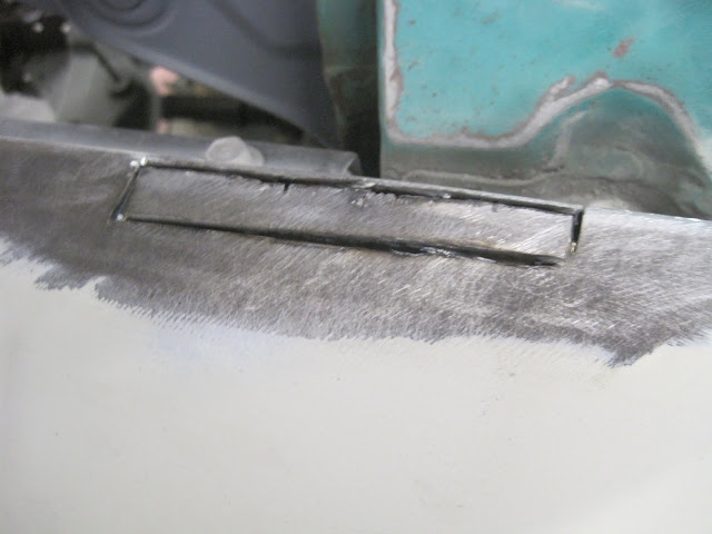

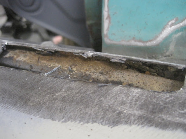

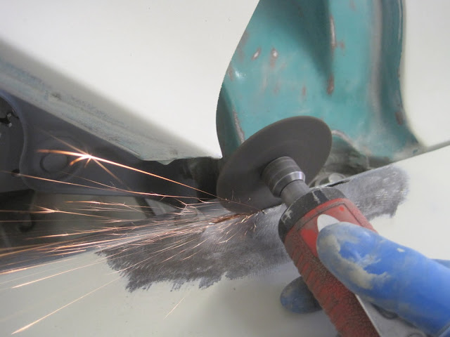

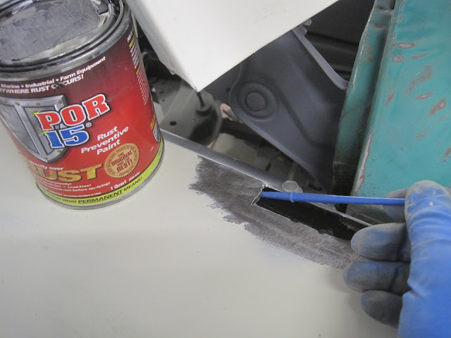

I'm aiming to get the second coat of primer on today.....but wait...what's that I see...a spec...a pinprick of a friggin pinhole....what's that?
It's RUST - ARRRGGHH! Talk about throwing a wrench in the works....Oh well, better now than....
Nurse- SCALPEL!!

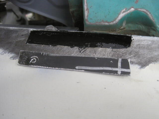

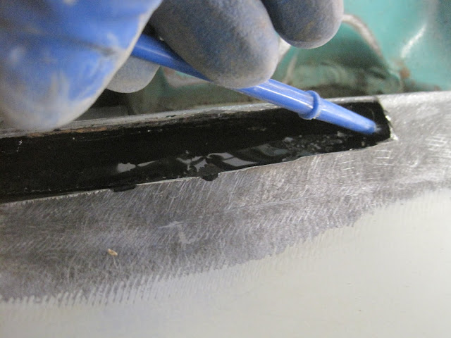

Clean er up. I used POR15 everywhere I could reach.

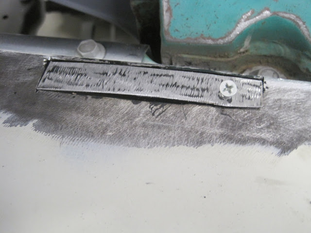

This is why I save all the scraps that get trimmed off repop'd parts. They have this super-epoxy coating on them that is perfect for the undersides of patches becuase a lot of times you can't reach the back side to poperly seal new metal.

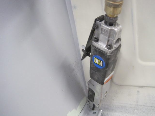

Top side gets ground clean and I used a screw to hold it in place...

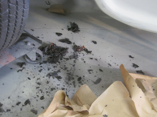

Wait another minute.....why is my foot so hot......wait, now my leg is warm.....did I piss myself:bounce: no....
FIRE - FIRE!!!! For eff's sake, the paper wheel cover is one fire!!! What an idiot!!!:wtf::bounce:
After stomping out the fire and having every scary scenario run through my mind (there's a LOT of flammable sh!t in here!!), I moved the fire extinguisher closer and finished welding the patch...

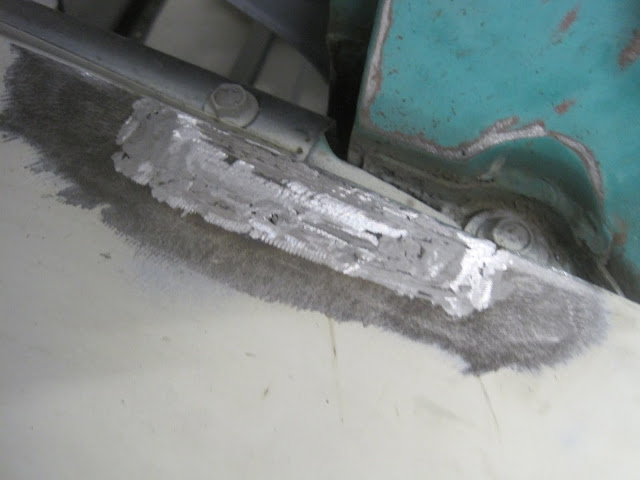

A little grinding...
a little more...and no filler!

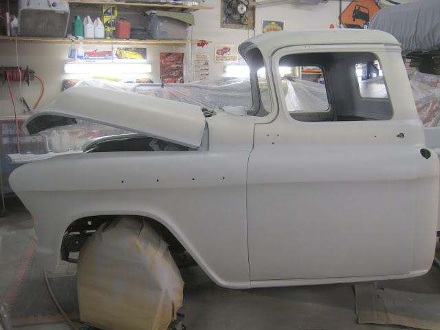

So, after getting that out of the way - plus another 4 hours of finding little spots to fill and sand out, then cleaning everything again (vacuum all dust build up, blow out all crevasses, wash and wipe entire truck and all parts with pre-paint solvent), I finally got to mixing up more high build and spending 2 hours spraying it on...
And I'm done (for tonight!!)

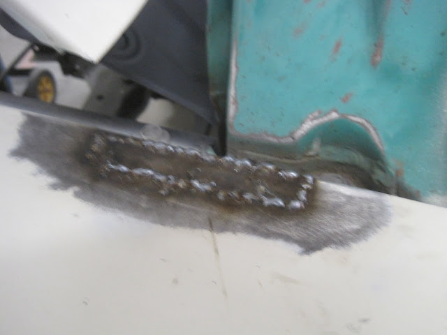

Excuse my ignorance but I have a question about the weld patch. The welding looked a little rough. Did you use mig and did you weld spots to prevent the panel from warping? The truck is looking great. :thumbup:
E
e-tek
Dec 19, 2007
10,690
Saskatoon, SK
Re: E-tek Resto's 56 Chevy Truck
No worries - I love questions. To keep the panel from warping did turned the heat down - so lots of it was sitting up high, which isn't as pretty as a fully penetrated bead..... I always tack (spot) weld, but since I had lots of primer on and it was already blocked, I wanted to be sure to use as little heat as possible. After the first grind down, I touched up a couple spots that weren't welded right through. Then I ground those down to what you see.

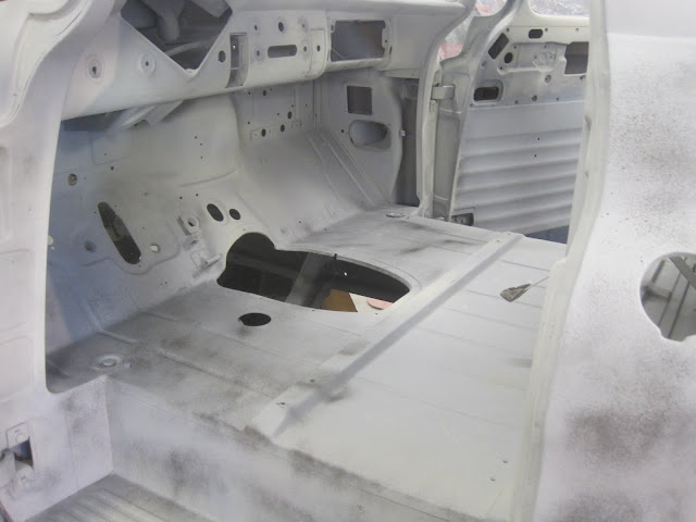

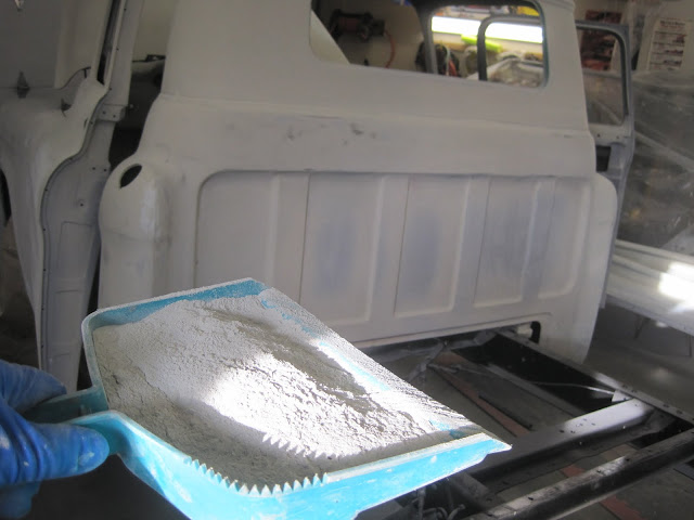

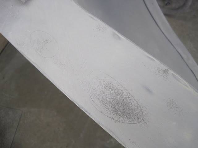

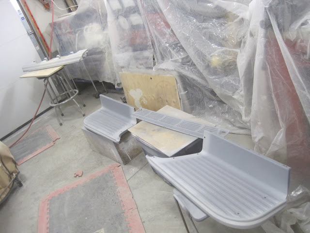

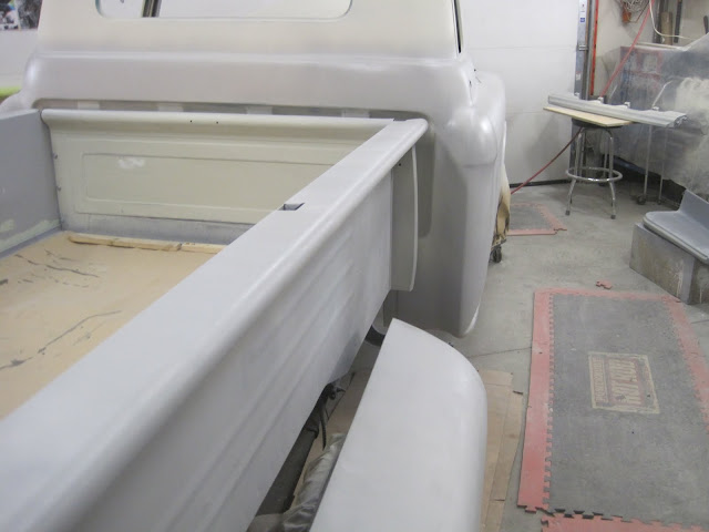

Todays episode: Sanding, sanding....and - you guessed it ....more sanding...
Once again: new primer with guide coat

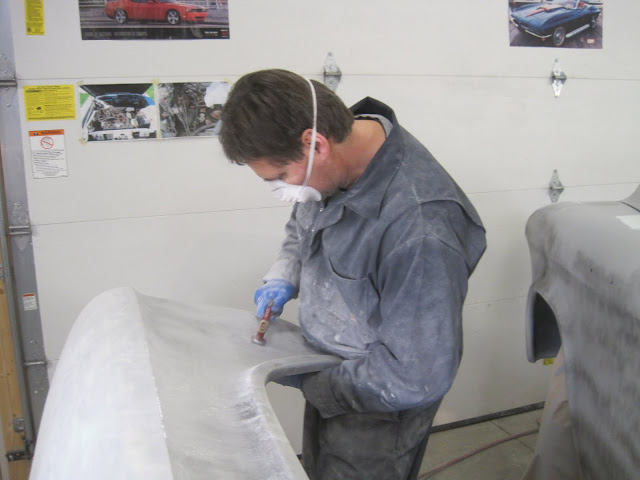

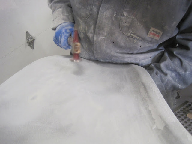

Today, the owners SIL (Trent), who's spear-heading the restoration project, came over to lend a hand with the sanding. He did the diificult interior and floor portions, while I got the body panles done again.

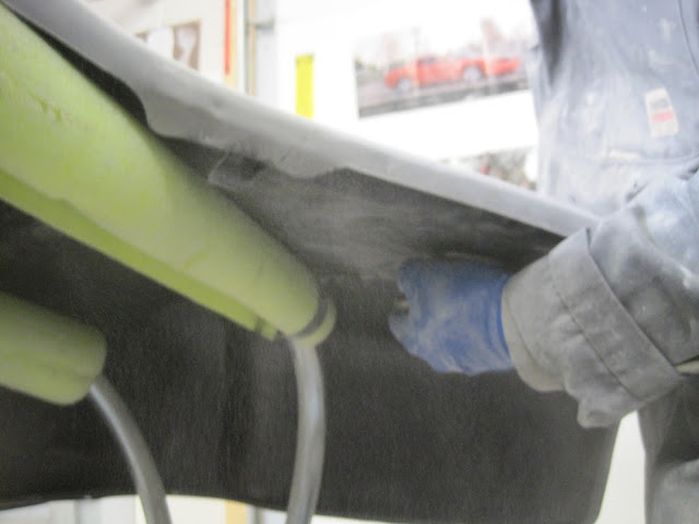

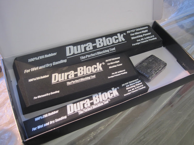

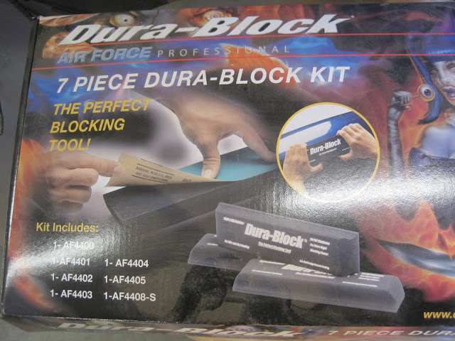

He also brought over a set of Eastwood's Durablock sanding blocks to use. Apparently they're the "Perfect Blcoking Tool" - says so on the box! We'll see about that!
Jury's back with their verdict: these blocks ARE good. Being a little Old-school, I still use a wood sanding block (not quit a 2x4, but close), with handles, but the Durablocks have just the right stiffness yet give a little, so they gouge less and follow contours better. Plus they're extremely light, making them easy to hold onto to. You use them with adhesive-backed 3" paper, available in rolls, which wasn't an issue as that's what I use with my sander as well.
Again, we sanded with the blocks until we saw either metal or filler. If you see filler, you can still go a little further, because it's a high-spot that you can sand-down some more. But if you see filler and/or metal all the way around a low spot, it's best to stop and either repair the area with hammer and dolly, or fill it so that you can re-block it later:
Below, I'm holding the dolly under the low spot, bumping it up, then holding pressure on it to bring up the low spot, while tapping down around it with the hammer. I swear these fenders where either used to heard Buffalo - or maybe they just took a good ol' Saskatchewan sh!t-kicking over the years....:lol:
As for time-lines, once this is blocked and the last rough-areas repaaired, it'll get one last (?!) coat, which will then be wet-sanded with shorter blocks in 400. A final (thinned) coat of primer and it'll be off to the paint shop. We're guessing 2-3 weeks from now!

Its looking great. Thats good news about the sanding blocks I bought a set last summer. Now I just need my car to use them on.

I have a set of those, and love em. Did your kit include any of the round ones? great for doing the rolled parts of body lines.

It was a complete set, but the owner left them back in his shop. I've just ordered the set for myself and I'm interested to see if they're better than radiator hoses! :)!!!

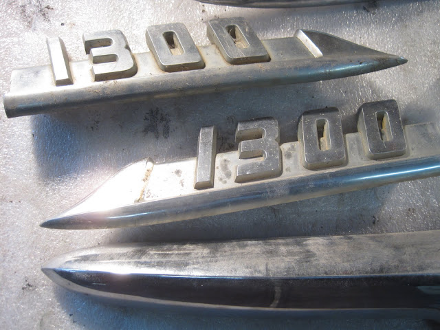

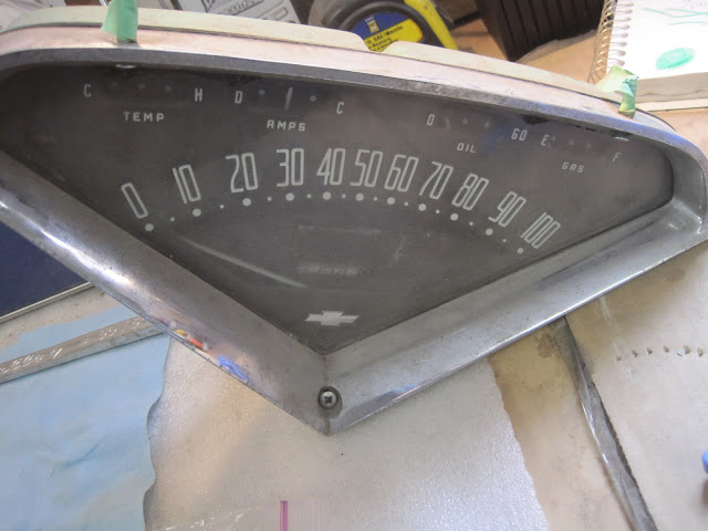

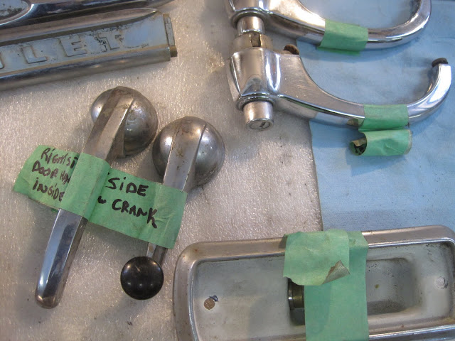

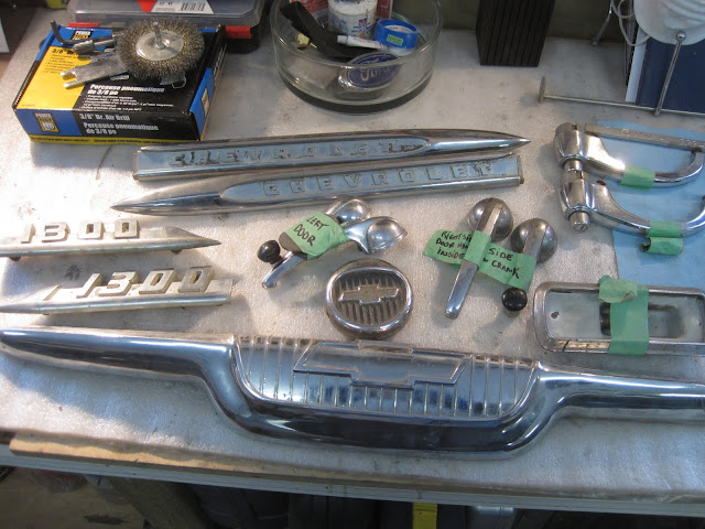

Here's the chrome bits from the truck. Owners will have to decide wether to replace with new, or have re-chromed. Some things are crazy expensive, some not: the large Hood chrome part and the 2 "1300" Fender spears together are $400, but a handle set (2 pces) are $35...
Super cool guage cluster!!! Can't wait to clean this up!!
If I had OEM parts that were at all repairable I would use them, some of the aftermarket stuff is really questionable. I can almost guarantee you could polish up the old stuff as is, use it, and in 10 years it would look still better than re-pops.
Flange
Jun 9, 2010
424
Northern England
X2.
As someone who has also restored a few old vehicles I can vouch for the inconsistent quality of aftermarket stuff.
However, it is the choice of the owner although I am sure e-tek will advise them of their options.
