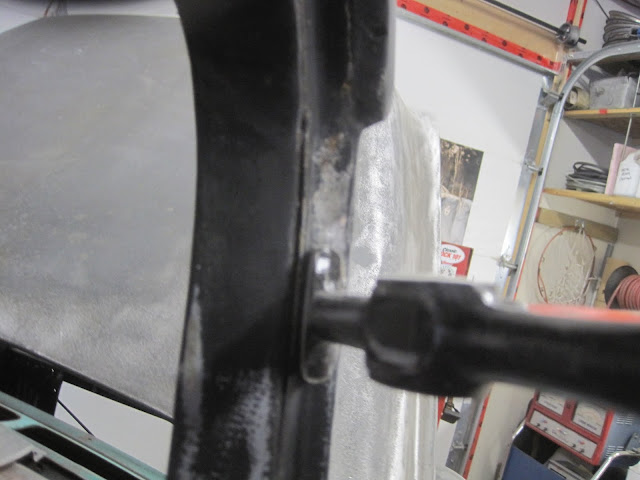

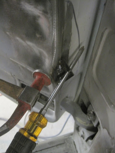

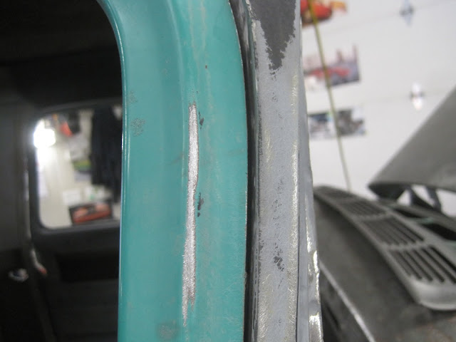

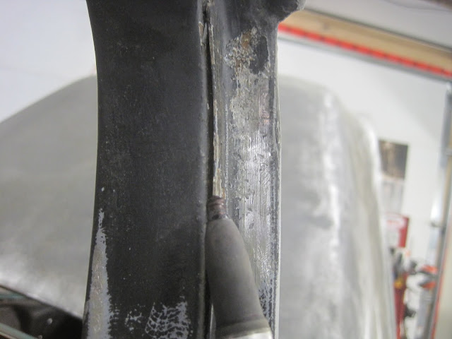

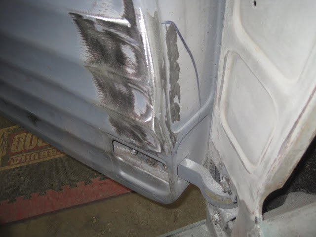

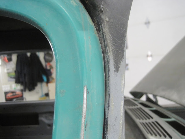

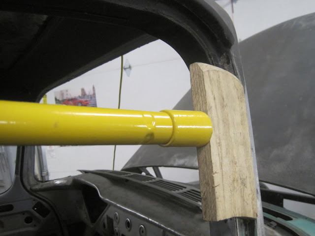

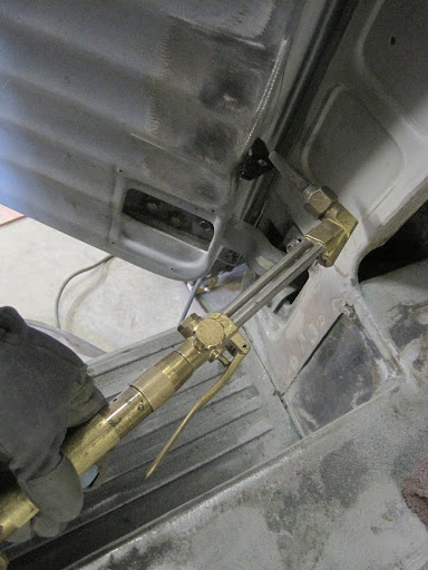

Recall our starting point on the passenger (Right) door gap:
Looking at the assembly manual measurements it shows that one side is "open" a 1/4 inch and the other "closed" the same amount. So I grabbed the Porta-Power (PP) again and rigged 'er up to give the left side a bit of a push...
Normally, when you move metal you have to push it more than you want due to spring-back. Nearly every metal structure has built-in tension which wants to spring back a certain amount - unless you push too far, in whcih case you'll just F$&K it up worse than before! ;)
As well, when you move one thing, other things move around too. Sure enough, when I removed the PP I could also see that this seam was opening up:
Between the PP and a light light tapping on the edge, I did get it to move and stay moved...

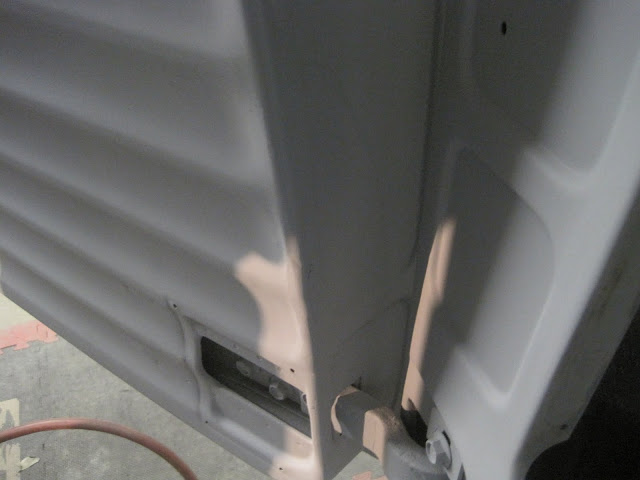

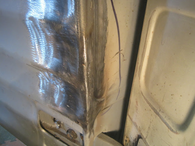

Which gave me this:
And even though it's not as wide as the other side, I think a happy medium is good here, because the other side was likely moved in the opposite ddirection. Of course no-one will see both sides at the same time like we are here, so me thinks it'll be just right.

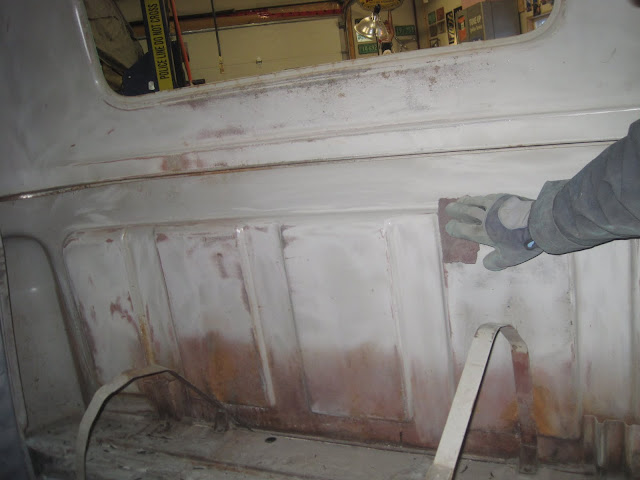

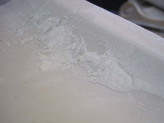

Then, I spent a few hours block-sanding panels, which isn't really exciting enough to photograph! However, one thing someone might get a kick out of is re-tapping a captured nut. Next time you strip one (which I'm finding is easy to do since FORD used NC - National Fine - threads on everything in those years!), don't fret, you're really only about 6 minutes from a perfect fix:

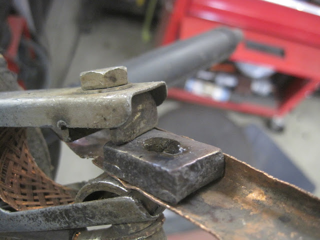

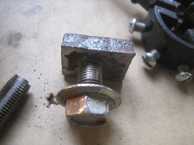

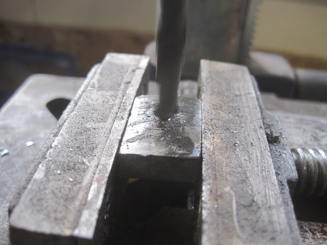

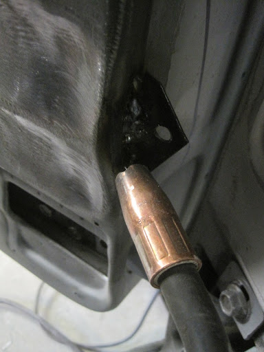

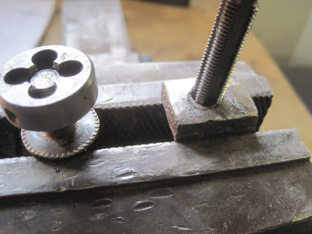

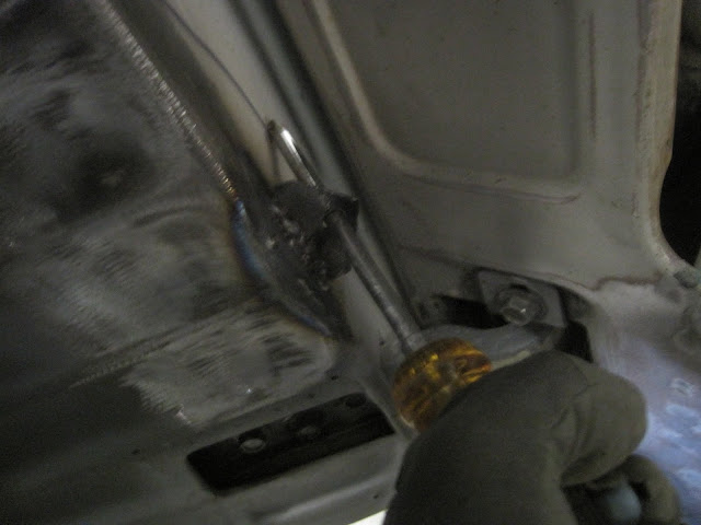

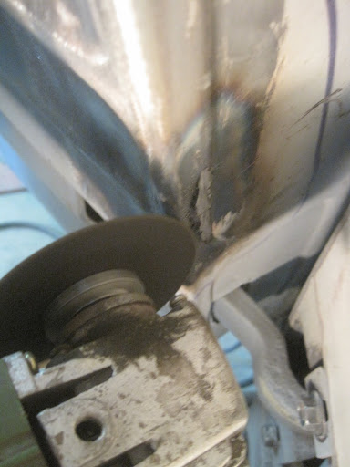

I used the MIG clamp to hold the nut onto a piece of copper, so the wled would be contained by something - but not stick to it:
Once filled and ground flat I drilled it out with the nominal drill size for that tap-size:
Then tapped it out as well as cleaned the bolt threads:
And WALA - as good as new!

Is there a reason you weld-filled the old nut rather than just using a fresh piece of steel?

It was a pretty thick piece of steel, was the right size, was there....but you're right, could have used anything of similar size....I guess I was just making the point that you can repair anything using these techniques.

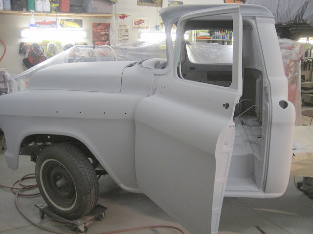

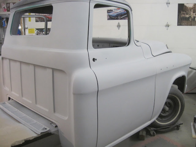

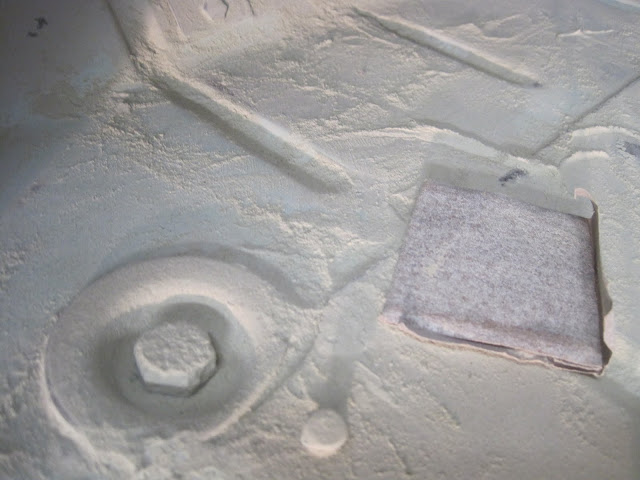

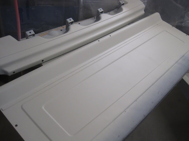

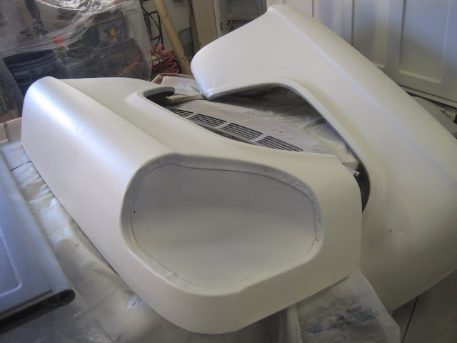

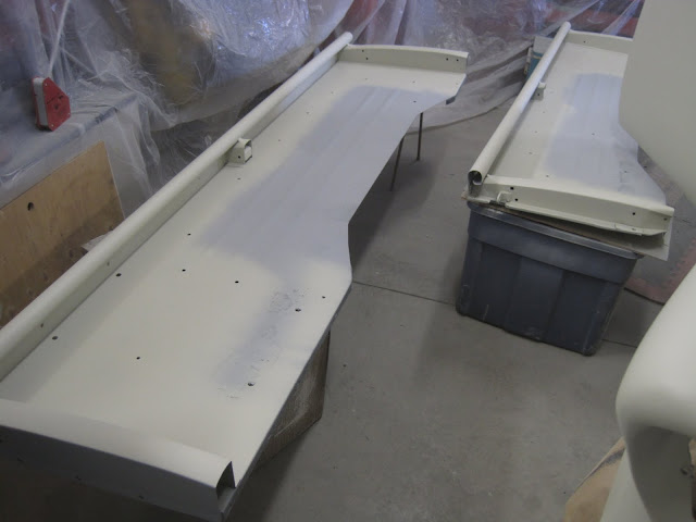

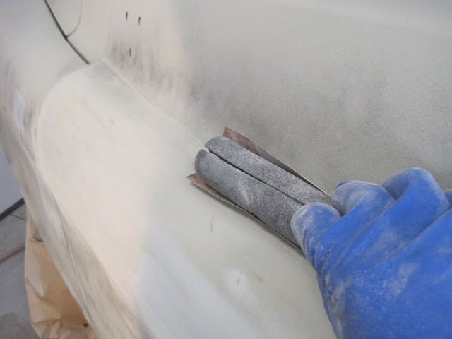

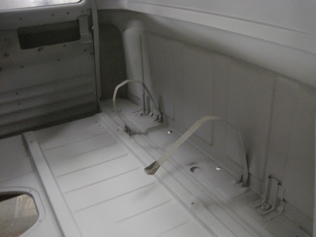

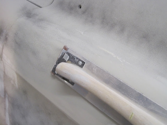

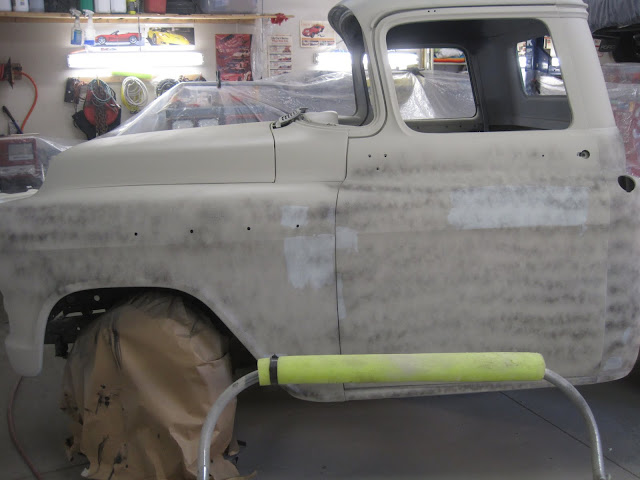

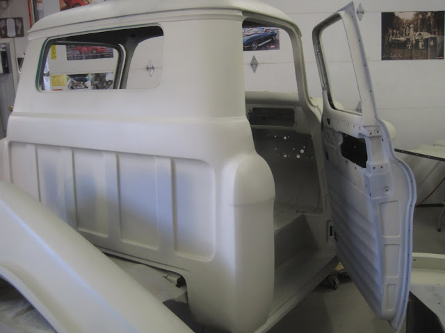

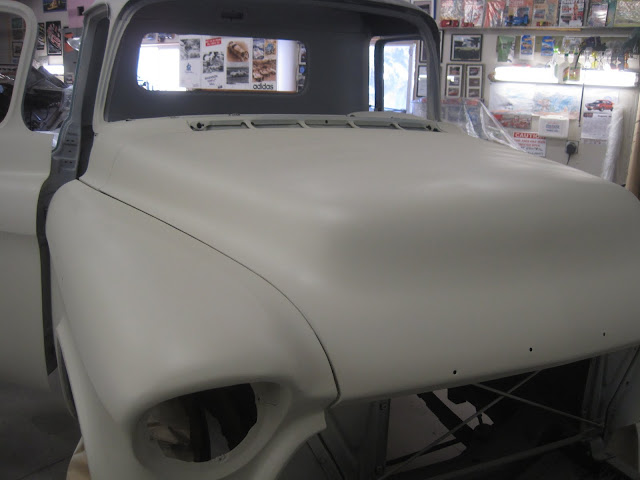

Todays episode: high-build primer on box inners...Please excuse the photo quality, I had to use my phone today :headscrat

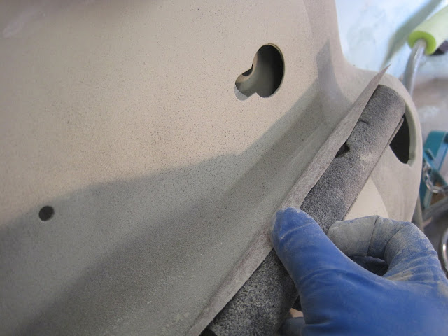

After a few more hours getting the metal (fairly) straight on the box sides and end, I got out my primer spray equipment. Since I only spray etch/block primer every few months, I clean up all my equipment and pack it away so it doesn't deteriorate. When I get close to the primer stage on a project, I find all my equipment and supplies and keep it out until I'm all done this stage. On a show-level resto like this one, I'll spray etch (once), high-build (2K) 2-5 times and maybe a coat of sealer to finish. Although the gun gets cleaned between every spray, there's no point putting it all away until I'm done the primer stage!
Once again - the BendPak lift gets in the act - this time as a make-shift spray booth!
These parts got 3 coats of high-build, which should be enough to block them straight. I wanted to get these coated so I could assemble the box and check it for fit and alignment, plus do any metal work to these pieces. Once it - and the cab are all together, I'll spray the entire truck and start the long block-sanding process.

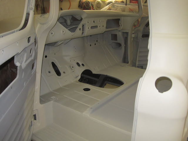

The cab is very close to being ready for primer...again, sorry for the phone-pics today...
Once it's all blocked, sealed, then wet-sanded in 600G, I'll dissassemble it all - VERY CAREFULLY - and transport it to the bodyshop for paint. While the body parts are there, I'll spray the entire frame and inner-panels with Tie-Coat primer, then spray it all in Chassis-Black. It'll be gorgeous.
Also at that time, I'll have to install all the brake lines, wiring and drivetrain and can do all the wheel.brake rebuilds and such...
Moving along - thanks for coming for the ride!:beer:

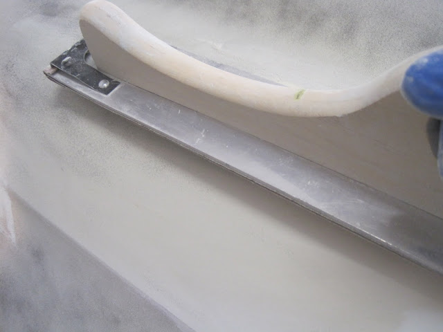

love me some Slick Sand. Get the mud close, 3 good coats, let cook overnight, block and paint. Works awesome.

E-tek in the resto-shop I work PT at we always etch and then epoxy, give the epoxy a scuff and then a coat of slick sand http://www.evercoat.com/productdetail.aspx?pid=28
we'll block that and then give it 3 good coats of high-build primer and block again, gives us super straight panels.
That's sounds like a great method - LOTS of build for sure! I normally spray Etch or Epoxy (based on how much bare metal there is) for a base, then 3 coats of 2k high build, rinse, repeat, then a sealer.

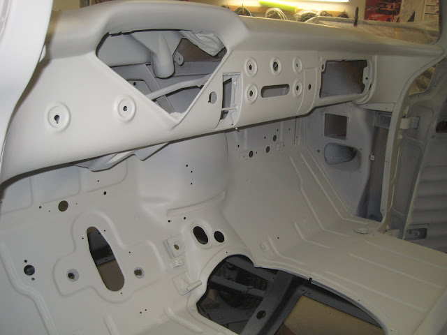

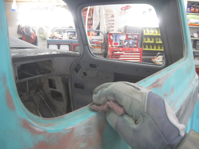

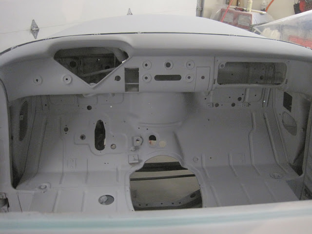

Got the Epoxy on today and will shoot the high build tomorrow morning.

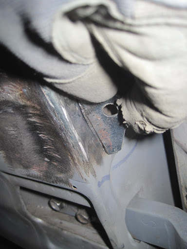

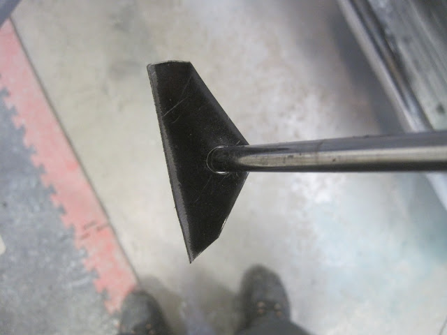

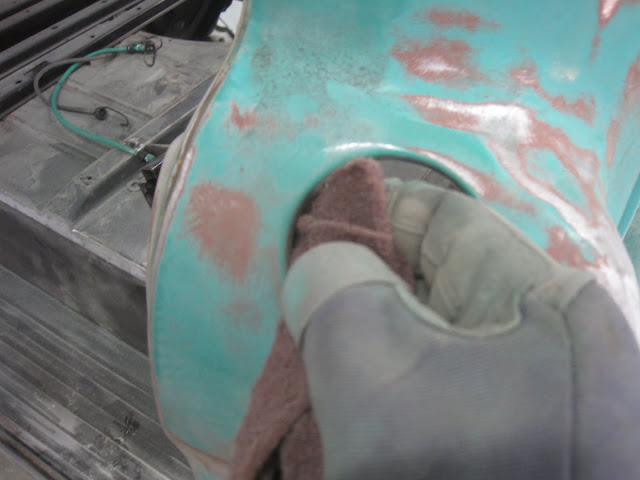

First off though, I had to repair this one last item - the inside of the door. Made a pulling tab with an edge that matched the indent, Mig welded it on, then heated the area I wanted to move. With a big screwdriver as prybar, I pried whilst tapping the high spot with my hammer. Took about an hour, no filler.
You really have to be sure every inch is sanded - unless you want stuff peeling down the road! After everything was gone over with the DA, then 220by hand, I used a red scotch pad to make sure there where no shiny areas and that everything was sanded...
Then I wiped everything down - twice - with Wax&Grease remover before setting up to prime. That also meant cleaning the shop, vacuuming all the dust and covering what I didn't want primed!
Then I shot the epoxy....what a difference!

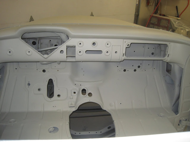

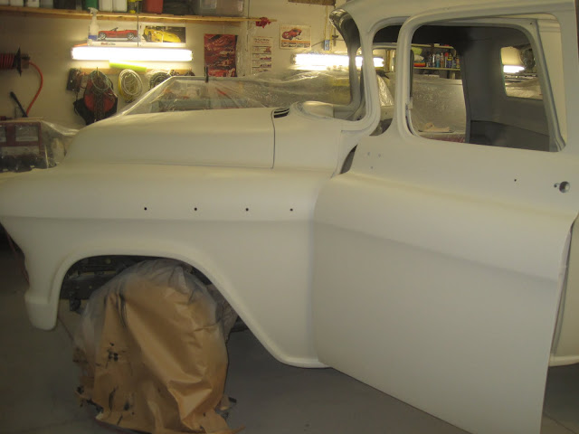

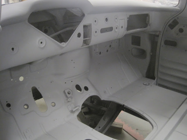

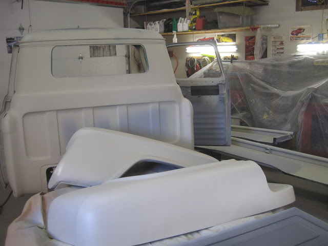

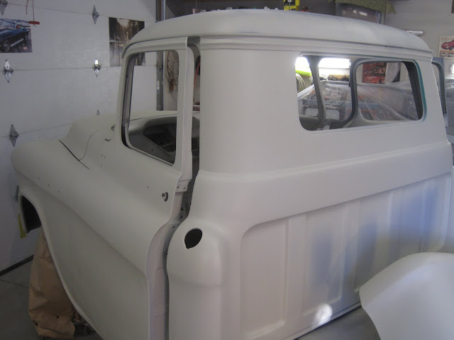

Today I prepped the box pieces, sprayed them with Epoxy, then sprayed EVERYTHING with high-build: a full 4 hours of spraying.....now I'm FRIGGIN' exhausted. Total time to date? About 150 hours.

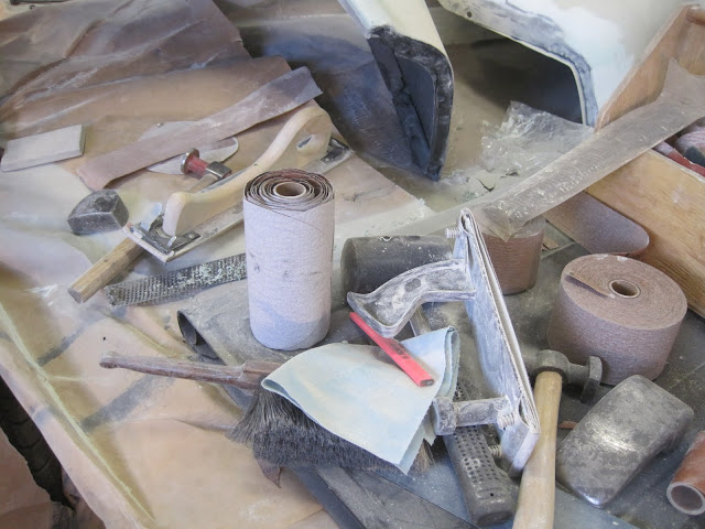

Very nice work, I see a how to video in your future:) I just had a small comment, from an amuture. I notice you spend lots of time sand blasting small nuts and bolts, I was wanting to ask if you had consider using a viberotory pot that has abrasive media, just drop the bolts in and turn on and leave for a short time, makes it look like brand new, and alot easier than blasting. Just my .02 cents - usd.
Although I KNOW I should buy one of those tumblers, I kinda enjoy cleaning the stuff in the cabinet or with the wire wheel....it's the ZEN part of the whole build! I kinda thought Santa may have surprised me with one of those tumblers, but guess I'll have to check out the Eastwood site and get one myself!

On to the dirty work :( . This part of the bodywork, as important as it is - is also the WORST part. It's what I imagine it's like working in a salt mine. Repetitive, dusty, dirty. The sanded filler gets into your clothes, hair, eyes, mouth and nose - no matter what you do to protect yourself. So I suit up best I can, turn up the radio and just get into it, thinking of the finished product all the while.....
The most important part here is the use of a "guide coat". You can either spray (mist) a different color over top, or some guys will add a little paint to the last coat. There's also a powder available that you can brush over the surface. Whatever you choose, it allows you to see what and where you've sanded. Without it you can't really tell if you've gotten the area straight, or even if you've gotten enough of the rough surface off.
The key to getting it straight (or perfectly curved), is to use blocks and other items that retain their shape. Rarely will you use your hand or fingers (unless that's the perfect tool!), which can end up following the contours you're trying to eliminate. Like sanding any filler, as soon as you see metal - STOP!
Regardless of the tools you use, most sanding is done in a "cross-hatch" pattern, ie. overlapping strokes along the longest axis of the panel, working from one side to another. Generally, the more times you can change direction, the better. BTW, I normally sand the initial coat with 220G (dry).
When sanding a large compound curve, like the tops of these dorrs, I'll tip the block on it's side in order to "cut" the filler off, but still retain use of the straight block.
Here's the nasty stuff that gets everywhere...I can still "taste" it!
And this is what it looks like after the first layers are sanded off. Ya - I even do floors!!!
Tools of the trade:
And treats of the season!!!
:thumbup:
I'll likely spend another 2 days sanding this coat and then spray a final coat, which will then get wet-sanded in 600 grit. If I'm lucky, it'll be largely done this week.....then I can put the box together and do more tweaking...
