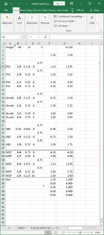

I’ve been noodling ideas for a storage rack for the various materials I use in the shop. I keep several thicknesses of cast acrylic, expanded pvc, mdf and abs on hand. I cut 4’ x 8’ sheets at 32” on the long side. Then they are easy to handle and will fit on the laser. I rarely make parts bigger. I do keep full sheets of several on the pallet racking.
Current method:
I’m teaching myself 3D modeling in Fusion 360. I do a lot better on real world projects. This is the next project I’ve modeled. One of the cool features is the drawing output. It gives a cut list.
What I’ll be making.. 1.5” square tubing and 1.5 x 1.5 x .125 angle for the shelves. Thinner items will have a 3/4 plywood shelf for support.
Shelf spacing is not exact in the model. Juice wasn’t worth the squeeze. I do shelf layout in an excel spreadsheet. I do the same for drawers. Works well.

Have you considered making the shelves adjustable so you can stack more material if needed on a single shelf? Not trying to add to your workload, but it is easier than adding to mine. :)

This is a good question, JB.. I've been thinking about how to store and organize this stuff for almost three years. I can't see me needing to change it much. And, I'm building some flexibility in via the fixed spacing. I'm going to pick up the steel and tack it up and see how it looks.
One idea I had would be to use rivnuts in the uprights to attach the angle iron shelves. I don't think the juice is worth the squeeze.. Did you have another idea on making them adjustable?

I think the rivnut idea is about the best, the only thing I'd thought of was a pin style like other shelving units. If the two sides of a single level aren't connected like a normal shelf I could see them falling out too easily. Maybe something like peg board hooks perhaps.
