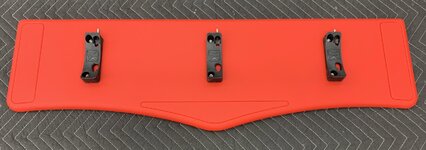

Looks like a high-tech bomb like in the movies. What is the mounting plate and brackets (that mount the panel to the tank) made out of? How is the assembly attached to the tank?
My bracket is made of 1/2 and 3/4 PVC foam board. Flat panel is 1/2 and standoffs are 3/4. Parts are assembled with Weld-On SciGrip #66 PVC cement. I use knife edge threaded brass inserts for the machine screw mounting points. Assembled bracket is screwed to existing threaded holes in the tank. Tank is designed to be mounted on the bottom and on the back (used when mounting on a vertical). I'm using these unused tapped holes to mount my bracket. I used nylon socket head cap screws, pocketed into the pvc. Should be no chance of a nylon SHCS screwing up the threads in the tank.
Top view of the mounting bracket.
That’s really cool. Can PVC foam board get wet? What’s its durability? Will the screw in inserts allow for getting the screws tight enough that everything feels solidly attached?
Yes, it is dimensionally stable, water doesn’t affect it (think pvc pipe), it’s quite strong and the span between fasteners is <12”. You could hang the tank from the mounts I’ve made and it would be good to go. The components I’m mounting don’t weigh two pounds total. The inserts are CA glued to the pvc as I insert them if rotation is a concern. I size the holes such that I don’t have that issue the majority of the time. Screws are tightened down no problem. I make a lot of different panels using this method. If I’m bolting two parts together I only use threaded inserts or rivnuts as appropriate and stainless machine screws. Like other types of fabrication, things get assembled and reassembled many times in the process. Last thing you want is thread into a base material that will fail. The inserts give a solid mechanical connection that’s strong, serviceable and will last.

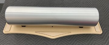

Test piece in mdf.. This panel mounts to threaded inserts in the car. Tank mounts to panel.
Fasteners hidden behind panels that attach with magnets.
