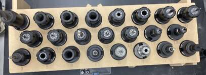

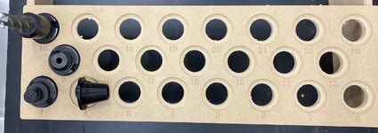

Started making a bench top CAT40 tool storage rack. Matt’s tooling organization thread gave some inspiration. These inserts match the taper. The Prusa does a nice job making them.
The concept in mdf. Will work for a while. Once I know I like it, I’ll make it out of a composite material.

Steven -
The floor - dang that’s a lot of work. I’m with FinallyGotIt on how much easier a repour would seem in comparison but keeping an existing slab is probably the way to go coat and outcome-wise. It’s going to be so much nicer when you’re done.
The tooling rack is sweet. Really like how the inserts turned out. Do they press fit into the board or will they just lay in the hole and the tool leaves them behind nicely when you pull one out?
I’ve been looking into the Centroid Acorn stuff. Can’t believe that Centroid made their stuff more affordable for the DIYer. My conversion for the mill was $12k - $15k if memory serves. Think I could do it for maybe half that now but maybe I’m missing costs somewhere. Eagerly waiting to see your mill project start to take shape..

The inserts are a light press fit. The tools are nice and stable in the inserts. I have a chunk of 1” Baltic birch that would be perfect for this.
