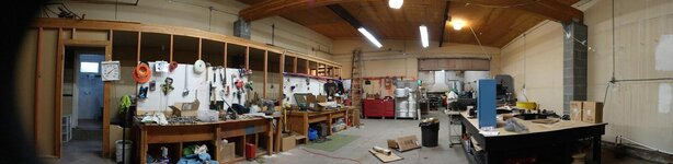

Some trading with a buddy resulted in this guy coming home today..
Before we loaded it on the trailer:
Hardinge lathe with Upgrade Technologies Accuslide CNC conversion with Fagor control. I will be installing new servos and Centroid control. Very similar to my mill conversion. Should make a really nice CNC lathe for my shop.

Got the lathe unloaded off the trailer and roughly in its resting place. It will stay on the cribbing until the controls are installed. Overall it’s in excellent condition. Was quite dirty. Still some cleaning left. Starting to sort out the existing control circuits. Most of the new control components are ordered. The existing Accuslide CNC conversion mechanical components look to be in great condition. I’ll have to source or make a few way cover parts that are missing. I have a 3 jaw chuck on the way.
I sorted out how to move the Accuslide away from the spindle. This will allow me full use of the X axis travel.
The lathe will be quite similar to my mill build: Centroid Acorn control, DMM AC servos and Hitachi SJ-P1 spindle VFD running closed loop vector control.
