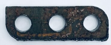

I got the plasma table plumbed with air. I still need ti run a proper drop from the header. There’s a lot of air on the table though: scribe, drill, bladder, plasma power source, and a blow gun. Ran a test cut once that was done. Power is temped in. I need to run some conduit once I have locations sorted out and such.
Test part shows some issues. I’ve got some stuff to learn on the CAD/CAM side for this machine. Speeds are handled differently than machines with spindles. And, I don’t know what CAD or CAM I want to settle on. I have a few options.
Still pretty exciting t see it cutting!
Very little dross. Need to sort out some stuff in the CAM.

Looking great! Just a few notes:
Reading your cut edges can help to decipher whether or not what you're experiencing is low or high speed dross (a perfect cut speed will have more vertical lag lines with minimal to no dross, I'd argue your cut speed looks a bit fast on this example, can see lag lines trailing from top to bottom of cut);
As a rule of thumb, hole cutting speed should be about 60% of the external perimeter cut speed;
Lead ins should start as close to the center of the hole as possible(your lead ins on this example are very close to the perimeter and can potentially deform the hole), and a lot of people ditch the lead out on small holes;
Fusion CAM is great, but it can also be very frustrating and time consuming for cnc plasma work - I recommend looking into SheetCAM before getting super deep into Fusion. As you progress and try to dial in your cut quality as best as possible, you want more and more control of the variables I mentioned above. This is sometimes possible in Fusion, but it's quite time consuming, you have to make many different cut profiles in order to alter things like cut speed and lead in/out variations. The programming almost always took me much longer than the actual cut time of the parts. In SheetCAM, you can set rules that will automatically program into your cut profile (such as the 60% cut speed on interior holes, etc). The UI in SheetCAM makes it feel like you're using a Windows 98 program, and there is more complexity to learn, but I think in the long run it's a much better CAM program for cnc plasma tables.
I know this was unsolicited advice, but it can be really tough to navigate and understand the information on cnc plasma cutting. I am far from an expert on the matter, but I have gone through much of what you're currently undertaking and thought it might be helpful to pass on what I can. Feel free to DM me on Instagram at any time too, I'm more available there than I am on here and I'll do my best to help.
On a side note, seek out forum/blog posts from Jim Colt. It is widely known that he is one of the most knowledgeable and experienced men on the planet when it comes to this stuff.
When I ran my table for years I realized that the smaller holes wouldn't have the lead-in because the arc was too large and the software would eliminate it as a result.
The arc of the lead in is what allows the cut to naturally roll into the interior or exterior of the part without creating a disruptive entry which is also important.
I agree, it can be good to have a lead in arc that is close to tangent when it comes in contact with the profile of the hole. I'm not sure what software you used to program, but in Fusion the lead in length, arc radius, and angle is adjustable so you can really fine tune where the pierce begins. In my experience, having a pierce and lead in beginning so close to the cut profile can blow out the profile and/or overheat the hole (diameter dependent) so that by the time the cut profile is closed, there is a defect from the material being so hot.
the software I used (it's been years ago) also made those parameters configurable. I never had and/or observed an issue of work hardening by the plasma cutting process. The precision of bolt-sized holes wasn't acceptable and we shifted to punching everything.
Sorry, by overheating producing a defect I didn't mean metallurgically, I meant it can produce an irregularity in the hole profile. Sorry for hijacking the thread a little bit here!
