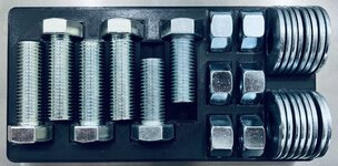

Four parts at once is going well. 82° single flute chamfer is working well. Need to get a multi flute though. The single flute is what I have on hand.
These small production runs are a huge learning opportunity. There are three different parts that will use the same soft jaws for OP2. You can see chatter marks on the far right part in the photo below. I centered the stock better on the vise jaws and it took care of that chatter. I should be able to face the part and it will still be usable.
This part adds thickness to the main jaw when the application calls for it.

Cool, I'm interested to see more about the product you're developing! When you can divulge, that is. What diameter are those washers, just for scale? The dividers between each washer look really thin, interested to see how well those print as well.

Product is specialized tooling for electrical testing. Bolts are 3/4 x 2.5”. Washers are 2” diameter, I think. Stepped away from the PC.
I’m interested to see how the print turns out. I may not have room for this box in the travel case. We shall see. As I’m sure you understand, revision one of undoubtably many.
