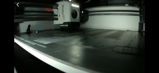

The replacement Revo Six HeaterCore arrived and the Prusa is back at it.
@MadeByMiller this is the first layer (on the left).
This is a satisfying photo:
I’m done with the magnetic drawer labels. I may or may not have made 99 of them!
Thoughts on the X1C after a week of it in the shop.. it's an absolute win. I had two minor issues, and they were both my fault and easy to resolve. The multi-color piece cannot be underestimated. It's reliable, fast, no fuss, and it makes beautiful parts. I'm very happy with it.
This is very satisfying:
It’s hard to tell in a still shot. X1 is printing hardware case bottom, Prusa printing a top.

That's disappointing. It pains me to say it, but Prusa is losing some luster for me. Especially when I was comparing a new i3MK3s with enclosure, Octopi, and Revo Six with the X1CC. They are quite close in price, the Prusa is a kit - even when buying assembled because of the enclosure. And, the X1 is an all around better printer in every way.
This was the goal.. print both parts at the same time. Worked well.

Those parts look excellent! What to you attribute the difference in part sheen to (the Prusa parts are much more shiny in appearance in the photo)? Are they printing at different temps? The ambient temp inside the enclosure of the Bambu?
S
slodat
Feb 6, 2010
3,682
Central-ish, WA
Thank you. I’m really happy with the parts. As far as the sheen goes, I really don’t know. I’ve used the same ish PETG settings on both printers and the X1 always produces a matte finish, on any filament. I haven’t printed PLA on the Prusa in well over a year. I can’t comment on how it looked off the Prusa.
The X1’s cool plate preset is 35C for PLA. I was somewhat assuming that is part of the finish.

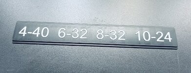

I was chatting with @MadeByMiller earlier about drawer labels. We both agree that they clutter up the otherwise cleaner visual space and lines. Then why am I making drawer labels? Because there are a lot of drawers in the shop, and lesser used stuff has proven to be less easy to find at times. And, I often open/close a few looking for what I know is in "one of these drawers". The HF toolbox labels are working out for the most part in their current form. I didn't label every drawer becuase many are reflexive.
All that to say, I started on labels for the Vidmars. My Vidmar cabinets are kina rough cosmetically, and fully functional. The drawer handles are no different.
This was the first (test) piece.
It slid right in. A little too easy. I snuck up on the right dimension so the label wouldn't slide around in the handle. It's a nice tight fit now. A 3D printing savvy friend has been asking me to see how the X1 does with ironing. This is the result:
Obviously, ironing on the left label. It is crazy how smooth it makes the surface. It dosn't seem to add too much time to the print. Honestly, I don't get concerned with how long a print takes generally speaking. It's automation and it runs unattended. This is more what I'm thinking I'll make these like:
Installed. These letters are 15mm tall. The finish on the print is really nice. I left the X1 working on these:
Here it is churing away while I decompress at home:
The ironing eliminates (or minimizes) the "3d printed" look enough to really change things. The multi-color prints on top of that and.. this is really cool stuff!

I am really impressed with the ironing function on the X1. The plaques almost look injection molded.
:beer:
Agreed....that ironing surface is awesome!
This does make me think about labels for mine....my labels recently have been 1" tall label maker tape stuck to a 1" tall magnet I cut off the roll
But I could do a "lazy mans" 2 color appearance by printing the letters/numbers as the negative/blank space and then sticking contrasting paper to the backside that would show. Might have to try this....my Vidmar has the slightly curved label holder so will need to keep it pretty thin
