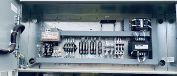

This project included making a duplicate of the parts to house a panel meter and it’s associated devices.
Existing:
CAD model:
With the door. Meter mounts in the opening in the center.
