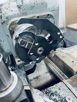

I've been working on making the hinges I previously posted about. There's a lot to them. Three setups, smaller stock, work holding challenges, etc. I went back and forth quite a bit on when/how to make the hinge pin hole in both parts. I finally settled on doing it first. This is the soft jaw I came up with. It holds the stock for a pair of hinges securely.
The dog bones in the corners make room for the corner of the stock, and a potential burr from sawing. Here it is loaded up:
I finally got all the OP2 tool paths sorted out. Next up is getting the Haas setup and run the first parts.

First set of soft jaws were too small in places, so the parts didn't fit. Looks like things were 0.012 undersized. Made that adjustment and the parts fit great. I broke the rear jaw tightening up the moving half of the hinge. Printing 100% infill overnight to see if that helps.
A few tweaks on the second set and I'm close to having reliable process on all three operations.
Parts are in the tumbler now. Should work great! SO much work getting to this point.
