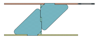

We make this i-beam bracket somewhat regularly for a client. There are small changes in dimensions, but the part is common.
The photos are of a part that recently shipped.
Side note- the powder coating is turning out very well. We’ve all but retired the paint gun.
I spent some time yesterday changing this to a tab and slot design. First up was a symmetrical gusset.
It works like this:
This is what's going on inside the part:
And the tabs and slots in the main components:
Now to cut the parts and see if my 0.01" gap is the right amount. More to follow. This is something I've wanted to sort out for a while now. Will really be nice for these small welded assemblies.

I made a section of the parts to test the tab and slot stuff. I made a mistake in CAM resulting in the lead-in and out happening in the part instead of the drop. Wasn't worth cutting new parts over..
The parts went together quite well with the gap I selected (guessed).
The remaining part drops into position.
I'm not sure if I'll use this in the customer's parts just yet. It does work quite well, and I think it would save fabrication time vs. manual layout. The slots could easily be filled with weld and ground flush if desired..
SamYoung
Jun 4, 2020
106
Massillon, Ohio
If your worried about the visibility of the slots after weld, maybe compromise and only do them for the gussets in center support. It would line them along the length and height, but they'd only be visible in the channel of the beam. You'd only need a square to line them up then. I know you'd still need to manually align the top and bottom plates to the center support, but it'd still be a step up.
If you haven't already, potentially cut a negative sheet metal template to align the center support depth from the edge of the top and bottom plates during welding. Even if this value shift, if the design is common you can cut a new set with each cut package for minimum cost. I did a quick sketch of what I mean. The top and bottom can be removed from the design depending on your orientation during weld up.
Obviously a lot of this has to do with your specific setup and procedure, but food for thought.
