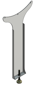

I thought this Fusion sketch was kind of fun. For those of you that use Fusion, it's fully constrained as well ;)
The bottom will be welded to the side flanges. This will both level and support the fan. We all agreed this was a must have. The funny thing was I already had the leveling foot. When I bought them for the CNC Hardinge I bought four not knowing the lathe had three leveling foot locations. Made leveling that lathe easy. Now the loose leveling foot gets put into service.
