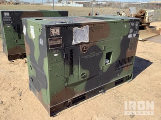

If you need three-phase power for big machines, that's gonna be a big ol' expensive generator. But you'd only need this to work while people are there and running the machines, so you might not need as much fuel on hand if it's not going 24/7.
You'd think so. Family member has a huge sawmill, runs the largest mill on a Ford V10 powered LPG generator. He bought it used, the depreciation on these things is nuts as most businesses won't go shopping for used and they are not ideal for residential. He finally brought in 3-phase power and was letting that generator go for a under $5k. It was a few years old.
I'm guessing you might need two generators: a smaller setup (powered by gasoline or propane) for things like lights, computers, fart fans, beer coolers, router, etc. and a separate heavy-duty generator, maybe diesel, for the times you need to power the machinery. And do you need this to fire up automatically even if no one is there, or can it wait until someone shows up?
Now you have a dual-feed problem if you're wiring both sources into the building.
Strictly my hang out shop. Phase converter needs 50 amp 240v to run. Until I decide if this building will get new metal or another one built everything is temporary.
Cheapest way to do this is with an interlock and a "portable" 13-15kW generator. That's how I power up my shop.

Have a 7k gen converted to lp and have a generator panel tied to my main panel. Run a well pump, fridge, some lights, hot water heater, tv , internet and a 5k window ac. Heat is a lp cast iron stove. Not at the same time. Have been without power for 9 days the longest. We were comfortable.
sjvicker
Aug 9, 2014
610
SW Washington
So you need to cover 50amp 240v plus probably some other loads for fridges/lights/etc and this needs to be used intermittently to keep you going on your hobby work when the power company shuts you down. It also doesn't seem like you need to run that 3p equipment for days on end but only intermittently. This really comes down to the question of, how much are you looking to spend?
On the budget side, harbor freight has a 13kw generator that might cover what you need, or that generator plus a smaller one.
on the high end side you could do an ecoflow delta pro ultra setup as a batter/inverter backup.
In the middle (8-10k) you could diy your own solar system and have capacity to do what you need and be your primary source of power but really it seems like a gas generator fits your occasional use need.

I’m 100% off grid with SMA AC coupling, 24KW of continuous capacity aka 100A @ 240v (with my generator or AC coupling added to it I can hit around 115A), and 72x 370w panels, along with 12 DIY batteries for around 135KWH of battery capacity.
Generator is a preowned Ingersol 30KW powered by a Cummins 4BT (excellent unit).
Not cheap. But grid power is a mile away with an uncooperative utility.
