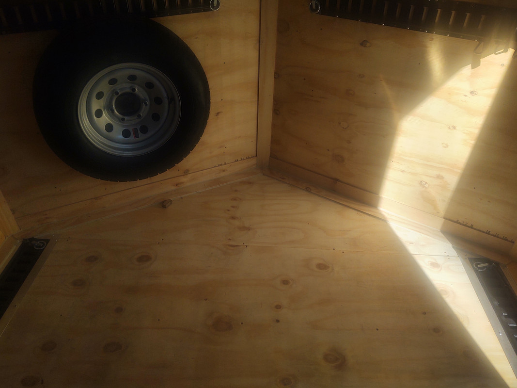

I recently purchased a 20 foot long, enclosed car trailer to help me moving from Massachusetts to Florida. I have three vehicles that I need to transport with this trailer one at a time. I would like to mount the winch to one of those receiver cradles, so it could be removed when not needed and used on the back of my truck.
The trailer has the typical three-quarter inch plywood floor and the tongue consists of 2“ x 6“ boxed framing members. I would like to do as little damage to the flooring as possible. I am open to any suggestions.
I do have a mig welder and I am able to weld to those framing members. I am not the greatest welder, but my welds have never broken and I have a grinder. I am concerned if I only attached to the center framing member that there will be twisting. I have no problem installing a metal plate on top of the floor with a couple of penetrations that could bolt or weld to the framing members?

I was looking at that set up and liked it. I can not use that as there is not enough room between the 3 framing members to fit it. I would prefer it centered as opposed to off to one side. There will only be a couple of inches between the tires and wheel wells on my widest vehicle and not much better on the other 2.

I had wanted to do similar but with the V nose there is about 3" of structural framing at the front. These trailers are made cheaply enough I don't want to make matters worse than they already are. I am going to draw something up in a day or two and see what you guys think? Being enclosed I would need to seal the opening very well and am not sure how well that would work.

This is what I have come up with.
and this is what I did under the floor.
I will eventually weld the nuts to the bottom plate under the trailer. That way I can install the top plate and remove it without ever having to get back under the trailer.
