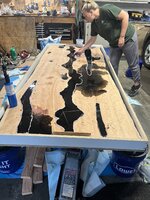

Building an Epoxy River Table for my daughter’s new house .
Does anyone have a technique for reinforcing the Epoxy in the river ?? I’ve seen people drill holes at angles into the sides of the river edges in hopes the Epoxy will fill the holes and provide some additional strength.
I’m thinking of pouring next weekend. The table is 2.5” thick . 48” wide and 9ft 6” long

glennm
Jul 29, 2009
207
Great looking slab. I have never reinforced any of the projects I have done but none are that big. I would get that in the form as soon as possible and clamp it down to be sure it doesn’t warp on you.

A table that big I would use c channel inset underneath, nothing in the epoxy to reinforce.
The thing you have to know about doing a pour is that epoxy is really good about finding a way out. When you think you have it sealed well enough, go over it again. Double check your guy on the deep pour, it typically cures slower to help manage the heat. The product I use(Superclear) has a 72 hour cure. Watch Blacktail, he does a great job.

So looking for some advice on the pour table I’m going to cover it in Tyvek seam tape and the same with the sides . I’m then going to Silicone caulk all the seams .
I’ve decided to use bucket toppers to build a 2 ft high table . They are a top with grooves in them that you attach to a five gallon bucket . Then I will make a frame out of 2 x 4 and set the pour table on that . I’ll post pictures when I have it setup . Kind of hard to explain.
I will then make 5 or 6 cross PCs that will be used to hold the slabs to the frame and hopefully keep it from floating.
So my big question is should I silicone caulk around the bottom of the cut out for the river ?? This should add extra protection from the epoxy finding a way out . How hard do you think the top will be to remove from the pour table ?? Will it really stick and give me problems or will it release from the Tyvek tape .
And last I’m going to build a dam of silicone around the river on top . I was told to not let the epoxy run out over the top because it could warp it .
I do plan on having a fan blowing underneath the table to keep it cooler .
Anything I’m missing??

Everyone will have to tell me if I’m Nuts or if you think this will work .
I built a frame and set it on the bucket toppers. Then I built a 9ft-4” long table with 4” sides .
I still have some caulking to do and I might tape over all the corners. Should be ready soon for the pour .

I plan on damming up the river and the two large cracks on each end with plastic lawn edging. It’s cheap and they claim the epoxy will release from it . After the Slabs are placed I will shim under the frame to level the table.
I plan on making 3 hold down bars over the top and clamping them down to the frame underneath. My idea is to silicone around the river and cracks and place them in the box . It should keep the epoxy from running out at least I hope !
I have read that by sealing the bottom of the slabs it will be difficult to remove from the table . My idea is to remove the sides and then use high tensile wire to slide between the slab and table bottom to slice off the silicone. If that idea is a bust then the guy who will level the slab said he will just machine the table bottom off .
My second idea is to Tyvek tape the bottom of the table to try and hold the epoxy in . Seems much easier but will it hold ??
Let me know if anyone has tried that . It would save some work if it would .

Happy Father’s Day to everyone! I got to relax and work on the table this morning.
I flipped one of the slabs over to the bottom side and Tyvek taped one of the cracks on the ends . I’m hoping this will keep the Epoxy from flowing out the bottom .
I re-siliconed the pour table on the inside and outside. I then dammed up the cracks with some left over Oak base trim . I added tyvek tape to the face of the dams to keep it from sticking. I then silicone it and stapled it on the ends .
I got as far as positioning one of the slabs in the table . I added a large lag bolt to the edge of the river . This gives me something to grab on to . The slabs are heavy for one man . I also drilled some holes in the face of the river . My idea is for the Epoxy to fill the holes and make it stronger.
My last task was to trace the outline of the River directly on the pour table . My idea there is to block up the slab and add a bead of silicone to the outline in an attempt to contain the Epoxy from running out of the river .

Looks good so far. You can do a small pour first and let it stiffen up just to be sure that nothing is leaking. I’m not sure what you mean by “block up the slab”, but don’t give it any space under the slab or it will find a way to run in there. you will likely need to spend a bit of time at the end cleaning up the underside but that is to be expected.

Kind of hard to explain. Basically I positioned the Slab in the table where I expected it to be . I then traced the outline of the river so when I lifted the slab up and put a block under it . This will give me enough room to apply a small bead of caulk along the outline. I will do this to both sides and then lay them back down and put my beams across the top to hold the slabs from floating.
I’m trying to save the Epoxy from leaking out the bottom. I’m hoping to get by with 8 gallons. Fingers crossed. I am going to make a half pour and leave it over night to see if any leaks out .

Find a local cabinet shop that has a wide belt sander and pay them to do the surfacing like black tail does.
I'd say that tarp is inadequate... If you spring a leak, you are going to be scrambling to contain it

Yes Sir and all of you gave me good advice . My pour table worked flawlessly so far ! No leaks but you were all 100% correct when you said it will find a way out .
So in trying to keep the Epoxy in the middle river I failed. lol 😂. My Son in law wanted a raw edge on the table and at this point he will not get that . The epoxy found a way after about 3 hours to flow out to the sides so now I need to fill the edges in . So I need more Epoxy and mica . I had two cracks form after curing last night . I still need about a 1/2” in the main river and the edges so I’m hoping they fill in .
I will take some advice on how to prevent the cracks . Do I need it cooler in the room ?? It was only about 68 degrees in my garage.

Not a lot to report. I filled in the edges and removed the sides on the table . It seems everyone is enjoying a vacation right now. So I’m guessing middle of August to get to the finishing .
