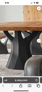

Well the table is home and the sanding begins.
I’ve tried to get quotes from 3 places on legs and it seems nobody has enough time to do them .
I thought about it and came to a conclusion that I should order them .
Let me know what you think ! Remember my Son in law is an Arborist so I picked something that looked like a Tree . If they don’t like them we can change them out next year .
glennm
Jul 29, 2009
207
I would make a base for it but that is up to what you like. I always feel if someone is willing to do all the work on the table top the job should continue with the base, but I do know other options are popular
mike93lx
Dec 9, 2013
38,025
Richmond, VA
Looks awesome.
Farm out the legs and get it done. The work required for the top is very different than the legs, so I wouldn't lump them together.
