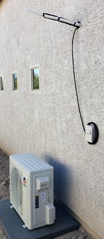

Been a while. Just got the mini-split outside tube cover installed and painted. That was a process. The refrigerant leaked out over the winter, so it didn't make cooling during the springtime. We got the installer to come out, and he recharged it, said the leak was likely at the braze joint that he did, and he said to let him know when it leaked out again and he'd rework the braze. The recharge lasted maybe a couple of weeks, and the installer kept putting us off. (Summer around here isn't time to prioritize garage AC.) I finally had enough of his putting off this job - I think his business just got so busy. This install was an after hours / side job for him anyway, so I finally just hired someone else to re-do the installation and finish it. The guy doing the rework did a very neat job, I think. I painted the cover and part of the conduit. Seems like the other AC conduits on the house are painted to where they jump off from the house wall, so that's about where I stopped.
