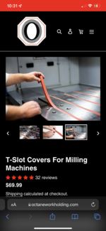

Seems the inverse of the LeonardY's could also work. Essentially a plastic strip in the T shape, flush with the top surface. Length limited on a BP so multiple sections in series.

You got me thinking about keeping the chips out of the slots. What about a 3D printed channel with some finger grips. You could lift them out and dump the chips. Here's a quick concept.
It’s a great idea. I have 3 different websites I’ve saved of that have something like this. There’s different types out there but the themes are the same - seal off the t-slots. From what I read, they work really well as long as you can seal the slots…but I’ve also read you need to make sure to clear the slots of fluid or you will get rust…and make sure to add rust inhibitor to your coolant.
I just whipped something up in OnShape that is like this. Rounded the top edges, and made the finger loop flush with the top, so things could be laid on top of it. If someone wants the .stl, let me know. My BP isn't running right now, so no way to check.
We could probably get the spacing of the arms correct for them to meet, allowing for the entire table to sit flush, with these inside. Print a few end-caps to stop chips from getting inside, and good to go.
My problem is that, on a knee mill with vises, I’m not sure I can seal the point where the vise gets bolted down to the slots. Coolant would most certainly get into the slots.
I think it’s impossible to keep coolant out. As a matter of fact, i think I might need to redesign my setup so I can clean it after running coolant every time.
