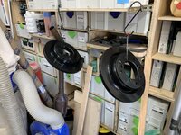

After running drilling and taping a lot of aluminum, I clean up my taps to make sure they're ready for the next go. Cutting aluminum creates a lot of heat and as a result, drill bits and taps can develop buildup on all friction edges. To get it off, I soak them in Lye. To be clear, it's nasty stuff. Read up on it before trying it at home.
Here's what a quick google finds for a description:
Lye is an alkali chemical- sodium hydroxide, also known as caustic soda. ... Lye can burn the skin and damage the eyes in the dry or wet form. It also releases fumes, when mixed with water, that can harm the lungs. If swallowed, lye will burn the esophagus and can cause death.
Good stuff. I put a few table spoons into a stainless container and then drop the bits in and let them soak for about 30 minutes.
The stuff works awesome at cleaning up tooling tho. Like new.
Final step on the arms is to machine wrench flats in them. To make them all the same, I'll add the flats to the left side. It's a 2 step process, I use a 3 flute end mill to cut the width and then go back and machine a 45 on both sides to give it a smooth finished look.
and the finished profile.
