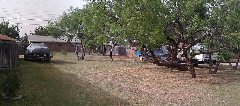

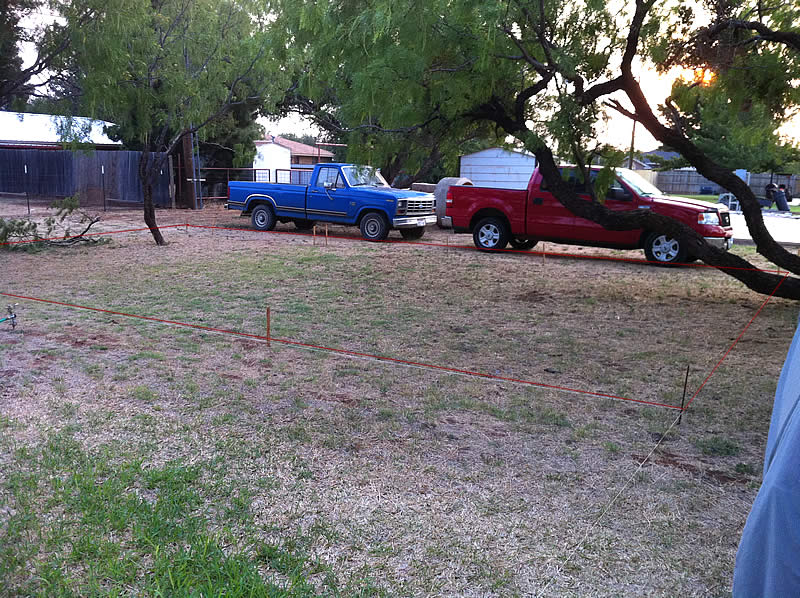

A couple of views of the site. It's nice and flat but has a few sprinkler heads in the ground. It looks like I can site the building just so the big tree loses one branch and maybe miss the little ones in the back. You can see just the corner of the 50x60 slab that the neighbor has. If they build something there, you'd never almost never see my building or the trailers, etc and that would be perfect. (They have expressed interest in selling it, but I don't see how we could afford it. Besides, the apron faces the wrong way - towards their house). our propertly line runs through the center of the big round concrete ring.
Between the fence and the trailer, about 12' in from the alley side property line. I think the setback is 5', so I can clear that easy. Besides - need room to hide the dead pickup back there. The fence would come apart and move to the building corners.

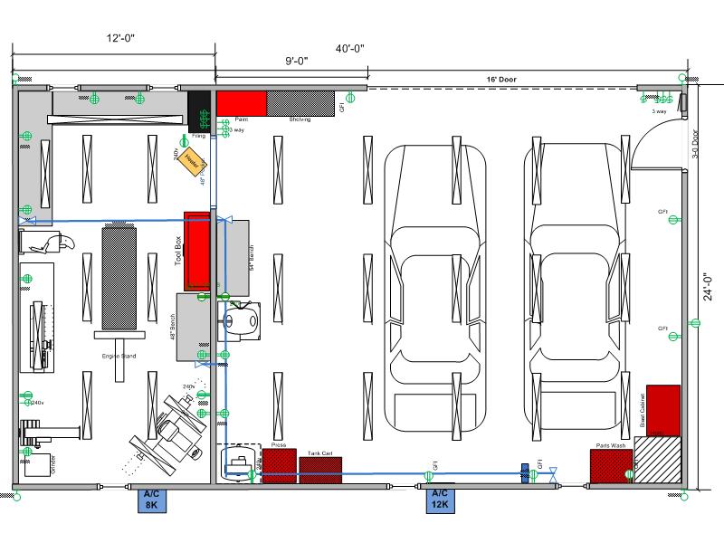

Visio floor plan - air in blue, electric in green. A/C would be wall mounted window units. Work area is 12' wide which seems like a good number. It's 1008 sq/ft, which is 200 sq/ft more than what I had. And close to the 900 sq/ft number that gets you an audience with the zoning board. Nothing to fear there, plenty of large sheds and farm buildings close by.
After a bunch of scribbles, I kept with 24' wide because it uses affordable joist lumber. Hand build rafters are about 60% cheaper on a 24' span than trusses. With a simple rectangle floorplan, do one good pattern rafter and the rest can be ready before lunch.
I can start with one overhead and maybe add a second in the back later. The ceiling over the 16' door area could be vaulted some, not sure how much right now. I'd like to have room for a 4 post, but I don't think I can get 11' 6" in the middle. I'd rather stick with 8' walls, but might consider 9 or 10. Haven't put a pencil to that yet.
The little 3 x 6 room on the end would hold the compressor, a small sink and the bladder tank for the well plus the well controls. We already have a well and the bulk of the system sits in the back yard, just out in the open. The POs never housed it or anything. It is powered right now from the far side of the house. The power and valve wiring is all screwed up so the pump control is a breaker and valve control is my hand stuck in a hole. Siting the building along the fence puts it just a couple of feet from the well head, allowing me to put the junk out of sight inside and house the controls close to the action. Most of the valves are straight runs from the well head, except for one. It would clean up the back yard nice and I'd get a bitty wash sink to boot.

I think if I was doing this, I'd install a 6' "french door" with glass between the two work areas. You get a 6' opening, and a lot of extra light into the machine area.
My first shop, somewhat by accident, I snagged a "return" at Home Depot. So I installed it and liked the extra light and opening size. So in Shop #3, I installed one on purpose.

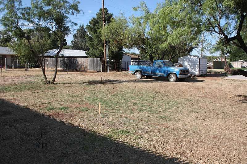

Another update - after playing with stakes, string and tape measures for several evenings I turned the layout sideways because there was no place to park the trailers. Not enough room behind the building. Nothing yet on the variance.
Les Nessman lines:
Worst part about this is the two trees in the back will need backhoe work to get out. The big mesquite in front will lose 2 1/2 branches (one branch has a winters worth of firewood). Good part is that the location is flat within maybe 2-3 inches. Trailers could park where the red truck sits as there is 23' between the building and the lot line. A little 4' fence and a couple of gates and you'd not see them from the street.

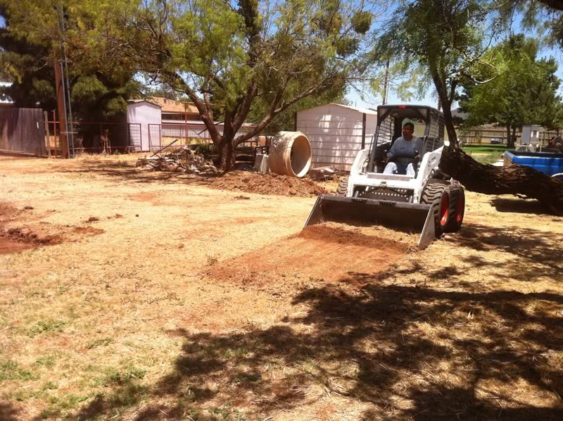

Monday this last week, was the public hearing on the variance. Our neighbor came and said some nice things about us and that he had no problem with the build. No one else spoke. Vote to approve - unanimous. Over in 5 minutes. Council meeting followed and the City Manager got the item on the agenda. Short review, no input from the public - done.

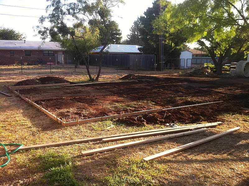

Tuesday AM - got my building permit. Called the concrete guy and got them on the job.

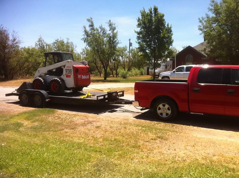

Inspection was targeted for Friday but the ground turns out to be damn hard to work in a drought, in spite of me watering the **** out of the area. So Thursday, I rented a skid loader so they could get a jump on it. Big savings having a trailer that will handle 6000 lbs of loader. One day rental with tax and fuel - $153.

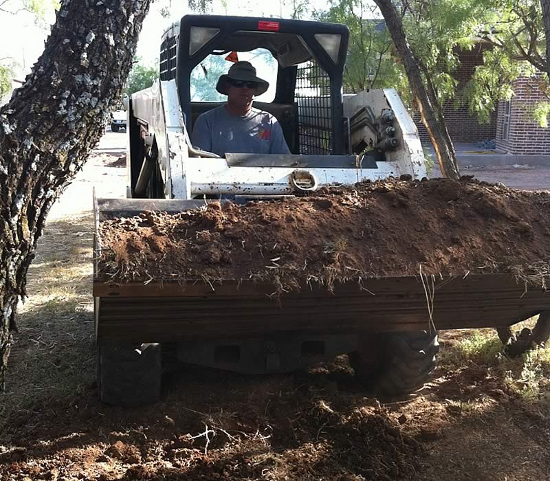

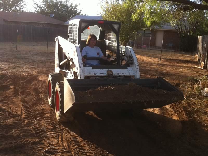

A professional running the machine.
Grandma likes the big toy.
A non-professional fills a big hole on our other property with excess dirt. Man, do I have top soil now.
By days end, earth moved around as needed.
New target - inspection Thursday AM and pour Thursday afternoon. Maybe - it's hell for these guys to work here in the afternoons, with the temp upwards of 105F. So I told them to take the time they need. My birthday is Sunday and it'd be nice to have a slab for a present. Ha!

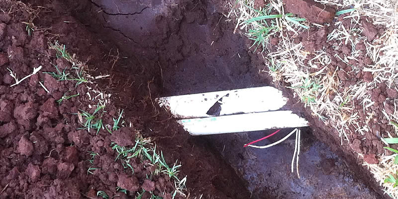

Spent 5 hours today out there - got part of the power feed ditch dug (non metallic has to be 18" or can be 12" down with 2" of concrete over it) and the lines that feed the sprinkler runs on that end of the lot cut and capped. EMT only has to be 12" but that's $200 worth of 2" tube vs $51 for non metallic. I might get that all dug this week, but I doubt it. I got enough done to put the elbow under the slab abd stub up where the breaker box will locate. Soak the ground and it turns to muck or gumbo. Dry it out and you can land a 747 on it. I'm buying a pick axe tomorrow. But I also have a $1000 Samsung dryer that just quit drying clothes. Something always gets in the way.

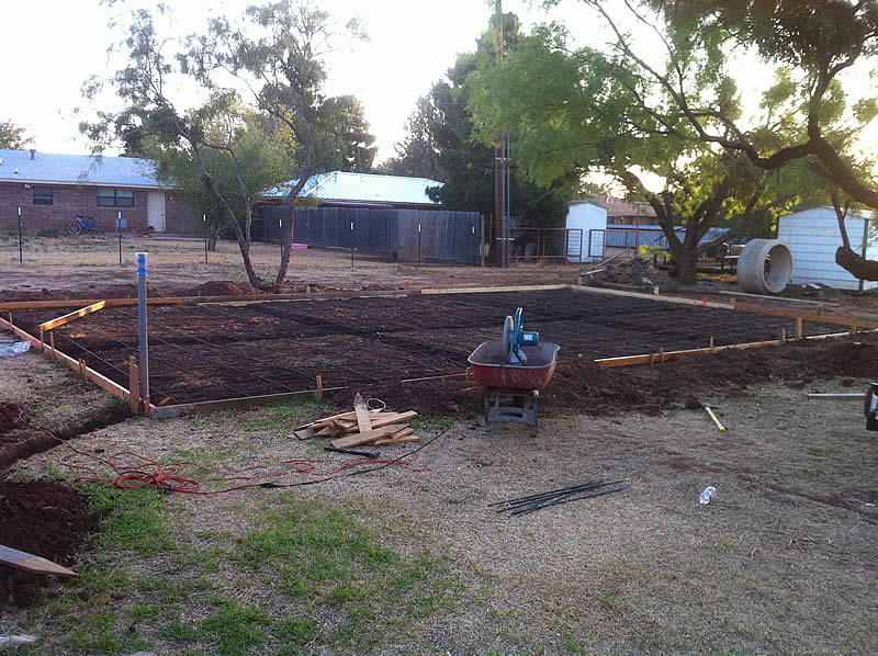

Steel goes in today, inspection is 4 PM Friday and we pour Saturday at 6:30 AM. City manager pissed me off, told him the inspector better like it because we're pouring Saturday come hell or hot weather.

Inspection passed! Here we go!

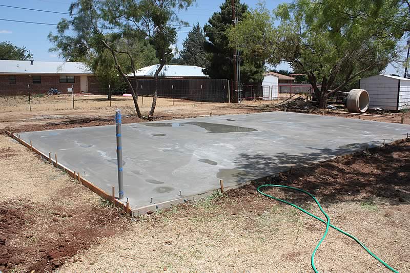

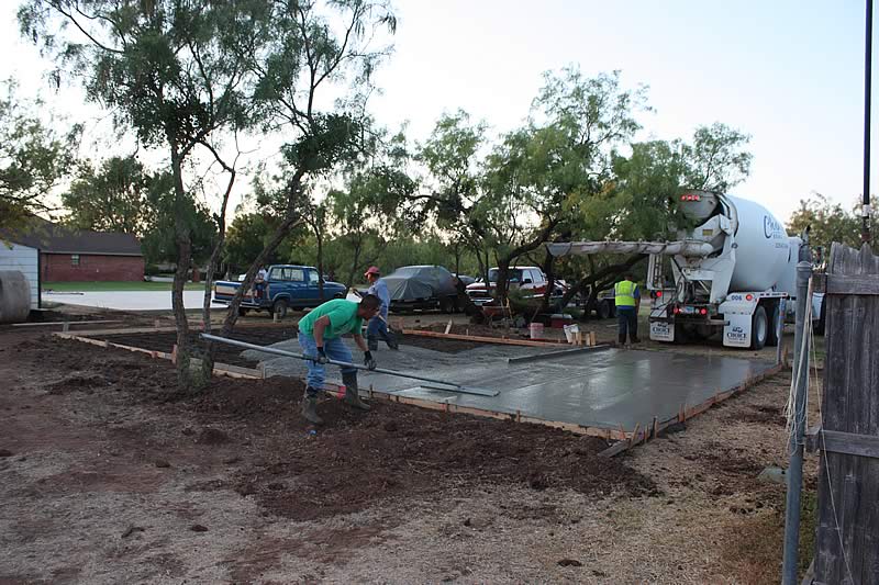

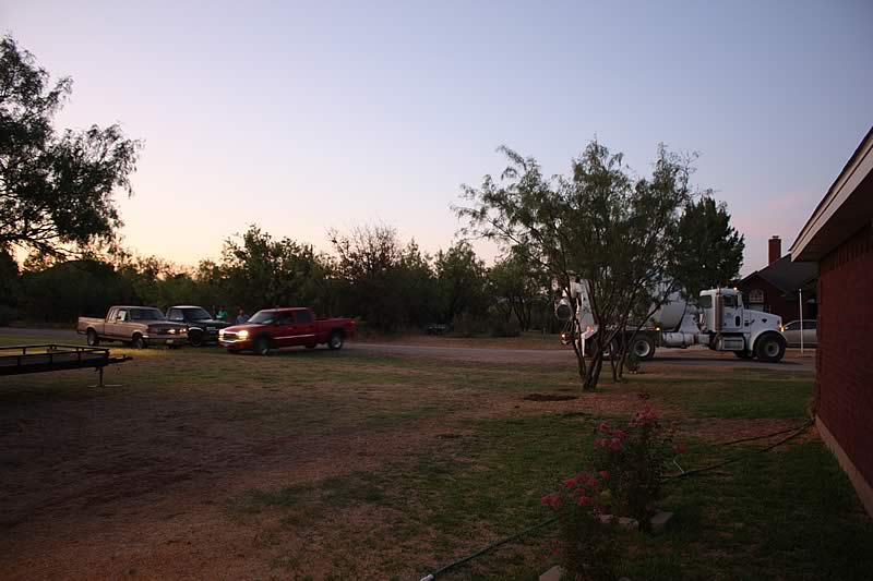

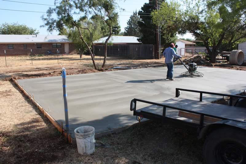

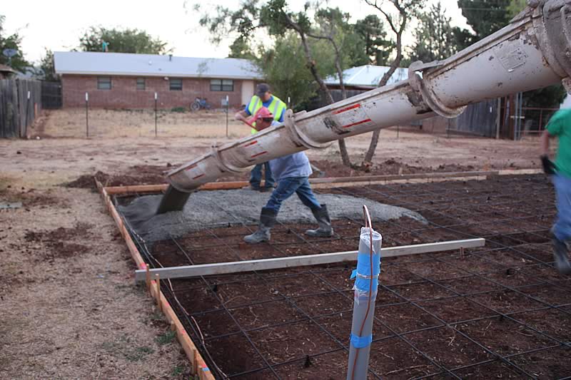

5:30am Saturday comes early. Wathed the pour, placed the plate bolts, dug the power conduit ditch, repaired the sprinkly lines, had a late lunch in town with the wife, got a call from daughter about a block party, cooked two batches of ribs for the party. Didn't get back to bed until about midnite. Wife and I got out the chairs and sat in the driveway Saturday night about 11:30 looking at the milky way, had a glass of wine and fell asleep almost immediately. My snoring woke her up and we went to a real bed. Went to the dragstrip Sunday to work on the timing system with some guys (it was 108F at the track!), then birthday dinner, then...I'm beat! Can I go back to work to get some rest?!?
They said 6:30, damn late by 3 minutes LOL
First load hits the ground shortly after. This is a 5 sack mix. My guy says 3500 guaranteed and maybe as much as 5000 in 30 days. He basically said he sells concrete and not BS.
Not long to half done
Power trowelling by about noon
And there it is. We had a problem between loads - the driver of the second truck was late. He got his azz chewed big time. Didn't really have any impact other than I waited almost too long to put in the plate bolts where the first load landed. Had to hammer them in and stuff in some mix. They are all stuck pretty good, only a couple have a little play. Nothing a spurt of epoxy can't fix. The guys were real good about pulling up the bar grid to keep it in the pour and not on the ground.

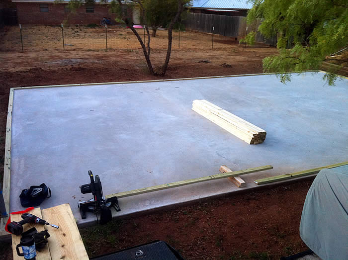

Water shows a small low spot, but it's not anything special. The surface looks good after two days and the forms come off tomorrow (Monday) night. I still have about 10~15 wheel barrow loads of dirt to move. I missed the last truck washing out in the alley, so I have a lump out there to bust up to stay clean with the city. I'll get the ground smoothed out and cleaned up this week, then finish the ditch for the power and start thinking about sticks.
They power conduit should have 2" of concrete on top by code - the next to last truck dumped a pile by the alley and I wheeled that over and dumped it in the ditch - so I'm half done there already and didn't have to buy any sack crete!

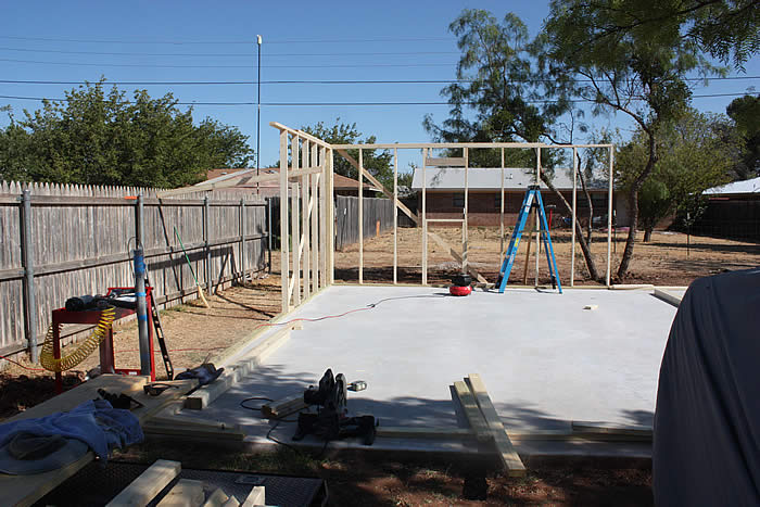

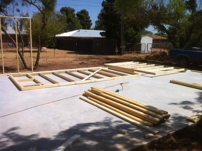

Off to a slow but at least a start. McCoy's won the price war, so they get the business. But by and large, everyone is within a few $ of each other. Ain't much there to work with. So Thursday AM - before it gets real hot - I dropped $700 at the lumber yard. Not having to pay for delivery is nice.
I had most of the plating laid out by that evening.
Friday I marked most of the plates and finished that up late Saturday AM. That's after running back to McCoys for some **** I forgot. By 2PM I had this much and had to call it - 110F air temp, about 120 something out on the slab. Heat gets to you - window got framed wrong, trimmers in wrong place LOL. Easy fix, but duh.
We kept our youngest grandson over the weekend, so joint efforts had to wait until nap time. Sunday morning I got my wife to help place and hold the first 16' of wall, then I got it cornered and free standing.

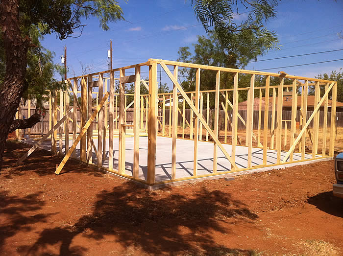

A little more time + work and I managed to get one whole one end up and stable. It's noon - 108F already and on my 4th bottle of Gatoraid (G2 Rasberry-Melon, only 45 calories a bottle - nummy) I've about had it. The heat just beats you up when you are not so used to it. I'm going to try and take some half day vacation days - work on this in the morning and go to the office after lunch. It's nice out there at 7 AM. By 2 it's just brutal.
Lookin' good.
Got to get more done this week and unload the trailer as we have a race this next weekend and nothing will get done on the shop.

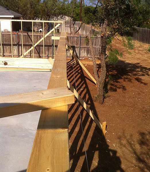

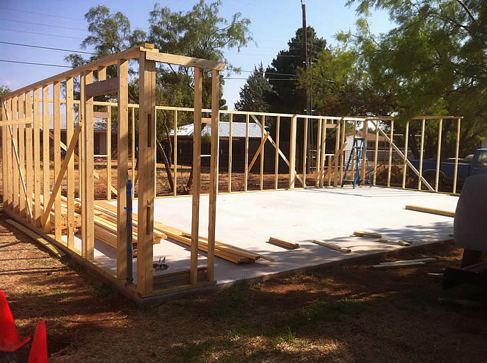

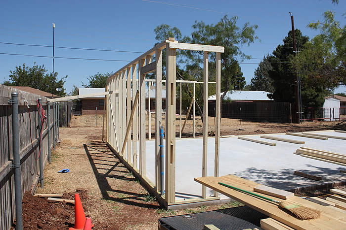

The half days are helping. Seems though that you work for a while and when you're done it doesn't look like much. 3.5 hours burned here.
I'll have to have a talk in the mirror with the general contractor about this showing up at 7:30AM and going on break at 10 AM, then never getting back to it. ;)
Ah, but add another 3 hours and bada-bing - more wall! Not bad for one guy. I suppose if I was Amish it'd be half done LOL.
String line says I got it close, even with the wonker-jawed lumber you get these days.
40 more feet of wall and I can start thinking about joists and rafters. Maybe have it up my Saturday before going to the track. Storms are predicted today and tomorrow. That would slow things up, but dang we need the rain. Real bad. This is a flareup on Tuesday, less than a mile from the house. Burnt a couple hundred acres and destroyed a railroad bridge. Special thanks to the local fire dept and the Texas Forest Service - they had it under control by the next morning. I walked 60' down the alley from the house to the edge of the field to take this pic - that's just way too close.

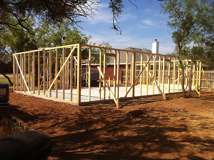

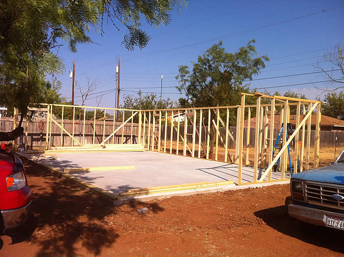

Little more progress - last of the exterior wall framing except for the 16' beam over the big door and the final top plates. Maybe get that done tonight. That last 16' section with the two windows was a little on the heavy side but I got it wrangled in there. I should get the interior wall done this weekend and maybe pick up the joists and rafters.

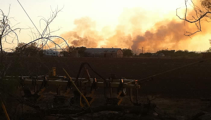

This AM was the worst of the week - we had a little rain in the area yesterday (lightning set more fires, so not that helpful) and it was humid with zero wind. gaak! Actually got better by 10:30, dried out with a breeze but I had to knock off to go to the real job.
