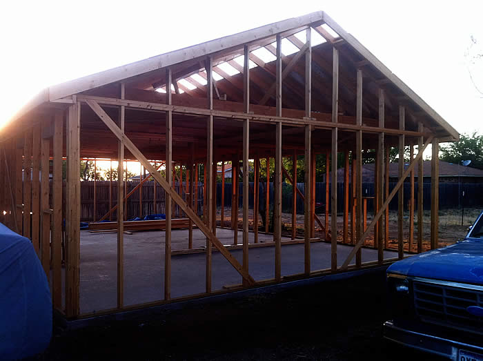

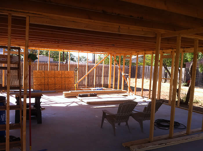

So how much more do you have to do before you start doing the roof and outside walls?
Almost there. I need to have all the eve, soffit, etc framing and the strongbacks done. Trying to get there this week so I can go get decking. The plan then is to deck, paper and shingle, facia, soffit, doors/windows, siding. Delays - It's always something - have to take the truck in Monday to the dealer to replace the right rear window lift gizmo - $370 out of the budget for that. :( Playing hurt with a tooth losing a filling and exposing the nerve. Dentist on vacation for 2 weeks, then that'll be another $300+ easy. Self insured on dental - double ouch.

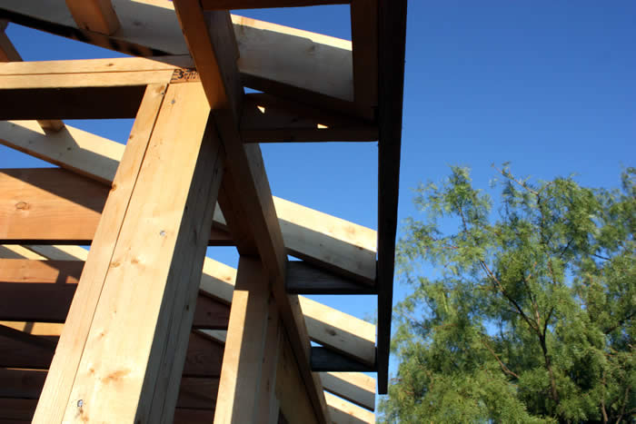

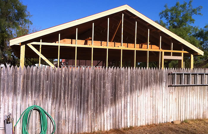

Got a lot done this weekend - the gables are all framed out for soffits.
Started on the long wall soffits, but I'll need more 2x6s to finish there.
Corners - err, cornice returns - framed.
Strongbacks started - trying to get all the "up" work done, then finish the lower soffits.
All work and no play makes Chris a hungry boy. Break time or Sunday supper. Chew on the left side and it'll be OK, :beer:

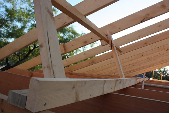

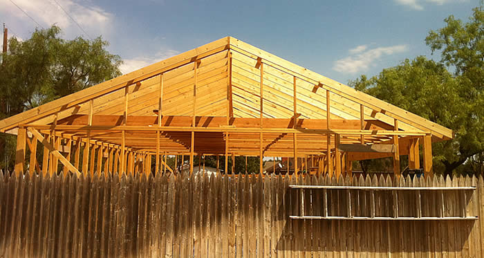

Extra bracing to help support the rafters and keep the rafters in line (more or less) and the joists in line and on even plane (more or less - try telling a 2x12 where it needs to go, especially if it's bowed). Several of the rafters are bowed along their length and 24" OC spacing is going to be hard to maintain on every rafter. Houses around here use them a lot - these are copies of what's in the attic of the house. Usually the base would lay over a wall but my joists are so big it doesn't really matter. Makes for a strong roof and gives the not so true 12' 2x4s something to do.
Some good roof info here:
http://www.nachi.org/roof-framing-part1-2.htm

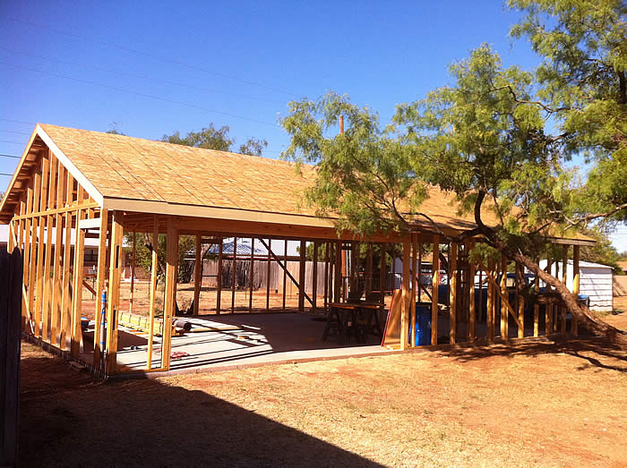

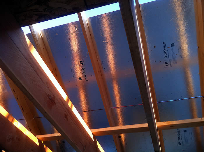

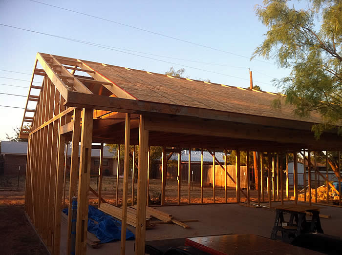

Now we're in the "woofin' bidness" (from a local roofer commercial). Got most of the deck laid and secured Saturday, Sunday. The last 5 big ones went up Monday. Wife hoisted off the trailer and I drug them into place. The only thing worse than teetering on a 5/12 slope of decking hanging on to a big 4x8 piece of OSB is teetering on a 5/12 slope of decking hanging on to a big 4x8 piece of OSB with a charlie horse in both calfs. That was the closest I came to coming down without the ladder. Should finish up the deck tomorrow. The goal is dry in by Sunday. Heading to Lowes tomorrow for a roll of TriFlex and 30 lb felt plus a box of coiled roofing nails, then to McCoys for a few sheets of 1/4 x 4 x 8 Hardi trim material. Will have to rip my own facia but it's about 1/3 less than buying pre cut. Besides, nothing is standard dimensions on the eves anyhow. :)
Started 3' in on the west end because the spacing just didn't work out.
Sunday readings - top surface 134F, inner surface 108F.
There's work on the west end but only 4 cuts to trim out the east end.
No, it's 27" to the ridge, not 24 dammit. But I have enough sheets left to cut the odd sizes. Or I need a 5' wide ridge vent. Oh - and I'm on my SECOND box of 1000 count 8D ring shanks. Whoda thunk it.
Gotcha, some what similar to a knee wall. Good idea with those long rafters. :beer:

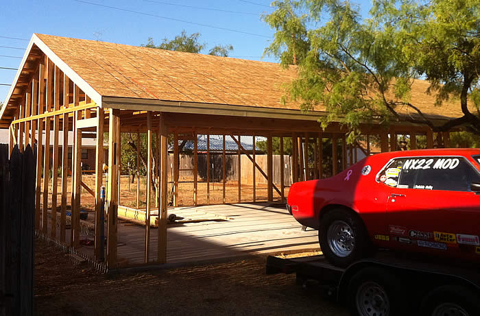

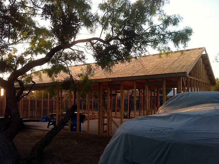

Decking completed!
A little shade to work in at least. Well, except for the shingling. I was cutting a lot of HardiSoffit in there yesterday and it was nice not to be out in the sun so much.
Facia trim finished Sunday just in time for dinner. No problem cuttind the Hardi, it cuts clean with a carbide tipped blade. The soffit stuff is only 1/4" thick and kinda fragile. Slicing it up creates a TON of concrete dust. I think the dogs have lung issues now. I cut up about 4 4x8 sheets into 6 1/2" facia covers and 2 1/2" trim pieces. Lots of cutting. Piles of dust left too - looks like I emptied a fireplace full of ashes on the floor. But it looks good with only a few oopies. Hey, that's why they sell caulk.
Monday - flash and paper. Then nothing for a week due to other commitments.

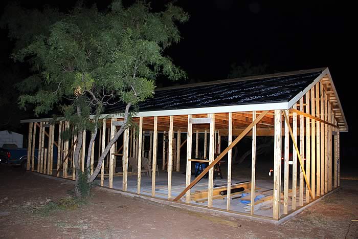

Got some flashing on and three rows of TriFlex in place. Should be all black tomorrow.
Another night shot for fun.
