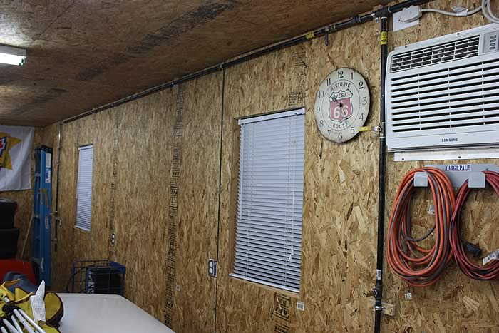

The iron isn't too bad. Since it all came out of the old shop, I have to take the sections apart first, so it's kinda double work. I used a lot of odd length pieces, elbows, unions and joints to make it work in the old place so I have LOTS of pieces for the new jigsaw puzzle. I could plumb a bath like the 3 Stooges real easy. I use 5-7 wraps of teflon tape on the threads and coat that with high pressure teflon sealer. This works well enough with the chinese fittings. I put the sections together on the floor and then just lay them up on the wall. Since I have lots of unions, so it can come apart fairly easy for repairs or "changed my mind".

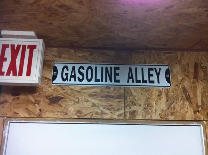

Good stuff, Chris. If I'd seen the Gulf sign it might have ended up in my truck.
I'm adding security screws right away... :lol:

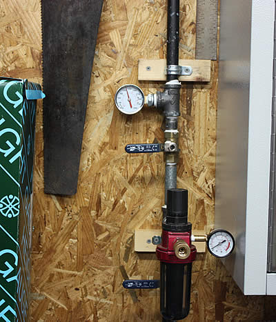

Finished up the air line runs, so all that's left is to build the rest of the closet. Sometime LOL. Have to think about how I want to set it up for access to the compressor and gate valve without having to move everything that will get jam packed around it.
The run to the far end stopped a little short of plan. I was shooting for another 4' of run. I had more pipe, but ran out of unions of all things. I would have had the union, but didn't have the 18" of drop pipe I needed. So I called "good 'nuff". After all the layout work and using all the existing pieces, I ended needing one more gate valve because I used one of the remaining pair for a shut off on the long run. It won't get used much, so why store air in there. Just bought the gate valve well before I ran out of unions.

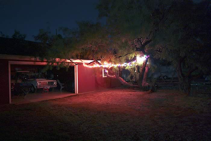

We treat the place like our covered patio and sit out there relaxing on many evening, so I added some patio lights.

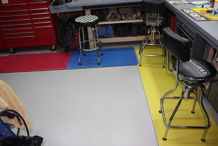

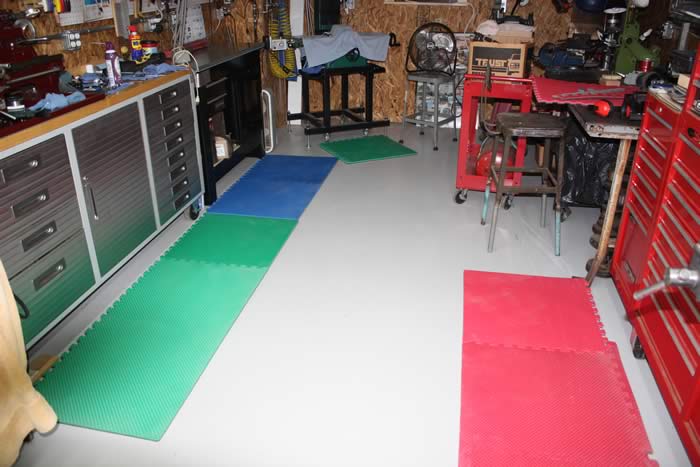

I forgot to shoot a pic of the floor - I'll update and show you how I added some color to the work area.

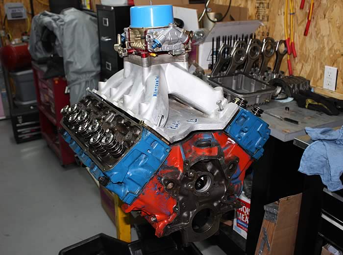

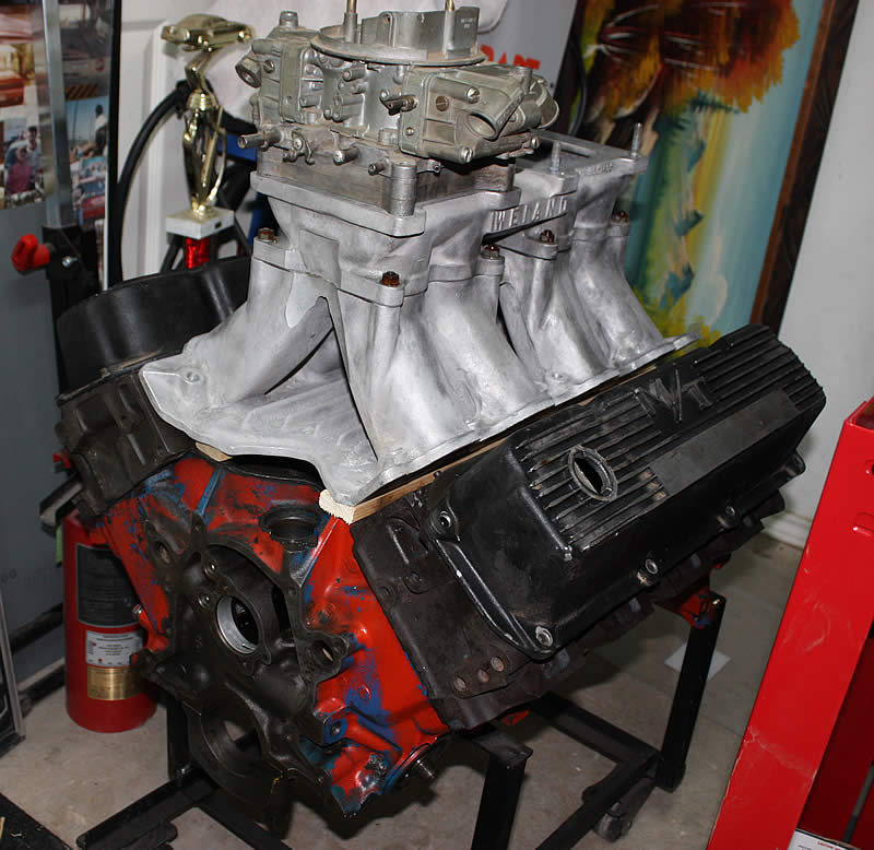

I notice a few tall intakes under the work bench, whatcha got down there ?

Intakes: Mostly 351C stuff - one tunnel ram and the other is a 4V Funnelweb from Australia. The Funnelweb is off my old 4V engine. The heads are under there too.
I was thinking this -
but will probably put those pieces on the Mustang so the wife can go faster. Those parts should put that car in the 7.0x~7.2 at 95+ in the 1/8 mile.
The T-ram is an eBay score, NOS on the shelf for 20 years. That thought looks like -
Old school

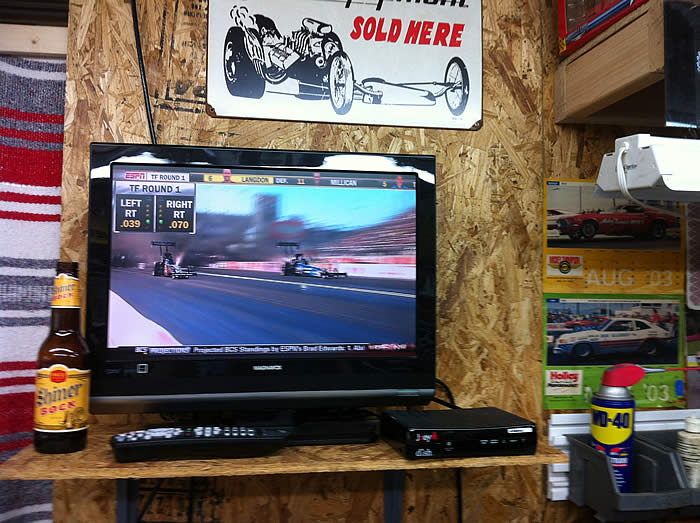

We got us a couple of Dish Hoppers now. So I ran a little conduit, pulled some RG6 and the shop got a Joey. I'm watching, I ain't goin' joggin'.

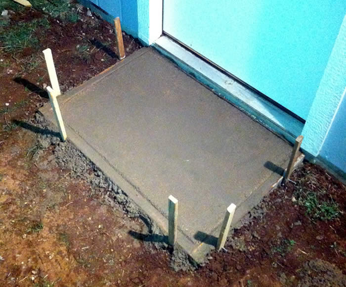

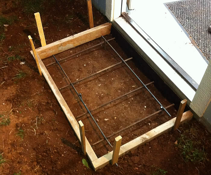

I finally upgraded the 2x3 piece of Hardi laying on the ground in front of the man door -
The dogs love it and tend to argue over who gets to lay there on these warm afternoons. I sweep it off and by the time we get home from work it's covered with dog prints.

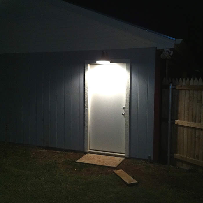

Since I made a real porch, it needed a porch light. eBay fixed that need after a few weeks of watching barn light auctions. Got this one for $45.
Some leftover 1/2' galvanized pipe and a flange makes a mount:
I wired in a motion sensor for it, pulled power from the breaker panel and wired in a control switch. Glad I used OSB since I had top pull off several panels to get to all those spaces. That made for an ugly square above the door, so I covered it with a sign. Will find that pic later today I guess.
Turned out pretty good I think.
Motion sensor is under the motion lights on the right side of the pic. Come out the door and there's light to lock up and walk to the house. Nice.

No refresh, the light came as-is. Description said it was original and as-is. Looked pretty good, seller had decent pictures. It had a ragged 2 wire cord on it, like it had been hanging from the cord in some previous life. It's got a small mark inside the shade and a little bit of rust and chipping on the bottom edge, but in all it's a real nice piece. Looks like it spent it's life indoors. It came up one evening on my search and I jumped on it quick. Made an offer, got an accept overnight and paid first thing next morning. Haven't been able to track down the vintage yet.
I rewired the socket with 14-2. To ground the shade, I looped the copper around so it would be pinched between the socket and the cast aluminum mount by tightening the two mounting screws. No provision for a ground wire on a vintage ceramic socket. Hard part was fishing 14-2 through that 90 on the pipe.

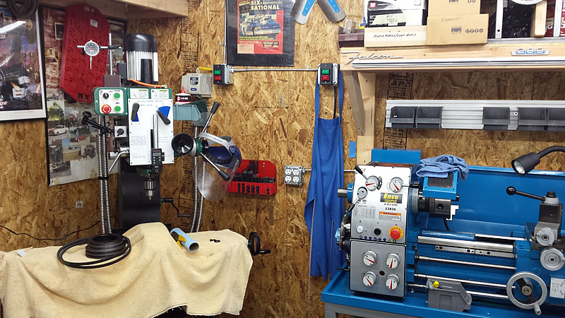

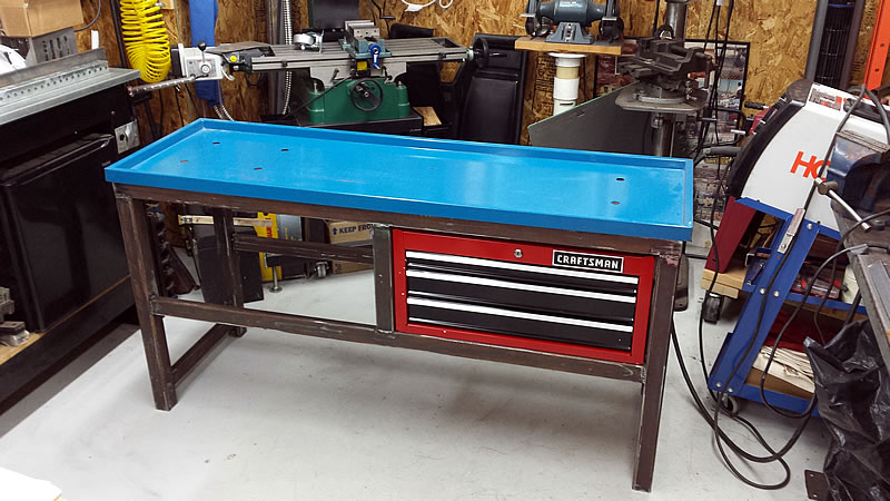

Yes it is a HF 9x20. Since I'm here and you asked, I recently built this
To land this
Had to rearrange the tool room to park the new tool.
