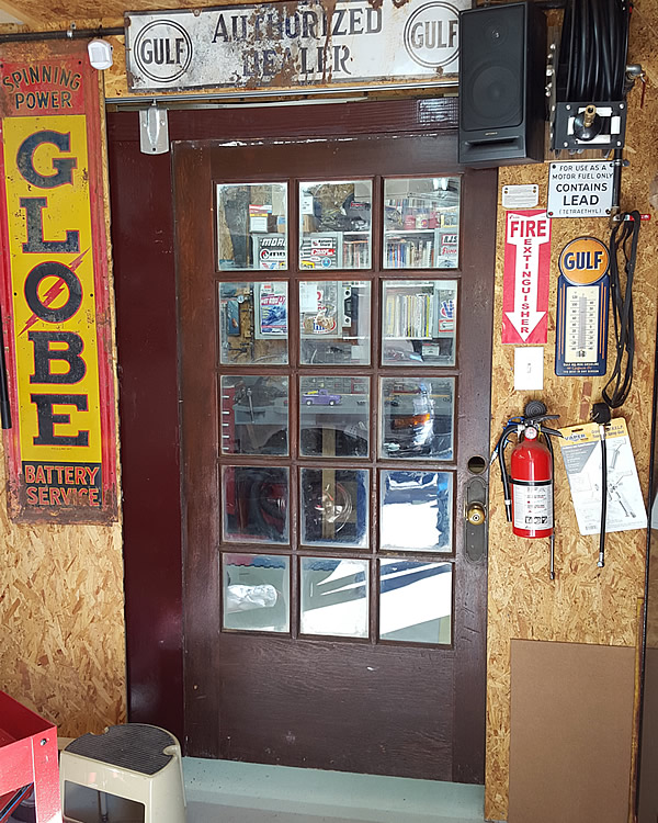

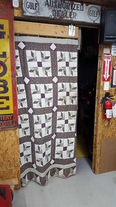

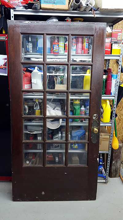

Latest small change - finally updated the work room door.
Before, as it was -
Stopping in at the Habitat Restore we saw this and had an idea.
Bought it and 1/4 of a old closet bi-fold to fill out the space. Top is a 2x4 spacer. A little brown Rustoleum and now I've got a real pocket door. the only bad thing is that someone painted the other side of the door with white paint. I might try stripping it later on. The white side was out where they had the door sitting against a rack which is why the first look was "meh". Then I looked at the other side and it was "got to have it". Also wish there was a matching brass door lock plate on the other side - but no. Have to keep an eye out for one. I have some but they don't fit the style of the knob set.

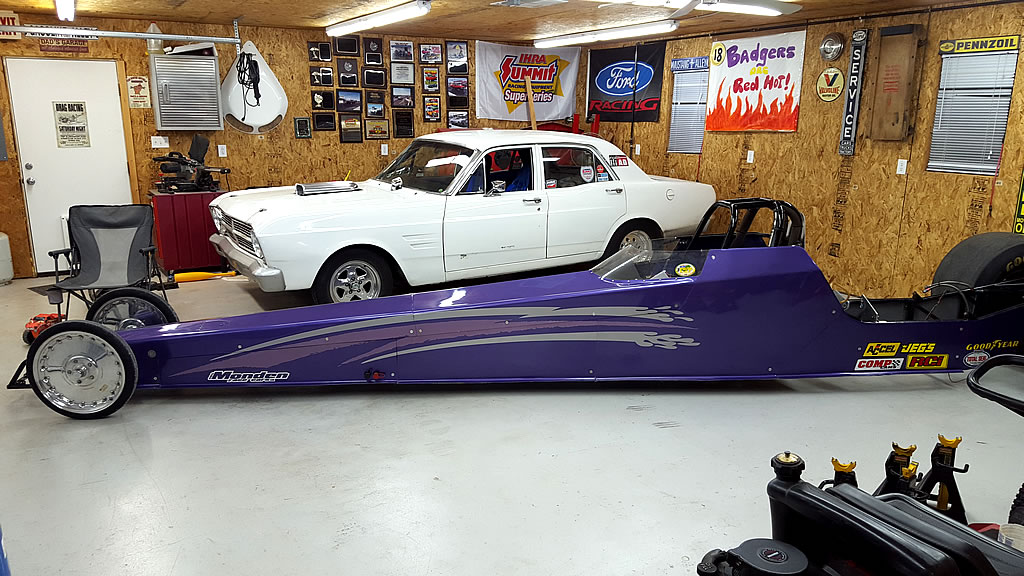

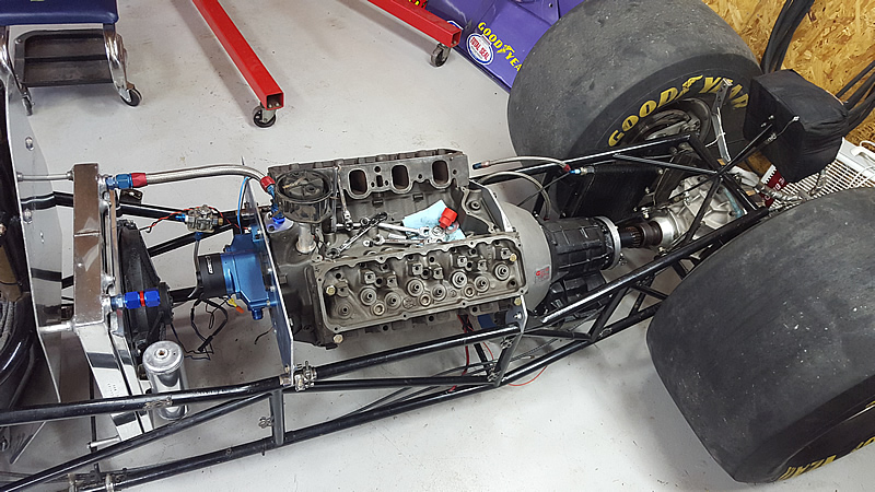

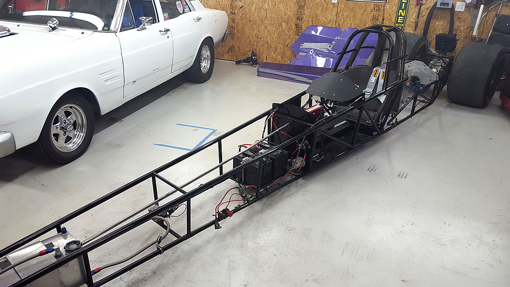

When 24' becomes too short LOL
Pro built chrome-moly chassis, should cert to 7.50 in the 1/4.
Easy to work on for sure
It's getting a 351 Cleveland, of course, mated to a shorty Glide. Still in the mock up stages and engine build. It's for "me" - that is, until I get it running then re-set the pedals so she can make some passes. After she takes a couple of hits....might be back in the family sedan again. :lol:

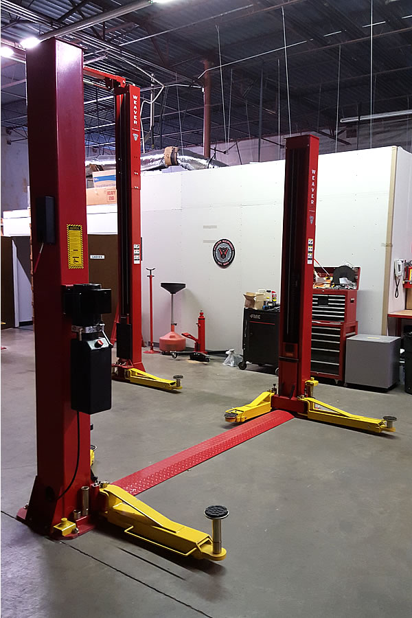

350 miles with the trailer, nice lunch at the Weatherford Waffle House and here it is. Groovy, will unpack and check the parts. Have to run by HF to get a couple of more furniture dollies for the 2nd post. Looking at the calendar, if I get one post stood up in the next 60 days, it'll be a miracle.

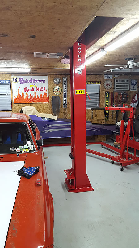

Both posts in place, more or less.
Grab the post at about the 6 1/2' mark and after a bit can just stand it up with a little effort.
Exactly 112.25" between the posts. Still have to shim and bolt. They are pretty close to plumb in these spots.
About where the typical race car should balance. Still debating the final position but this is likely the best compromise in the space.

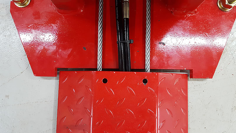

Posts anchored finally. Only two holes had 4", the rest way more - most holes 5" with no break through. There's one front that pulled a little above the 2 1/4" limit but all are holding torque so not worried about that. In a Catch 22 - have the lift cables installed, but can't install the safety release cable until I can release the safety catches. Will have to wire and prime the pump to move the carriages, then finish up the safety cable release.
Also have to work out an anchoring setup for the floor plate - nothing provided except a couple of holes in the plate. Thinking about a bracket that clears the cables and bolts to the foot plate.

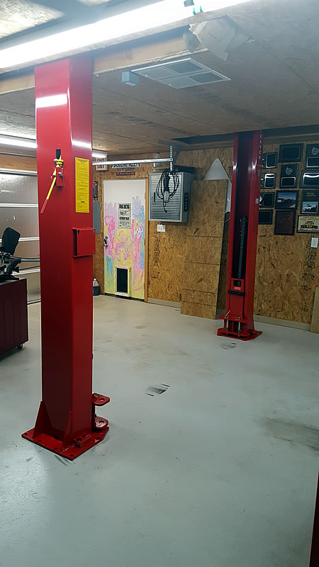

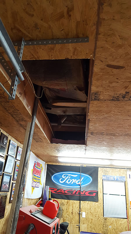

Lift is now operational.

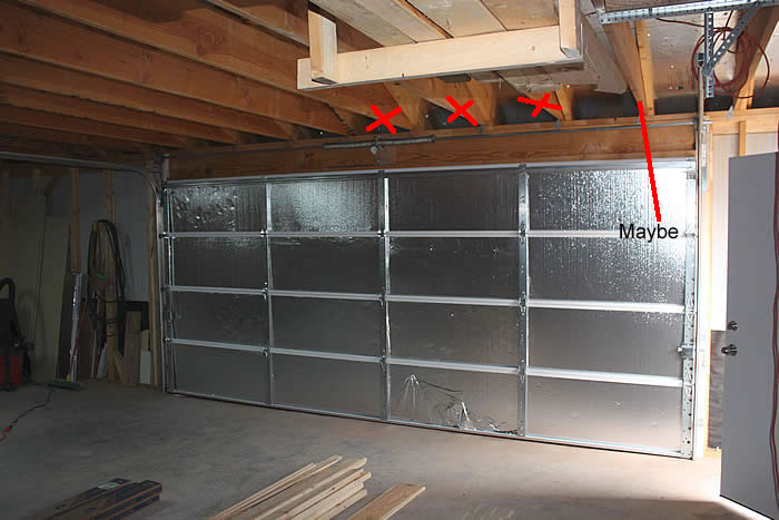

With the ceiling still in place, I can get 49" of clearance. Just enough to roll under. The wheel base is 108", did not have to move the car around to swing and set the lift arms under the car.

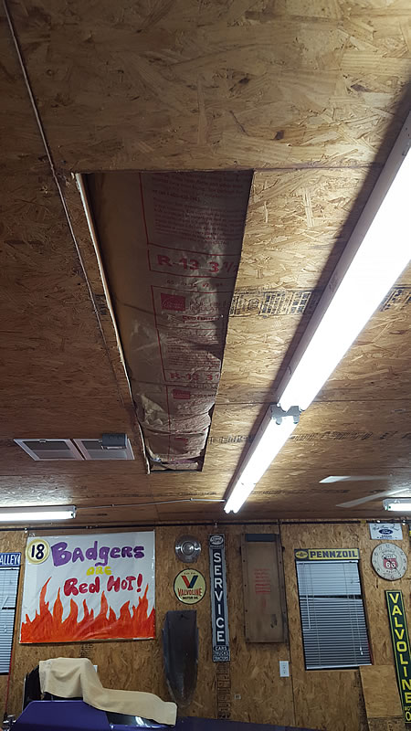

Still thinking about the roof. Basically I'll get plenty of clearance to get the cars up 73" by putting in some collar ties 36" above the existing ceiling (well into the upper 1/3 of the rafter locations) and plating off the exposed rafters with OSB. I may also decide to slide one of the existing joists over to the joist in front of the right post (middle of the shop) and turn that rafter/joist pair into a giant truss to support one end of a 4x12 ridge beam for insurance. But pulling out 3 joists should not really cause any stress on the roof. We're at about 7 lbs sq/ft and adding OSB under the rafters would add 2 lb sq/ft, total around 9. Basic design load is 10 and we don't get snow loading here. No storage over the lift area either (not now and won't be any room later) so no live loading.
At a minimum, would lose these joists - maybe cut the left most one loose and slide it over to the left to double the next one. If I do a beam, I might take out one more on the right. It's close to the door of a car up on the lift.

If you can, make the opening at least as wide as the hoist opening, or as big as possible. I had a hole cut big enough for cars, but after you crush your first van/truck mirror you will wish the opening was bigger.

Nah, I knew going in that if we ever got a lift I could make changes if needed. We built it, we can take it apart! If I really had any $ I could pour an extension and take the back wall out another 6' and re-run the rear rafters to create a lot of space.
I'm considering that, in a "one time ceiling mod and done" sort of way. The three joists are pretty easy. That last one is a ****** because of things running down that side - electrical, roof bracing and such. If it got to be a problem for areas near a door, I could notch it out - if I decide to run a beam.
The way the hoist is positioned it would be hard to use it for one of the trucks, more than just something like tire rotation, brakes or minor under chassis maintenance that was a one day thing with the truck up maybe 24" or so. They would hang out the door when balanced on the lift, for sure the F three-fiddy. F150 is 19' long, the F350 is 20'. And I mean every bit of 240" from the receiver on the back to the center of the license plate on the front bumper. I might - maybe - be able to close the door on the F150. The 350 will only fit in the shop if backed in so that the rear bumper rests against the back wall. So any position that would let it be lifted will leave a couple of feet of bed hanging out the door.

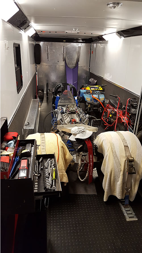

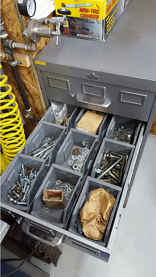

Scored a card file for use as a bolt bin. Zero cost, found in basement rotting away. Eventually I'll need to put a square tube base on it and cut the rot off. A chuck falls off the bottom almost every time I close a door LOL. Freed up some wall space. The bin are the gray items Sears sells for use on their VersaTrack.

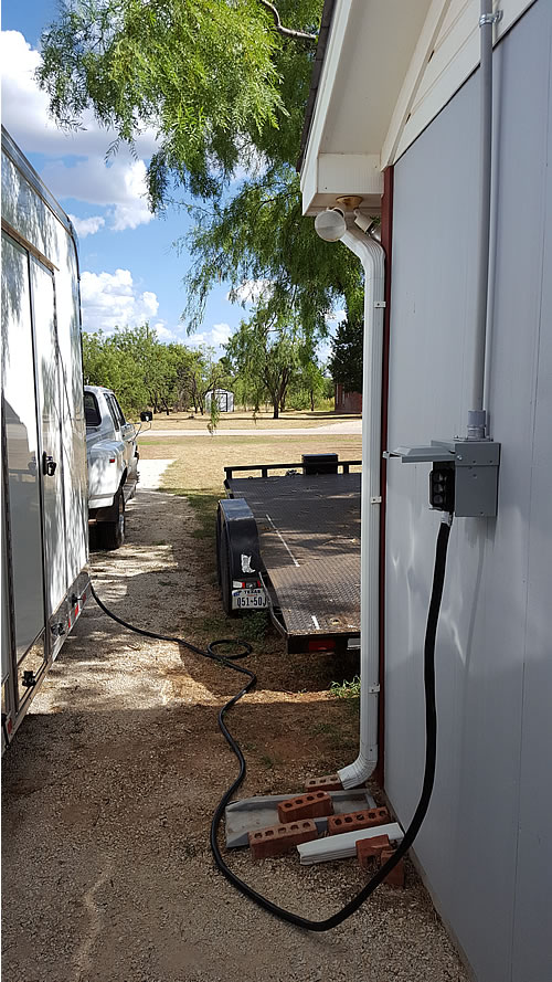

We bought a new race trailer this year - the 24' was pretty full with the dragster and support equipment. Plus we wanted a bath package for traveling to races and staying in the trailer. New 34' trailer finally arrived - so I added an RV style plug outside and now I have a separate dragster workshop on wheels! With AC too. And a potty LOL.
Told my wife that this trailer just proves that I need to make the shop 30' deep. "How much?" Thinking - even a lean-to addition with a 7' ceiling in that last 6' would be more than fine.

The new trailer is great - stayed in it the last two day race as practice for the finals at Texas Motorplex. Genny (6500 Champion) uses about 5 gallon for 7 hours with AC at full blast, lights, water pump and cooking. We did discover last weekend that the AC unit and all the plugs on the right side (looking forward) seem to be on the same side of the line. Battery charger on 40A outside +AC + microwave tripped one side of the 240 line. Got to get into the box and sort that out. Still looking for the right 26" tool box to park in the trailer.
