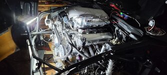

My original 1995 Cobra vert with 31k miles. Was 100% factory original then got a full Maximum Motorsport suspension, Dart 348ci, AFR185 heads, 76mm turbo, T56 trans, full Holley Dominator ECU, etc, etc, etc. This made 750rwhp at 5,000 rpms with 10lbs of boost and zero timing on 93oct. We couldn't keep a clutch to hold and couldn't tune past it.
Then I got the itch and bought a 1994 Cobra coupe. Stripped it down to the shell, used it as a roller, welded in a 12pt Chromoly cage, mini tub, tube front end, etc. I pulled the motor from the vert and went to a 4R70w trans with transbrake, it went into the new coupe (racecar). Since then, I bought a pair of 76mm turbos and hotside that will swap out the single. And the racecar got a ton of other updates....basically built another car when the original plan was to just move power plants over and run it.
My wheel cribs that built all of the vert and most of the racecar before I bought a QuickJack 5k.
Yes the roof will be welded back on but once we get other bugs ironed out.
Before the plumbing and wiring began
Most recent I could find. Was testing out the under hood service light strip. There are several lights like this that run off a Milwaukee M18 battery so main battery can be killed and still have light at night in the pits
