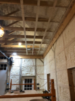

A few of the finished product. Ended up with about 7" in the walls since they just filled the bays Roof was sprayed thick enough to get to R40. They blew in fiberglass behind the section that was already finished, no holes in my ship lap needed!

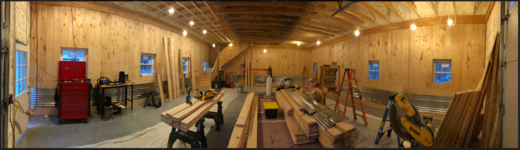

Cooking with gas today!! We are down to needing to finish the last wall, where the garage door is and we'll be done! Still lots to do after that, but getting closer. I definitely reduced the pile of wood and made some room so I can get the rest of the strapping up!

I think I am leaving it natural, that is the plan anyway as of now. Got a few more boards hung last night and tied in my first electrical box!!
A keen eye will notice the snake up in the ceiling......someone forgot to run low voltage wires for the 0-10v dimmers on the low bay LED's.....:rolleyes:

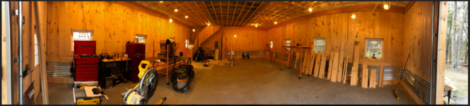

More updates!!
All the walls are done! I have one corner that for some reason didn't line up, so I need to go back and do some strategic trimming to make it look right. Other than that all the strapping is up, so this week after work I'll start picking away at the rest of the recessed lights and the UFO LED's. I was told the power company would be by this week to set the meter and tie in the lines at the pole.
