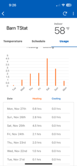

I don't know if I can justify in-floor heat....but this certainly helps! I'll definitely have an insulated slab, but not sure about the radiant. I'll be interested to hear what your utility bill is.

I don’t know what it will cost yet, but here is the usage so far this past week. The slab is currently sitting at 63 degrees.
