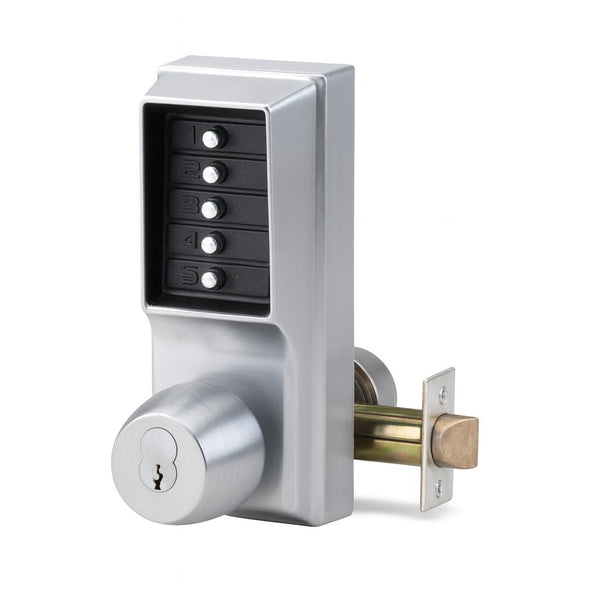

My wife is legally blind need a fingerprint door lock system to replace the keyed handle deadbolt.
Bought one off Amazon piece of ****. What have you had good luck with?

Fingerprint readers can be pretty unreliable. And being electric they're even less reliable. Could she use a combination lock with buttons like this?

could you do a pin pad lock? one that has the braille on it?

I'd suggest a key pad lock, she only needs to remember what positions to push. The thumbprint reader I got was a pos. It worked on large thumbs only, not the kids, or the wife.

I’m in the lock business and there are no reliable residential fingerprint locks sold. We sell higher end commercial stuff and even that isn’t impressive. I would recommend the Schlage BE series deadbolts or the FE series knob/levers. They light up, but the buttons are easy to make out by feel.
