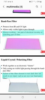

i wont speak to every adf on the market except to say that some are far higher qaulity than others. heres speedglas very own words regarding their filter and if it fails to darken ( aka arc flash ). ive highlighted a couple areas

so i wanted to try a experiment. its called the tv remote control trick where you press the power button and see if it triggers the lens. for the test i used a speedglas 9100xxi. it has 3 sensors . 2 in each bottom corner and one in the bottom center. its sensitivity settings are 1-5.
setting 1 : remote will not trigger the lens
setting 2: 10% of the time the lens will trigger
setting 3-5: 100% of the time the lens is triggered
i then covered all 3 sensors. actually i covered the entire bottom half of the lens. first with a piece of paper. then i switched to a piece of cardboard material. lastly i tried a kitchen oven mit.
setting 1: remote will not trigger the lens
setting 2: 1% (almost never) of the time the lens will trigger
setting 3: around 50% of the time it will trigger
setting 4: around 75% of the time it triggers
setting 5: nearly 100% of the time the lens triggers
i ever went a step further and covered the entire lens except for a very small sliver at the top. on setting 5 it still triggers nearly every time. how its detecting the remote signal with all the sensors coverd ,im not sure but it does it

well this test puts it all to bed and no further investigation is needed far as im concearned. covered all but the top 1/2" with aluminum foil and proceded to weld some beads. you heard that right. i said welded. triggered 100% of the time in all sensitivity settings. ( setting 1 however did have about .5sec trigger delay after arc was struck , i didnt even expect it to trigger in setting 1 actually but it did ) .
also tried the same test with a optrel covered completely except the bottom 1/2". it triggered every time as well in all sensitivity settings. ive marked the sensor locations of both helmets
