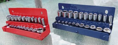

I have several flip style sockets for lug nut removal as well as the new Lisle flip sockets that have a hex on one end and a twist pattern on the other end. They all came in different plastic cases. Since the 1/2” broach for these is midway down the socket, there is no way to store these sockets on a conventional socket rail. I don't have access to a 3D printer for something custom. Do any of you know of a socket rail that can accept these style deep sockets or do you have any suggestions how to store them together?

If you can't find a 3D print, and you have room tall enough to store them standing up, you could make your own hanson-style holders for them.
If you have access to a welder you could fabricate your own out of rod or bar stock or just cut the heads off some nails and weld up some Hansen-style trays yourself, sort of like this guy did to make his wrench racks using nails and sheet metal .,..
And don't know if this might work for you, but it does for me. I've been making Hansen-style holders, of sorts, out of wood. The black-stained wood holder with sockets on it is a test piece for the newer unfinished ones I've recently been working on. The wood stained one on the right is one of the first such sets I made back in the late 90s.

I have 15 different flip sockets, so to conserve space, I figured a rail would take up the least real estate vs a tray.

I keep my flip sockets and the tuner sockets in a plastic stand up tray that came with a different socket set. Sorta like a molded hansen tray but without the pegs.
I put a bit of magnet tape under it to keep them in place.

Make a vertical stand for them out of wood or metal.
I done one for some deep 1/2" drive impacts that live in the barn mounted on wall out of some offcut old hardwood and dowel .
Mock up the layout and drill holes for glueing dowel as locator pegs ( you can make the pegs long to work with you double ended sockets) .
I oiled my wood rail but they look nicer in a toolbox if lightly coat them with black satin spray can paint .
Cheap and quick to make .

Excellent idea @Mr_B . Easy to make and effective.

Thanks for all of the replies. You have shown me that have some options. I have no room left in the wide draw so I am trying to minimize the space taken up to put these sockets in another drawerIMG_0016.jpeg
