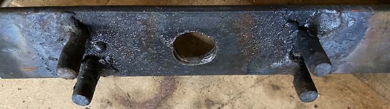

Holy moly there was a heck of a lot of torque on that tank nut!
First I tried the trick Paul came up with in:
https://www.garagejournal.com/forum/showthread.php?t=232242&highlight=blackhawk
But the pipe wrench kept coming off when I put enough torque on it, so I resorted to quickly welding up some 1/4 steel pins onto a piece of 1/8" stock I had on hand, and using a 1/2-20 bolt to thread it into the end of the tank to keep it from coming off:
The bolt on the jack was too long, so I grabbed one from my local hardware store. The shortest I could find was 1", so I used a few washers and made it work.
Have no idea how I'm going to torque it up to the right amount or what the right amount is. I *think* I read 650 ft-lbs on another thread...

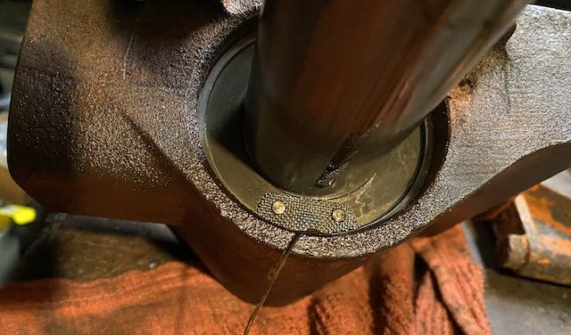

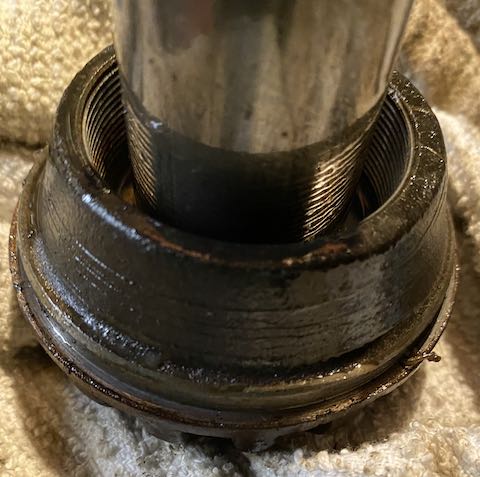

Not that bad. Looks like the plunger ring/cup fell apart, but otherwise ok.
There also appears to be something falling apart where the cylinder meets the body. I assume from your comment about the reservoir to the body means I need to take that off. Tips on unscrewing it without marking it up?
I suppose I need to rebuild the pump too.
Are you talking about that stringy thing in the lower part of the picture? Someone may have rebuilt it prior and used some sealant. If you're asking whether you should remove the cylinder, I would say no - it's torqued about as much as the tank nut, and there's the danger of distorting it. If you can get the inside of the cylinder clean, there's really no reason to remove it. Now, given that the ram cup disintegrated, you'll need to do a thorough job of cleaning. That would entail opening up the release valve, the working valve, the pump, and maybe the overload valve. If you muck with the overload, the recommended procedure is to tighten it down until it stops, while counting the turns - that way, when you put it back together, you'll know where it needs to be set. I suppose, if you've got calipers, you can measure the depth to the adjusting slug and go by that. Yes, you should rebuild the pump, as well. In fact use up all of the "soft" parts included in the kit.
The stringy thing is what I was referring to. Wouldn't that have come from someone removing the cylinder in the past?

The stringy thing is probably sealant residue from someone having removed the reservoir, which is the large diameter thin walled tube that came off when you unscrewed the tank nut. The cylinder is still screwed in to the hydraulic block, that's where the ram lives.
There are potentially, pieces of that ram cup throughout the hydraulics, you really should flush it out, or you may be doing this twice. You could probably use mineral spirits, whatever. If you use something like alcohol, remove any rubber or leather parts first. You can disassemble it - you won't need anything that's not included in the kit.

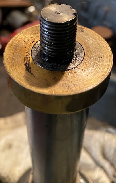

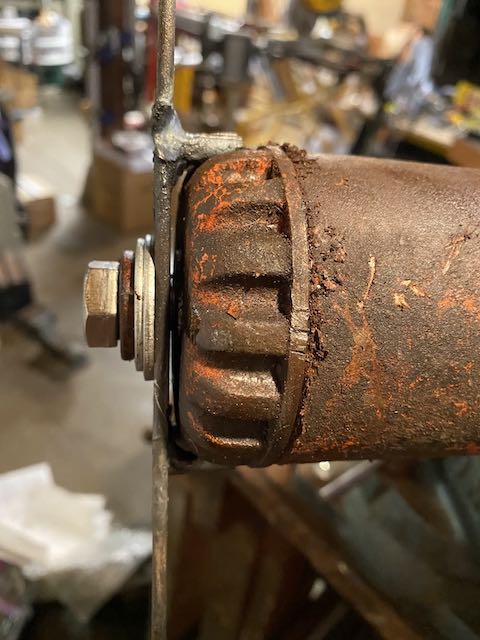

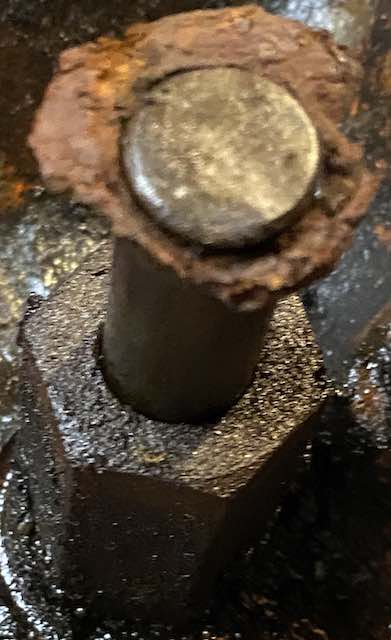

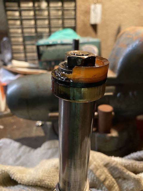

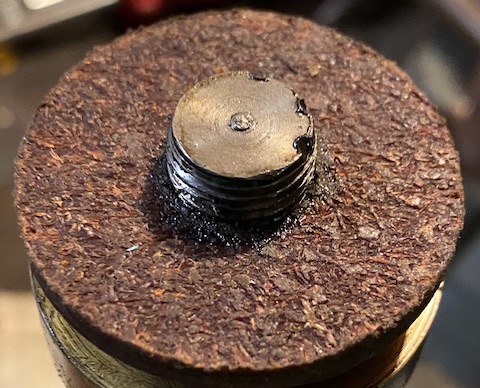

Ok, here's what I have now.

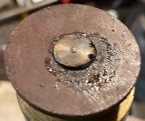

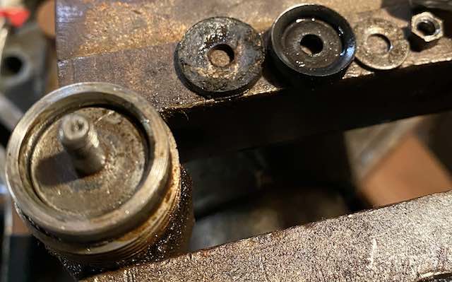

First, here's the plunger. No o-ring, but note the plunger wiper 38 that sits on it had a indent for what could have been an o-ring at some point, and the small o-ring from the kit would fit there.
Here's the pump plunger when I took the spring and cap off. It has a groove for what could be an o-ring near the top, and it looks like a corroded something or other was there? I don't see anything matching this on the parts sheet.
Here's the pump apart. Parts go back on starting left to right. No o-ring in there as in the document, but the o-ring in the kit would also fit here.

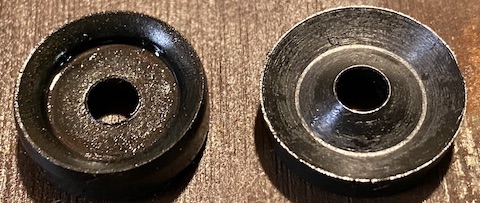

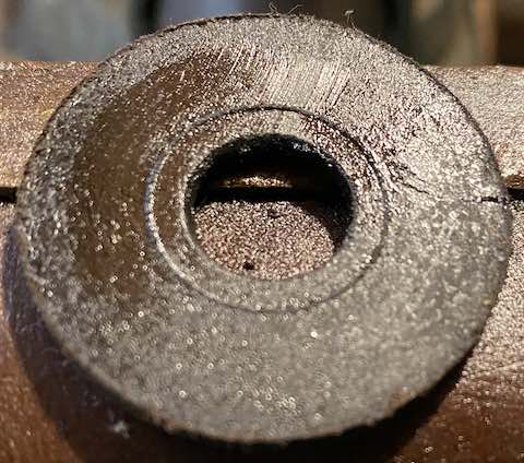

Two other oddities with the replacement parts in the kit:
The original plunger cup 5 is flat inside but the replacement has a cone. Maybe the original was just really flattened over time?
The original plunger wiper 38 is flat on both sides, whereas the replacement is flat on one side and rough on the other. Not sure which side goes down or why it's different.

You've got a little more disassembly to do; remove the brass thing 37 (heel plate) from the end of the ram, remove the pump piston from it's cylinder.
Not sure what your "corroded" thing is, possibly the underside of 10, the cap, got rusty.
Regarding 38, the wiper, looks like the original was smooth side down.
Plunger cup 5 is normal, mine are "coned" in the middle.
