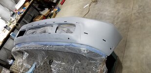

Now that I can finally get some projects up and down to my garage, I have started working on some long overdue projects.
Started with the Ex...time for some minor cleanup. The front bumper has had some corosion at the corners, I think it's from the batteries at some point in it's life maybe. Pulled the pumper off, sanded and painted and clear coat with sine 2K clear. Gotta wait a couple days to wet sand and buff. Hopefully turns out good as I have already started prepping one of the rear quarters for the same treatment adding in some spot blender.20220130_141237.jpg

Before paint
After paint

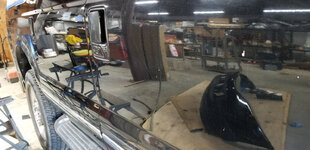

Polished door vs non polished. Now time to do the entire truck I guess. I'm gonna need a bigger buffer. LOL

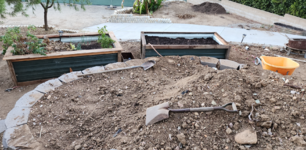

Continued to work on future garden stuff. Just about went through my pile of scrap wood and left over metal siding and got a second planter built. The only "new" items in the latest box are the screws. I was hoping that the planter box would require more of the dirt on that second tier but looks like I'll have plenty to build more planters or move that dirt somewhere else on the property. Shoveling dirt a scoop at a time really *****.
