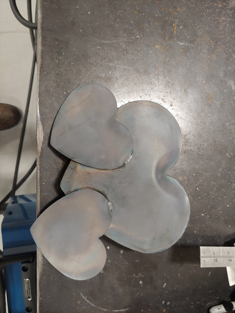

Whipped up something for the mrs fordkid. Made a couple of hearts in cad and burnt them out on the plasma table. You put dents in the larger hearts and fusion weld them together so the dents form a pocket. Right before its fully sealed you fill it with water and then finish the weld. Once its sealed you hits with a torch and let the water vaporize and expand and then your done.

matt_i
Mar 14, 2008
10,746
SE Michigan
Great stuff there! How do you not blow up the big heart when you heat it? Leave a pinhole somewhere?

I have to plasma out the bridges in my name and some tweaking on the ring shape and then i need a warmer night and a case of beer to test it.
