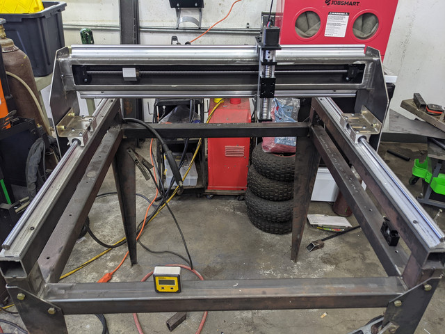

The last two weekends I've been working on the plasma table.
I'm still not fully happy with the gantry but it could be me over thinking things. I've been using a 3d printer to prototype parts or make the mounts for the z axis.

I've got it'll mocked up and shimmed so I can make the last few spacers. I'd be a little further along but when I went to crack the regulator on my argon bottle, I'd left it open and it had drained...luckily it was only a 1/3 full but still enough to piss off the pope.
Right now I've got 0.2 of a degree to track down between the gantry and the table but I think I've already found it but Im lacking the ambition to tear everything down and make the tweak.

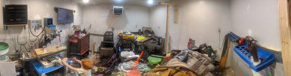

Well another cold Wisconsin winter is on its way and I had to do something so I could work out in the garage without burning hundreds of lbs of lp each winter. I also wanted to get my mill and little lathe out in the garage without them rusting and my wife could stop yelling at me for dragging chips through out the house no matter my efforts to sweep them up.
The solution was to partition of a small portion of the garage, say about 11 by 11 that I could run a heater and have a little fab space. I'm hoping I can have it 85%done by next week and functional.
According to auto cad and generous dimensioning of the equipment I'll have plenty of room for the equipment I want to throw in there.

Well I've got my mill and the rest of the equipment I want in the little space. I'll grab a couple of pics once it's been organized. I've still got to grab all of the tooling from the basement.

Got some time in on the table. Motors are hung and I'm working on the electrical. I threw an older gaming PC I built years ago, it's overkill but itx form factor so it doesn't take up a lot of room that is also couple with a 10in touch screen. My power supplies should be here Monday. The control board is supposed to be here the 5th, the seller fucked up a bit so I doubt that'll happen. I have a raspberry pi with a cnc hat that I may try to use in the mean time.
There is a ton of little stuff to do in the mean time but I just really want to see this thing move.
