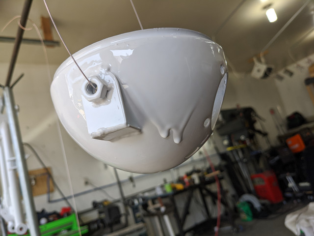

Messing with appliance Enamel. Mixed it with acetone and an Enamel hardener. Comes out pretty decent in fact I was impressed because I hate painting. The can says I can shoot a second coat tomorrow so I'll see if I can get to that tomorrow. I'm going to finish the welds on the frame and try and shoot that next week as this was just a test to see how it would come out.

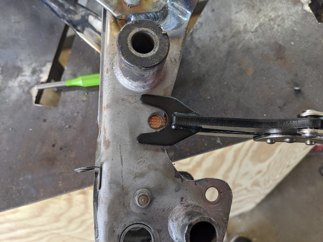

I used a finger sander to grind the weld off of the brake spring mount as it has to be relocated.
Then I finally had a chance to use this nifty little plug weld tool from Eastwood. The weld was so close to the edge I didnt want to blow out the edge.
Worked out pretty well.

I spent a couple hours reading on painting and this popped up a lot for motorcycle and vehicle chassis quite a bit. The only down side is the lack of uv protection. The parts that I did in white-the appliance Enamel are hard I can leave a mark on them. The black I can say the same. I think I'm gonna wet sand and spray the white one more time mainly for touch up and I'll let the black sit a week and do the same.

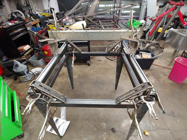

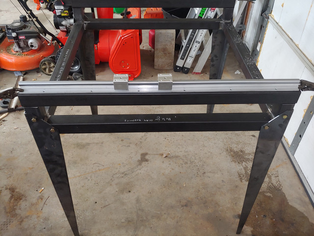

Well I had another ADD moment, I was cleaning the basement shop and I realized I was tired of my mill being on the big work bench and got to thinking that if I made a separate cabinet/stand for the mill about the foot print of the mill I could get rid of the shoddy work bench that came with the house when we bought and really make some space in my little basement shop. Plus it'll really help being able to get to the rear of the machine to aid in clean up.
So I've got the main frame partially welded and tacked up. I've got the over kill workbench casters on it rated at like 3300lbs a piece. They're pretty sweet as they have built in level feet.
The top plate is 1/4" so I could have a solid surface for the mill to mount to. This ended up being on headache partially on my part and in part to metal supermarket. My sight does not have a shear large enough to do 1/4" plate. I have access to one at work that can do 1/2", so I asked what is the widest flat bar that they carried which was 12" which was perfect. I could shear a plate and have one weld seam and we done, well in my rush to help my friend after work I quickly sheared it up with to the inside dimension....4" short. So I accepted partial defeat and weld on a section 4" plate. It'll never be seen as the chip tray will sit on it but I know I fucked up so that irritating.
I'm doing the math and planing for the side panels door and drawer at the moment. I'll form these up one after work but I'm going to take my time over a couple days as I don't want to screws these up.

Well I got some work done on the milling machine stand. I still have to get setup for the drawer and form that up, as well as probably paint. Before that I have to figure out the coolant setup.
