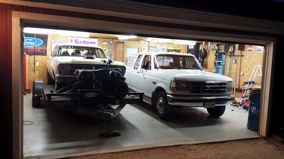

I dunno, I can squeeze quite a bit through my 16' wide door. Trailer is 9' wide, truck is F350 DRW
Huh... that makes 16' look plenty adequate...
Do you want a door you can squeeze in or one you can easily drive in??? The angle of that shot makes it look like the truck could not drive straight out from where it's parked?
For singles I did 10' on mine. I have many customers that like that as well and more and more are going with 20' wide. We are truck and SUV country here. Most everything is 8' or higher. Starter homes are the only ones getting 16'x7' with most parking out side after.
