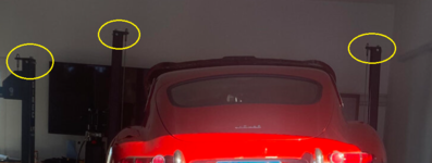

Glad you got it down. The problem is fundamental to that style lift. It is what it is, 4 independent legs sliding through moment connections in a flexible platform. Nothing anybody says will change what it actually is.
It is really 100% necessary not to lower it without carefully watching to see all 4 locks remain released the entire time. Bolting it down will simply damage it more in this situation, but it does contribute to rigidity, which is good, when it’s up and you’re not having an emergency. If I had that lift I would bolt it down, but I will warn you that it won’t help if you do this again, and it’ll still be up to you to watch it.
or, plan B:
1. Hire an engineer
2. Carefully deconstruct the entire garage
3. …..
I am relieved that nobody blamed the manufacture yet, I will say that.
There are two possible causes for this issue. One is a single corner lock not disengaging, and yes, in that case, bolting it down would not make a huge difference.
The more likely cause is one corner out of parallel with the others. Bolted down after being properly plumbed with shims, this won't happen. Sitting on the floor, the slightest flex in the lift can easily cause this. With a corner out of plumb, the slider can easily get bound up, and well, the results are above.
I disagree. This wasn’t a slider itself getting hung up. That would have taken an inordinate amount of floor being out of plumb, not something minor, and having unpinned legs actually would be self correcting, based on my observation of how a four lift reacts upon initial assembly or after moving it to a new location. The legs can be wildly out of plumb in those conditions, but the first cycle or two will cause the legs to self center. Pinning the legs to the floor, on the other hand, without cycling the lift first, would lead to binding.
It was clearly one of the latching dogs failing to release in this case, based on how I have seen lifts react to this situation. It can happen with two or four post lifts.

I disagree. This wasn’t a slider itself getting hung up. That would have taken an inordinate amount of floor being out of plumb, not something minor, and having unpinned legs actually would be self correcting, based on my observation of how a four lift reacts upon initial assembly or after moving it to a new location...
Tell that to my neighbor ho had his Cobra stuck in the air for this reason.

I had a similar problem with my 2 - Poster. One of my hydraulic cylinders blew a seal at the top position. Luckily it was going down on the locks when it blew! It was "safe" while in the resting position but, of course, it could not stay there. It had to come down ... hopefully, safely!
I won't go into what I did to address my situation but I will give a little advice. Whether you understand what caused your issue or whether you feel you are equipped to fix such issues NOW is the time to seek out the "PRO" assistance/advice that so many posters suggested.
When my lift failed I had no problem finding a "PRO" with lift experience. Ultimately, I found NO ONE willing to take the risk/liability if it didn't go right. There were a lot of professional "If it was me ...." answers but NO ONE willing to take the professional risk. While I fully understood their positions I still had a car in the air!! I eventually succeeded in safely lowering the car and cleaning the hydraulic fluid off of everything!!
With all of that: my advice is, even though your lift issue appears to be behind you, find several reliable "PROs" now so if it happens again you are ready. Hopefully it does not happen again but .......

On the "bolt it down" topic: if you want to retain the ability to move a 4-post around your shop but bolt it down while in use, these are what I recommend.
When you pull the bolts to move the lift, you're left with nothing protruding from the floor. When you bolt it down, these anchors provide plenty of strength/rigidity. I only use two bolts/anchors per column on my 9K 4-post.
I'll echo what others have said, when lowering, you absolutely have to hold the lock rod all the way open and focus on ensuring that all four corners are lowering. The only way something like this happens (to this extreme extent) is by inattention when lowering the lift.

and what is random about specifically tying the post tops together? it may not be the answer to fixing it, but it certainly is an answer to preventing it from happening that badly again. if one post starts to tilt out, the other two posts it is connected to will prevent it from catastrophically collapsing.
a close examination of the OPs lift pics clearly show that there are several bolt holes located around the perimeter of each column pad that were not utilized.
The circled holes are there to bolt down the lift if the owner decides portability isn’t important to him. The lift is sold as a portable unit, as are most other consumer oriented four post lifts.
Larger commercial lifts aren’t portable, nor do they all lift high enough to use as a parking lift.
In this case, yes, bolting the lift down may have stopped the ramps from tilting that much, but the subsequently overloaded column could have buckled and totally collapsed, too, causing even more carnage..
The failure mode here is entirely latches that failed to release, for one reason or another, and what you see is the collateral effect. Bolting wouldn’t have anything to do with the latches failing to release.
Look for root cause, not collateral damage.
Sort of like when a rod exits the side of a crankcase and windows it. The crankcase didn’t cause the failure, the rod broke because the piston seized in the bore, or the bearing failed on the crankshaft.
The hole in the block was collateral damage.
In this case, the column that is askew is collateral damage.

So much bad information in this thread.
Finn had it right "The failure mode here is entirely latches that failed to release, for one reason or another, and what you see is the collateral effect. Bolting wouldn’t have anything to do with the latches failing to release."
I've owned a 4 post lift for almost 25 years now. I've had this happen to me several times, but only the first time was as bad as this. After that incident you learn to pay attention when lowering. Going up is more likely when you can have a cable break, but coming down is when a latch can hang up. If you keep lowering without noticing this, you get what happened to the OP.
My lift is not bolted down and has no other "fixtures" attached. Just sits the way the manufacturer built it.

what does baby crib have to do with Murphy's law? The lift broke and almost took a car with it. The consensus was that the latch was bad. Personally I don't accept the notion that all we can have is crappy lifts that are supposed to break and drop a car.
The lift didn't break! I have the same brand of lift, when I got mine with the purchase of my home the locks and cables were not properly adjusted by the previous owner. I did this and all other required adjustments and maintenance before ever lifting a car with it.
It's a good lift, and Direct Lifts are ALI certified while many hobbyist lifts aren't. Again, this was operator error, not lift failure.
ace10
Dec 17, 2017
1,490
Rural NoVA
Easy, we weren't there, and everyone is speculating. If you sit down in a chair and the back legs fall out from under you, someone may speculate you were leaning back. Someone else may speculate that the chair wasn't glued right or a leg broken. Someone else may speculate that you were too heavy. Product liability cases determine who is at fault. Know why Nishiki stopped selling nice bicycles in the US many years ago. Some kid hit a parked car at night cause he had no light on the bike and there were no warning labels that he needed a light at night. The bike store and Nishiki lost the case. It is stupid but Murphy has a funny way of presenting himself. whether right or wrong, he is always present.
Are you maintaining that there is something actually broken on the lift?
If so, what visual evidence or statements from the OP support that position.
FredWanaker
Mar 27, 2021
1,470
NorCal
no - I am maintaining that there is a lot of speculating going on as to the cause. I haven't seen anyone who is qualified to adjust that lift offer to go over and check it out.
05snopro440
Dec 7, 2020
217
Sherwood Park, Alberta
Junk 4 Post Lift = Bolt it Down.
Cant Post Here When You Are DEAD
Direct Lift brand lifts are ALI certified, many of the hobby "junk" lifts that you're referring to are not. Also, Direct Lifts are made by Rotary, one of the top manufacturers of commercial automotive lifts. So no, it's not a "junk" lift, that's a bit of a jump to conclusions.
I'm curious why you capitalized the first letter of every word, but it kind of matches the uninformed opinion in the post.
racecougar
Jan 26, 2021
5,078
Missouri
yes, but if you are only using it for a large vehicle. let's use some common sense here, the suggested mod is not for everybody and won't work in all situations. for example, it wouldn't work on my old mid-60' Impalas as big as they are. but on a small MG or Sunbeam Tiger or Porsche?
So you're suggesting that the OP install a completely un-engineered beam between all four posts, and then remove as needed when using the lift to raise any vehicle larger than a little two-seater? "Common sense" would direct one to simply pay attention when raising and lowering the lift and leave the design as it was intended by the OEM. Or maybe that has become "uncommon sense".
Again, this is operator error, not a lift failure.
ludakris04
May 16, 2011
3,767
Maryland
I would just add "check all locks have released" and "lift is lowering flat" to your list of to-do when operating the lift.
When I was 19 I worked at a dealer, I had changed the oil on a crew cab long bed 3500 on a huge 4 post lift.
I was carelessly lowering it when multiple techs from across the shop started yelling at me.
The locks on the other side of the lift did not disengage. I was only lowering the side closest to me... it could have been real bad..
ybnormal
Jan 3, 2016
5,002
not even going to bother responding to this when I already said use "common sense"
