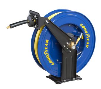

I bought the Goodyear reel from amazon about 3 years ago. It has worked flawlessly for me. I use it about 4 to 10 times a week.
GOODYEAR 46731 3/8-Inch by 50-Feet Retractable Air Hose Reel
It comes with 50" of Goodyear rubber hose. I like that because it doesn't get as stiff in the winter and wears forever.
They also have it with 50-feet of 1/2" hose
I have one of these, they are pretty nice. The hose is rubber and made in the USA. The reel has a two arm mount instead of a single sided mount like most cheap ones.
They cost $99 at Rural King, I bought mine during one of their 10% off sales
