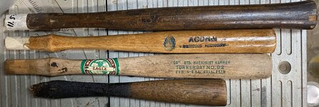

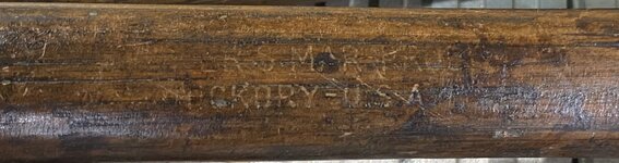

I picked up a small Vaughan-Bushnell ballpein last weekend
4oz
it joins a 11.5oz brother
Original handle cut down to 8”, but catalog specs 11”
I’ve got two unused 10” options, and a used 11.5” option.
I’ll probably go with the 10” Turnerday, but does anyone recognize the mystery on the 11.5” handle?IMG_3385.jpeg
“ERS MAR PROD HICKORY USA” is my best guess. Maybe “ERS MARTRUE HICKORY USA”?

Nice Vaughan-Bushnell ballpeins there. I like those little ones but two's a set!
The 1st thing that popped into my head on the handle mystery was "MAKER'S MARK" but that doesn't make much sense for a handle.
Those are some neat old handles. I hang on to them too. Sometimes they won't do the job they were made for but I'll still use them for chisels etc.
