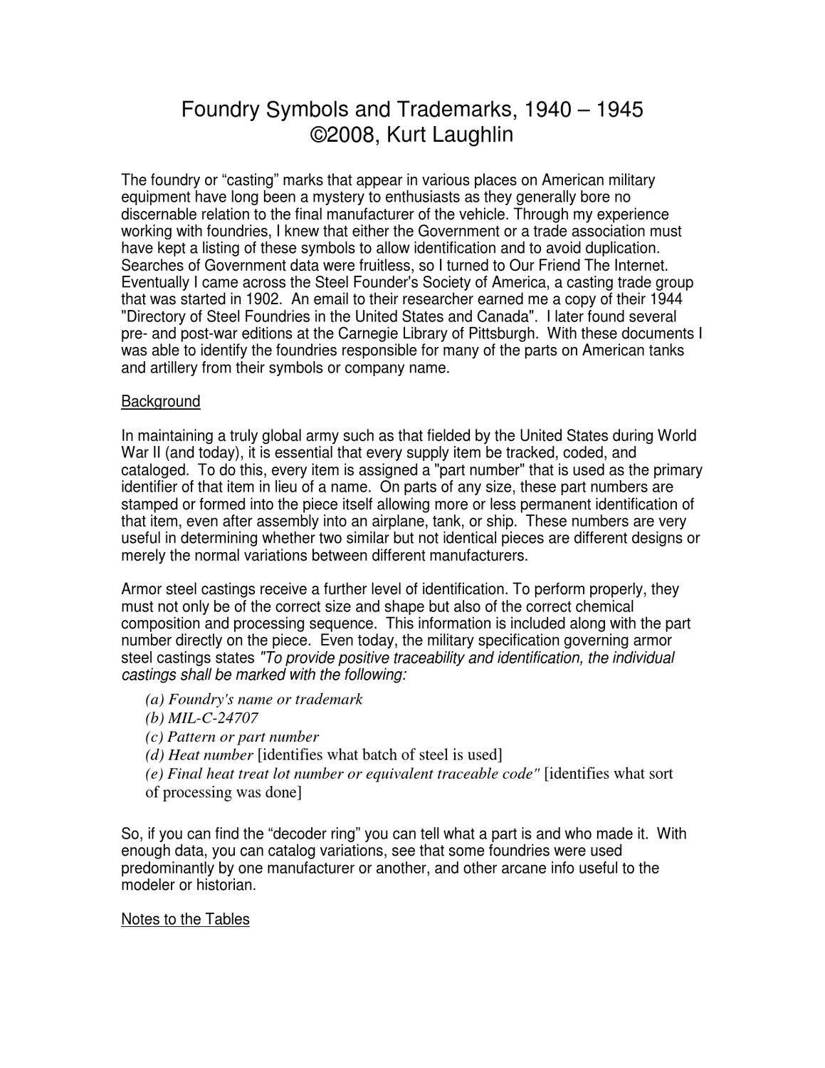

The only other C in a Diamond mark that I can find is a foundry mark for the National Malleable and Steel Castings Company, but the orientation of the C in the diamond does not match.

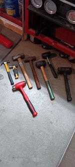

I use the soft dead-blow mallets the most around the shop. The middle-size (8oz?) ball peen would be next, followed by the 1 lb BP. The big sledges and single-jacks are for when thing start to go south--bigger hammer time.
